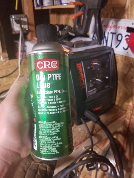

    A generic napa brand grease that I use for ball joins tie rods ect. I installed the uppers at 20k miles and re greased tonight at 25k. I released tension, cleaned, then greased, and then re torqued

    I had some funky noises during turning, I lube my balls with this. Good clean, couple of lube jobs and she shut up. I'm not a guru but worked for me.20170623_223642.jpg

    For the uniballs I just cleane them with warm water and then if they start squeaking I spray some dry teflon on them or wipe some wd40 on them if I can't find my teflon spray . They have been great so far only squeak after dirty driving and goes away as soon as I clean them

    WD40 is probably the worst thing you could use. But it's better than nothing. Kinda

    as someone that knows too much about uniballs now. i no longer use those spray dry lubes. i use this
    https://www.amazon.com/gp/aw/d/B000C17R7Q/
    and their cleaner or @jberry813 recommendation some simplegreen and water.
    i have about 10 different cans of spray dry lube now that i dont use. guess i have a lifetime supply of garage door lube
