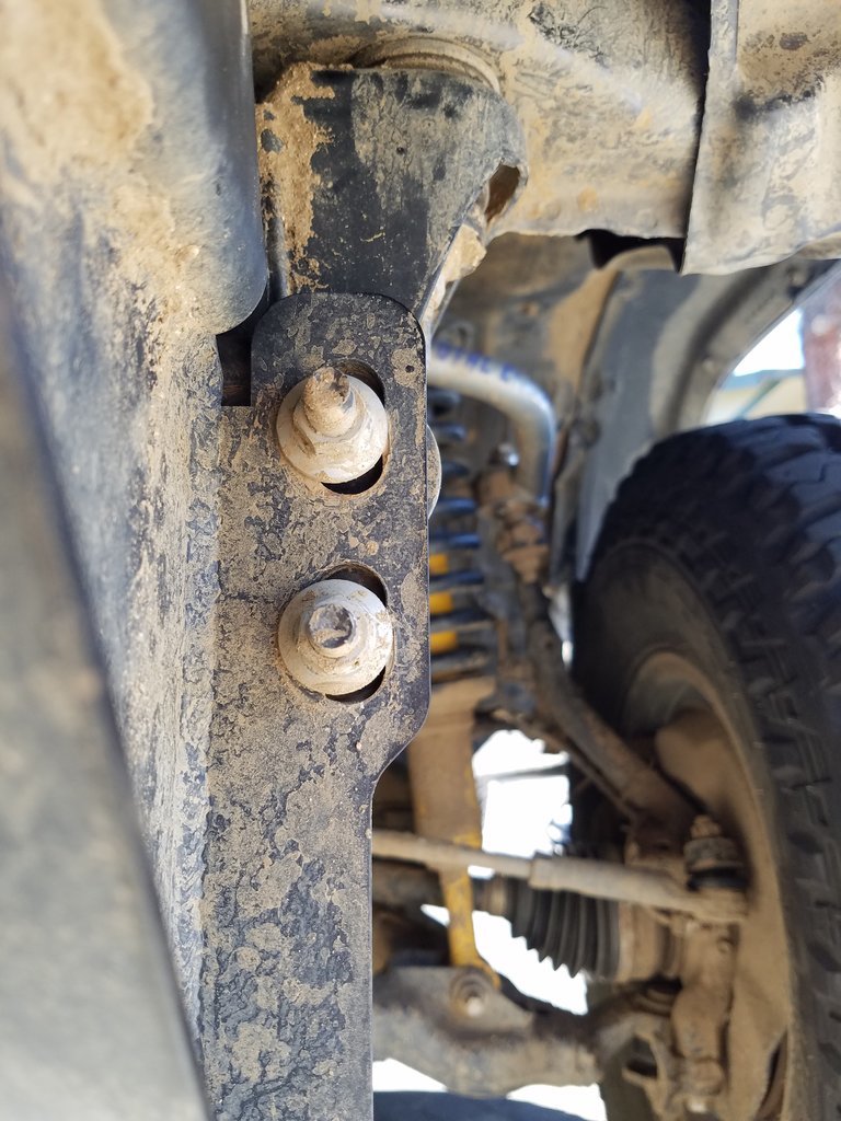

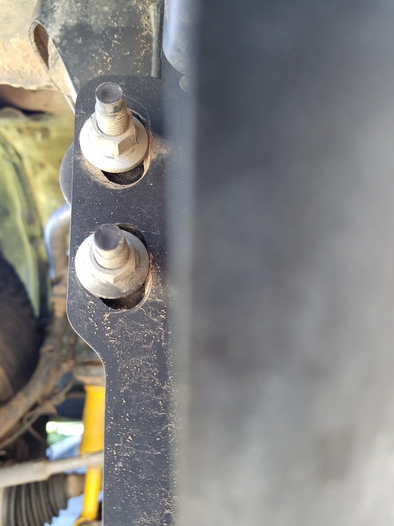

    This makes me a little uncomfortable, should I add a washer?

    i definitely would add a washer.

    Definitely. Grade 8 fender washers or slap a piece of 1/4" with holes drilled the right way.

    Need @RelentlessFab frame tie in plates.

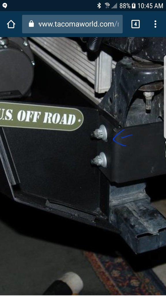

    They are slotted, but slotted horizontal instead of vertical. Trust me...those will do the trick as well!

    That picture was from my old setup. ^^What Jason said.

    You get that first hand or second hand? Should have had washers from Pelfreybilt

    First hand, is that true? Oh well Ill swing by HD
