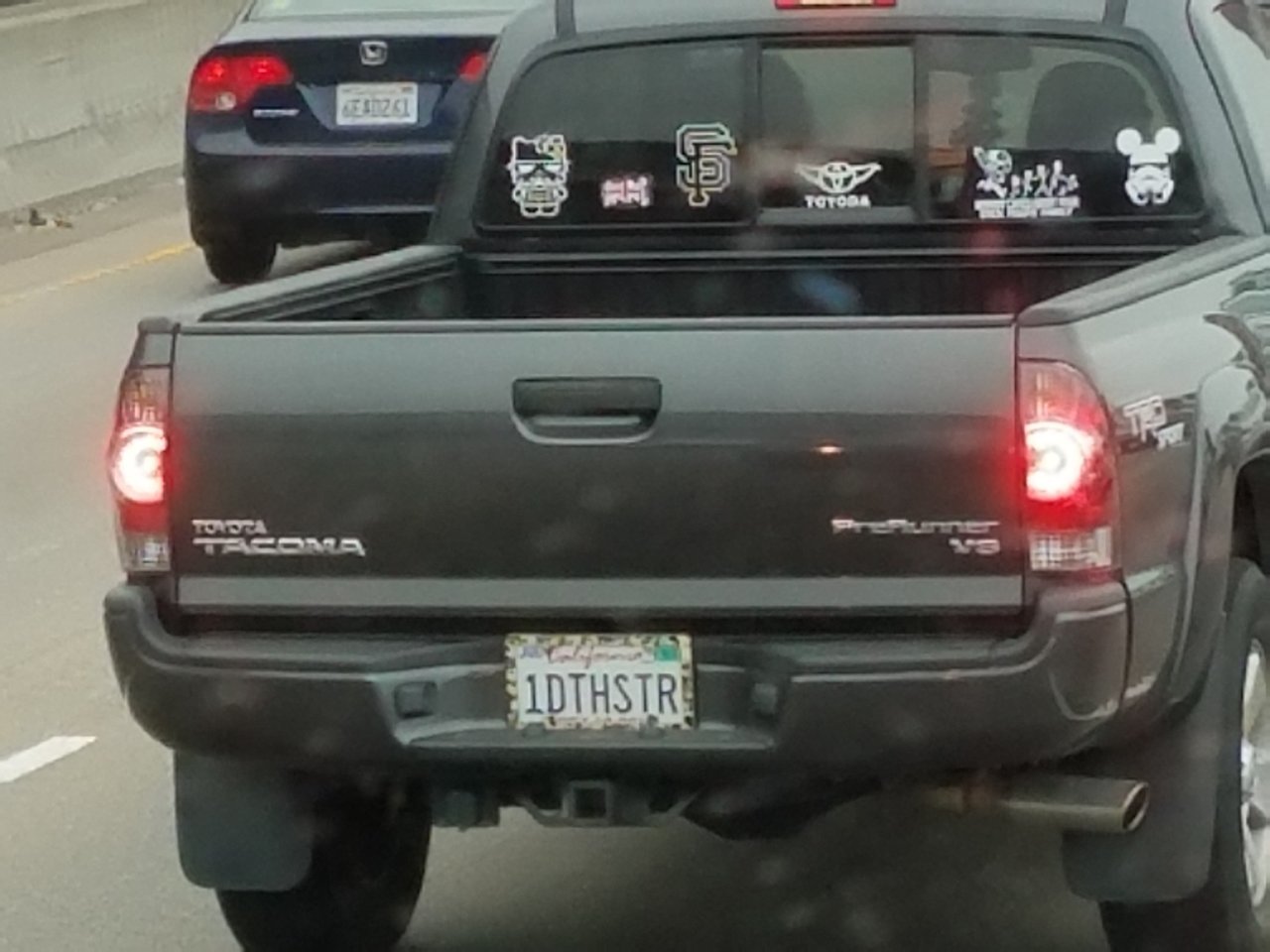

    1 Deathstar?. Guessing by that and the stickers, I'd say he likes starwars

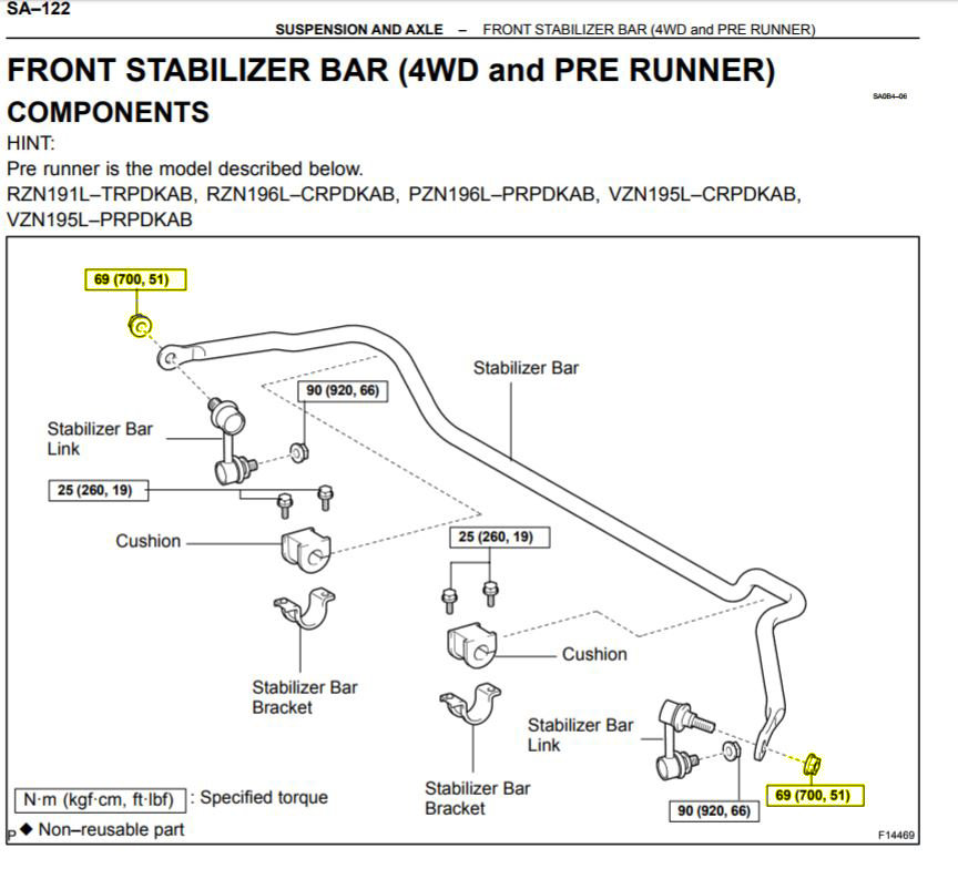

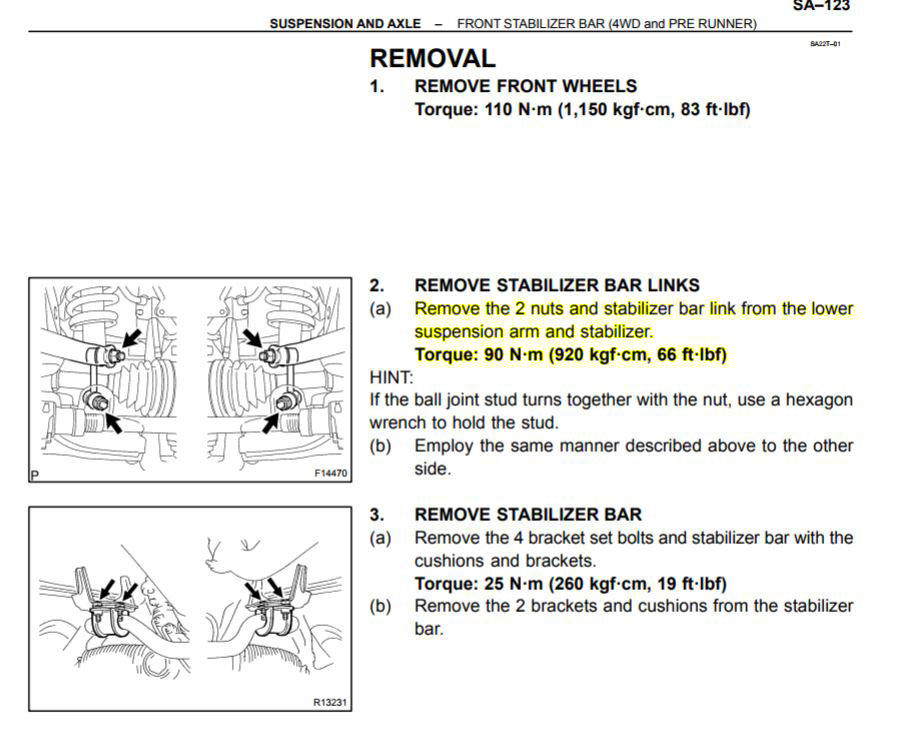

    first thing, no crap about the *cough* sway bar :rolleyes: , its staying on since my toddler is a passenger and the wife sometimes drives the truck.
    So I just finished swapping out the bushings and installing new links - mind you these are different than the 99-01 links. So the only reason why I am concerned is I am getting an occasional metal 'pop' or 'smack' sound (can't really describe it) from the passenger side ONLY when I go over a tall speed bump or the front end dips - cant figure out what it is but it started after I swapped in the new links and bushings. The bushings are 27mm and do fit so I know that isn't it. Only thing I can think of is the torque is off (?). When I looked it up - the FSM has different values and not sure which is correct.
    So should it be 51 or 66?? My next step will probably be to remove the damned links and see if I can reproduce the popping noise *driving me fcking nuts*. Maybe the passenger side link is screwed up - I just cant figure out what it is.

    Link to lca - 66ft lbs
    Link to sway bar -51 ft lbs

    Or.........German tight for both

    Good enough, thanks all. Now just to figure out wtf is that popping noise. Argh.

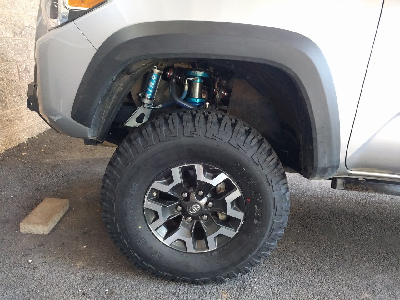

    Sweet, just got the Kings, TCs, AP expos and Bighorn 33s on today. :taco:
