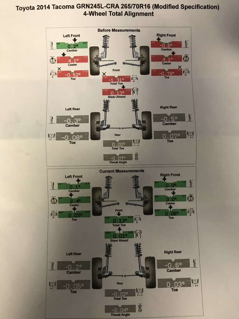

    Seriously, I have zero knowledge of alignment.
    After install of Kings I took it to a shop recommended by a co worker with a lifted GMC. Took in. They set it up. I gave no input, they asked me nothing. Gave me this diagram after completion, and away I went. Drives down the road straight. Are theses numbers good? I really don't know. Based on the 5 or 6 you're talking about I'd guess not.

    higher the better, not terrible caster numbers but looks like they could be at 4* like they were when you went in. Next alignment just tell them to max it out.

    they have LT so there numbers are much different. anything close to 3 has been good for me. but you do want a slight different from left to right like you have. LT is a different beast.

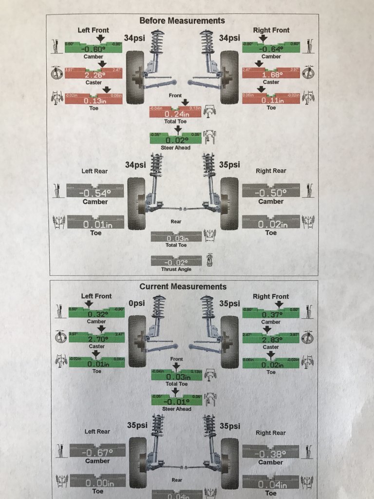

    My latest. Which I was fairly impressed with my at home alignment. After is as maxed as it can be, I went out and watched him do the alignment and checked the cams.
