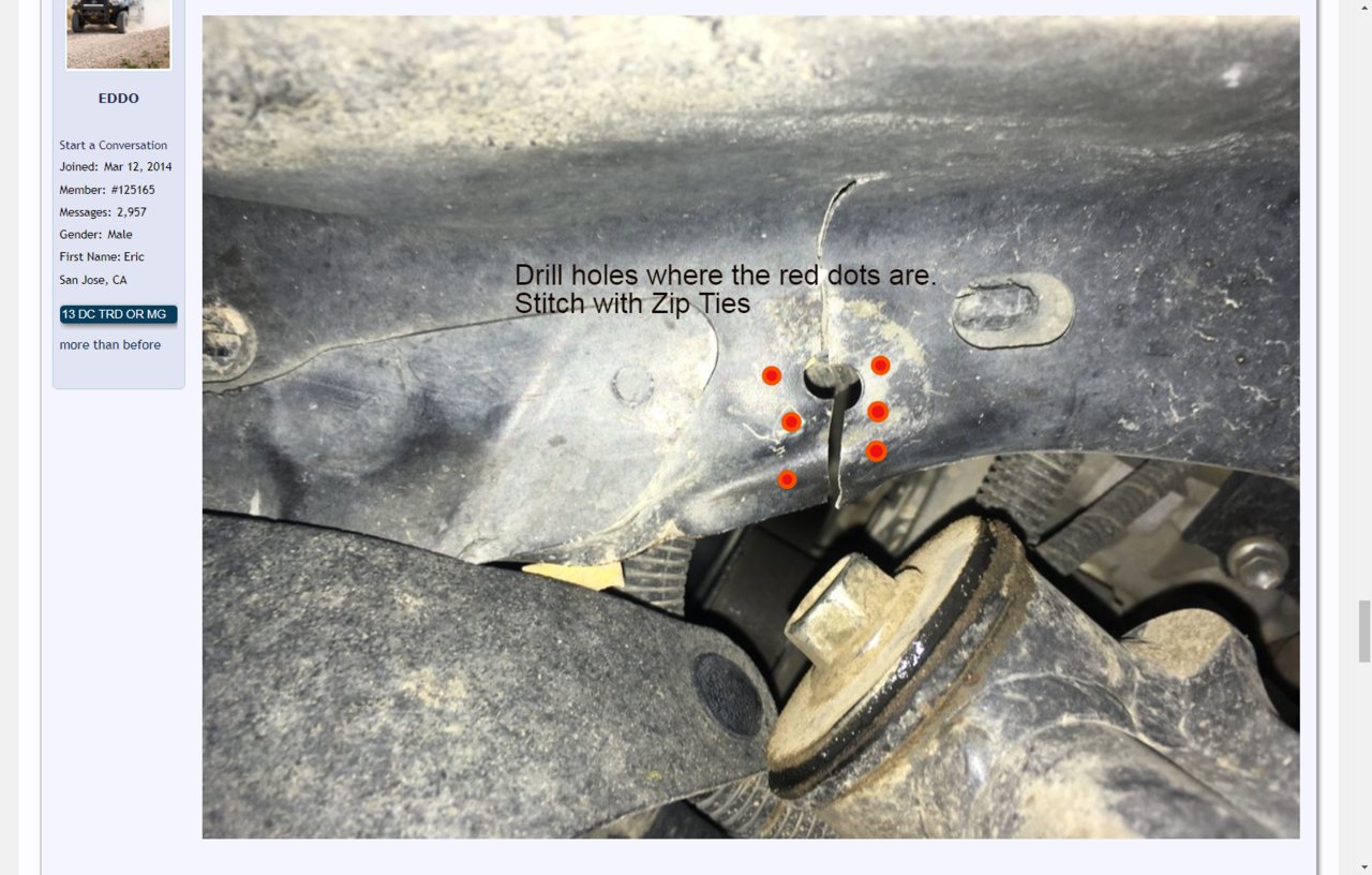

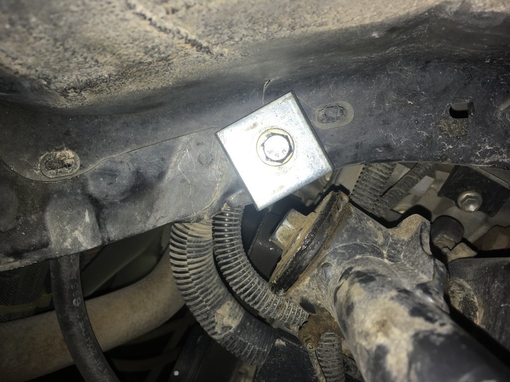

    My desperation temp fix is a sandwich of unistrut washers. Jacked up the inner fender until the hole was round and thru-bolted. Held for the drive to work this morning.
    Kinda matches my camp fix for the upper radiator support. Both sides on that.

    @EDDO do you have stock body mount bushings?

    Front two are poly, the other 4 are original. :anonymous:
