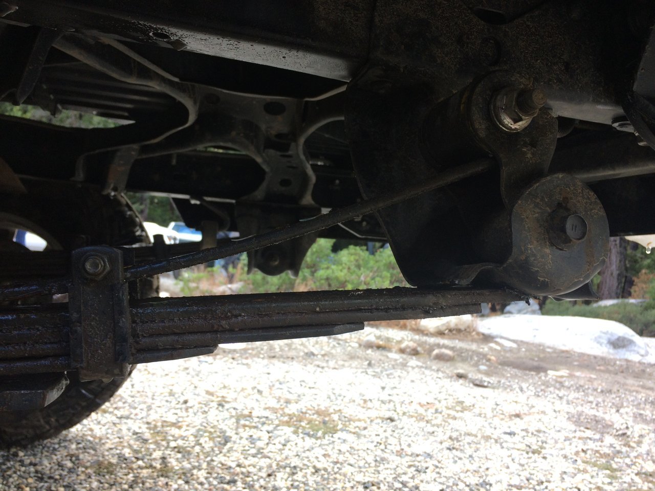

    Any of you ever have this happen? Happened on the way up signal peak today. Fun to get it back right on the trail.

  6. Nov 5, 2017 at 5:20 PM

    Did you get it fixed?

    Yea used a tire spoon to pry, my high lift to droop the suspension, and an axe to hammer it back in place lol

    Would like to note with a shackle flip this would have not happened so I found a pro to shackle flips

    Nope never that happen. But i did have my second from the bottom leaf hang up on my shackle a few weeks back at Hollister cuz my hanger is bent. Bound up the shackle Loud ass pop but couldn’t tell where it came from on the trail. got home and saw the raw metal rub on the shackle.

    At first I thought that was a broken main leaf curled up...
    I’ve broken a main leaf. Which sucks.
