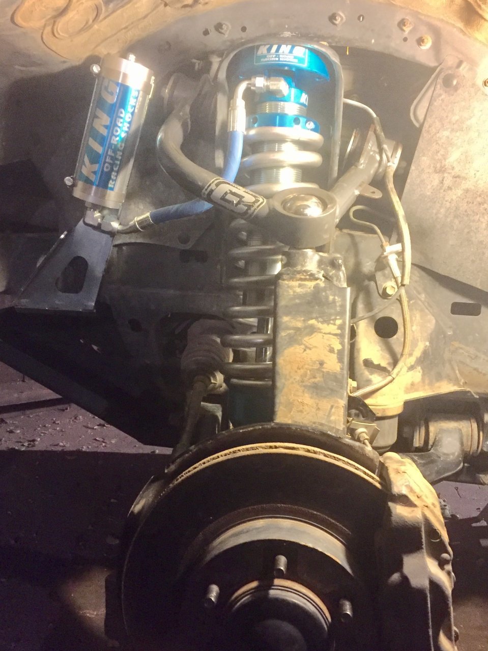

    My resi brackets are cut to accommodate the Relentless bumper reinforcement brackets. You can kinda see it here:
    ** EDIT - @916TacoTruck cut them for me at one of my mod days :D

    Crap. I've been fixated on the resi bracket being on the outside. This looks like a better fix. Thanks MJ. Also, whats the story on those rotors?

    Centric/Stoptech Rotors

    Did you replace the calipers, as well? Big Brake kit? Anything done with the rear brakes?

    Porterfield pads, but same calipers. Actually has been a big improvement over stock. Rears are still stock.

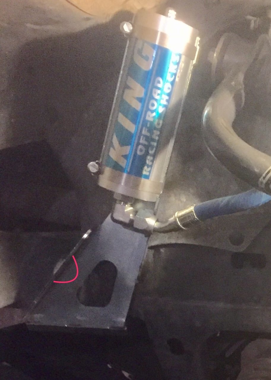

    I just put in the lower swaybar mount bolts and started cranking. The bracket bent around the bolt head. It was pushing midnight and I just got it done. Not how I usually do things, but it's solid. The only reason for me to cut the bracket is so everything fits nicely, since cutting the bracket will decrease the structural integrity. The reservoir isn't very heavy though, so I'm not really worried about it.
    That looks like a good option. My bumper brace sits flatter on the frame, so only the bolt head needs to clear. I'm hoping to keep some of the angled portion connected for rigidity. So I'd leave the reservoir mount on the outside of the bumper reinforcement bracket and just remove the shaded area on my shitty sketch below.
