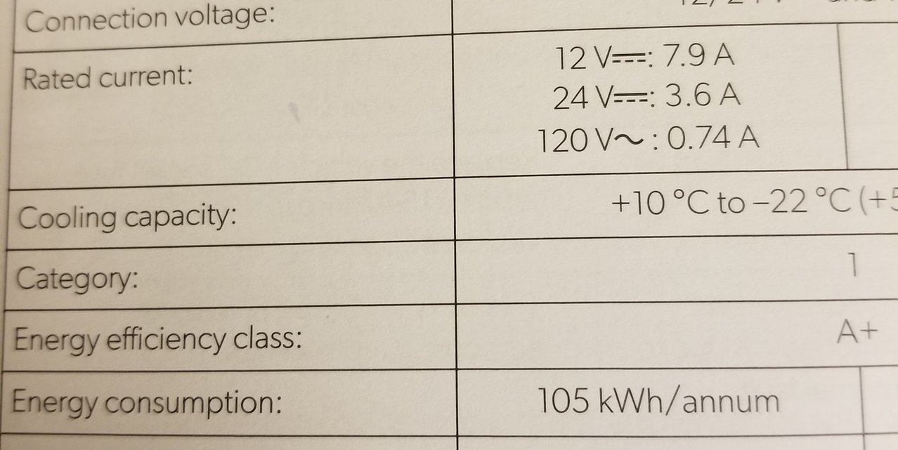

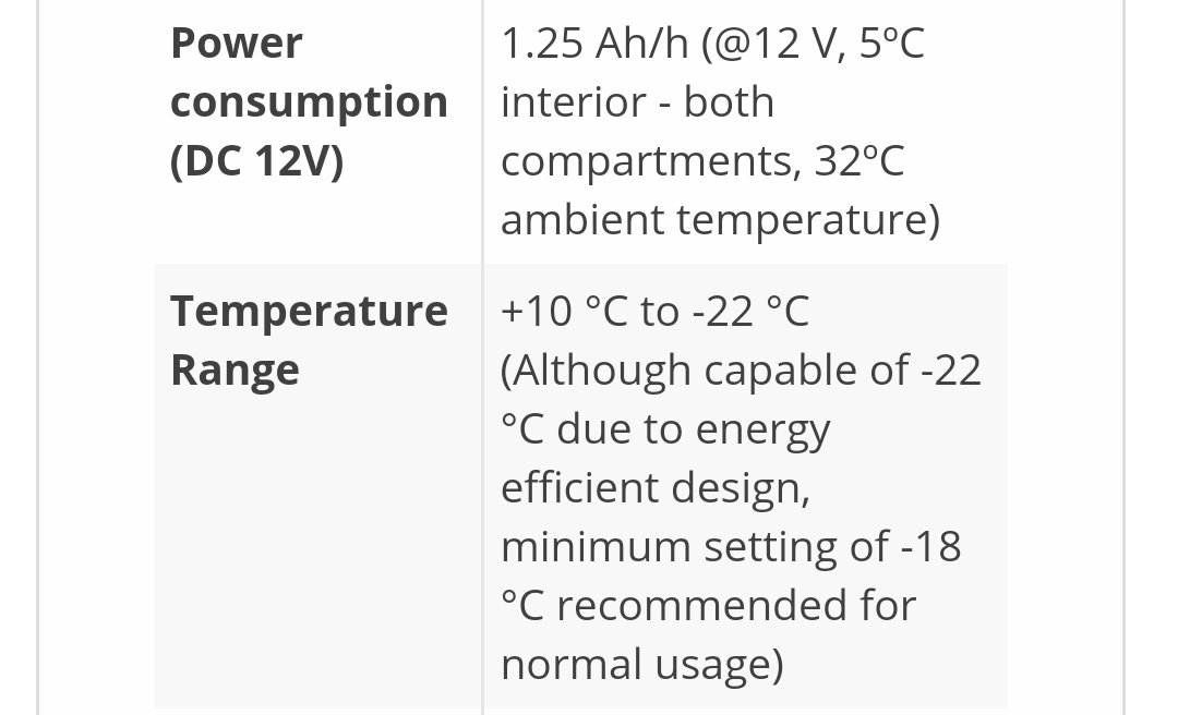

    Maybe someone on here can help me before I venture out, I've read and read but I can't seem to wrap my head around figuring this out. When trying to figure out a battery to buy to run my fridge , should I be using rated rated current in my calc? 105 KWH a year would be .28 a day, which I think is really low.

    This is from the website.
  15. Feb 16, 2018 at 9:26 PM

    https://www.batterystuff.com/kb/tools/calculator-sizing-a-battery-to-a-load.html

    Voltage x Current= Watts
    12 x 7.9= 94.8watts.

    Damn, looks like the fridge will only run for 4 hours on the battery I'm looking at. Should have gone for a smaller size. :eek:

    This 103ah rating is based on 20hrs for deep cycles. So 103/20hrs =~ 5.0 amps.
    You can run it for 12 hours at 103/12 =~ 8.0 amps.
    I bought a solar panel to cancel out the fridge current during the day so it’ll run overnight on battery with no issues.

    That's the battery I was looking at. Solar I guess is the way to go. I appreciate the help, this is all a foreign language to me!
