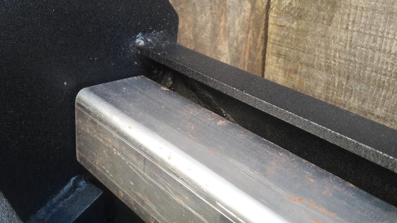

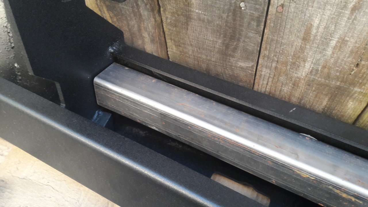

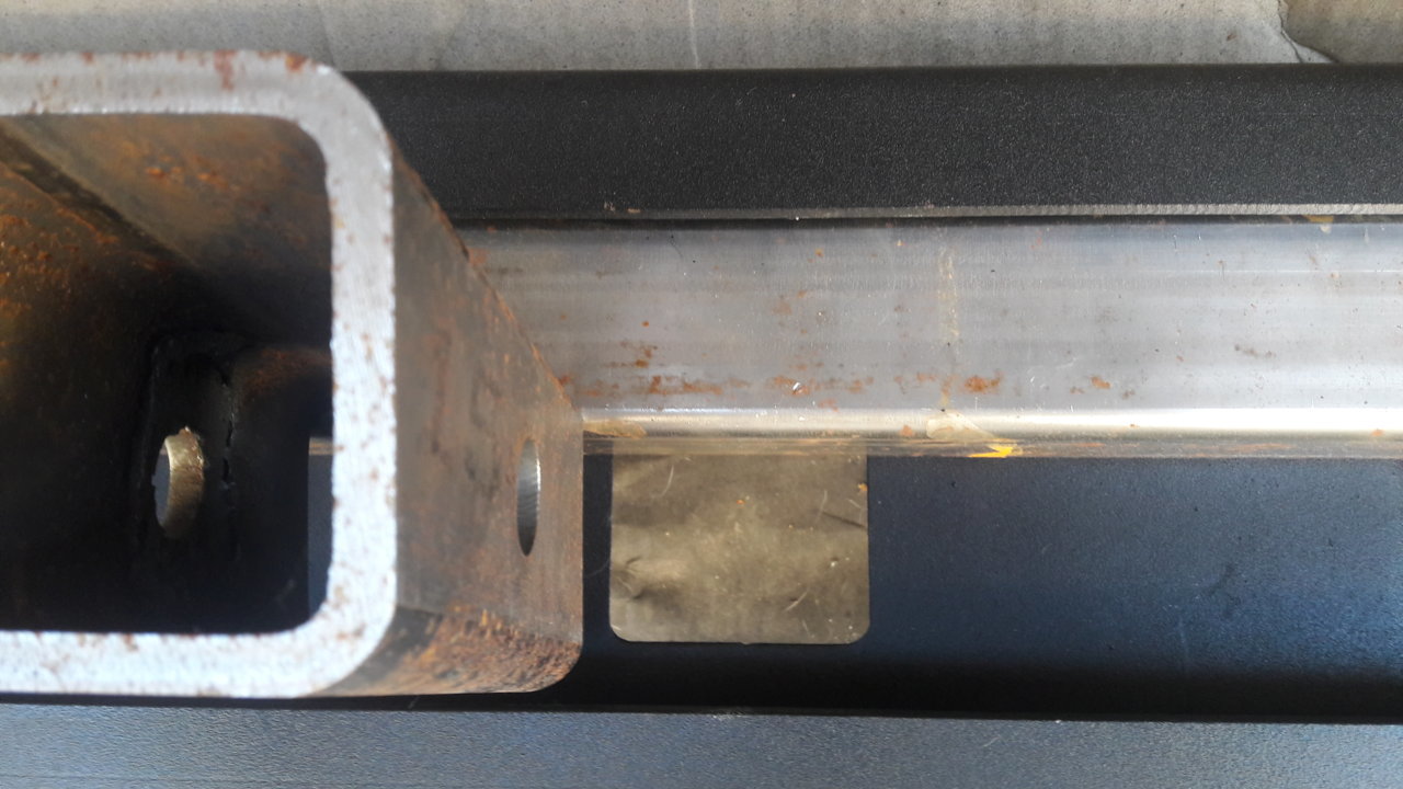

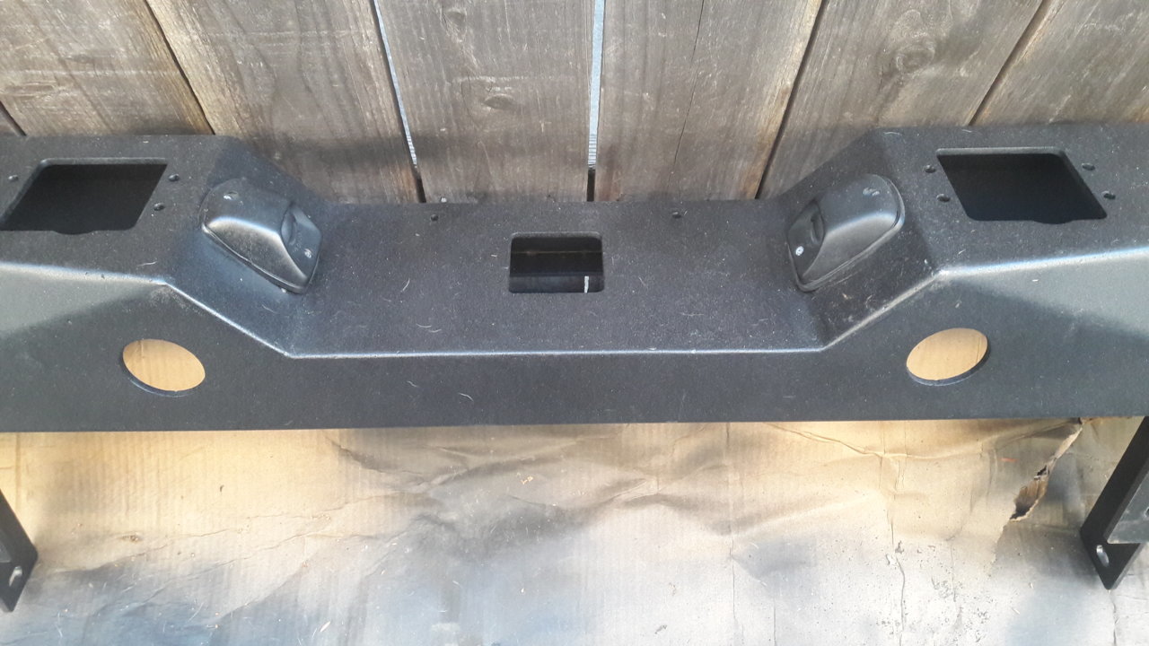

    That tube is supposed to be welded between the mounts and sit down behind that lower lip. The receiver is welded to the tube. Doesn't really work that way because the design doesn't allow the tube to sit flat inside the bottom of the bumper.

    I pm'd two months ago. No response. I can cut it. I just wanted to be sure I wasn't missing something.

    Tube needs to but up to the cross bar and flush to the face, you know that. Don't look like much room to weld in place, let alone put a pin in after installed.

    You can as long as there's room afterwards to put the pin in. And the hitch will still fit.
