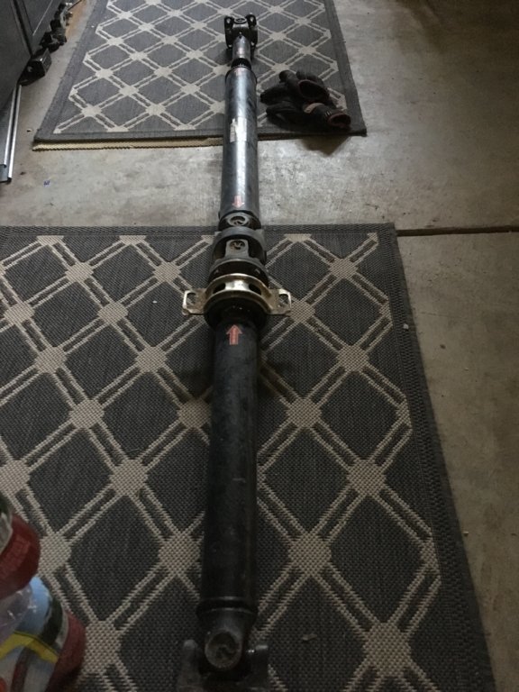

    Still chasing the driveline bump. Vastly improved since the spring swap, but the shop that built it wants to check it and add a dust boot to the slip.

    Have you ever had the yoke apart? And when the bulit it did they line all the U-joints up perfectly straight?
    Only reason I ask is because I built a set for my cruiser that were off only a slight bit. I only could tell if I straight edged it. I ended up with a bump also. That's when I learned they have to be perfectly in line.
    I also know that if the ball and cup are worn a slight bit it will bumb at the cv

    Not convinced that they properly lubed the slip at assembly. I previously pulled it and lubed it, made it a little better. But not perfect. So back it goes. The ujoints are lined up. Confidence is still high it’ll get squared away. Just been spending too much time under this truck with dirt falling on my face.

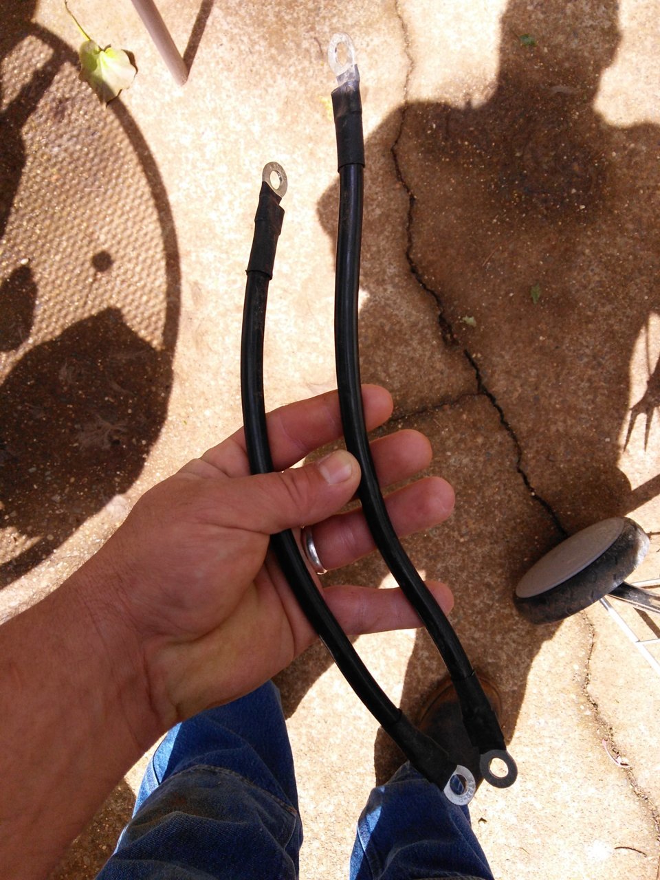

    I took my control box off my winch and mounted it to the top of my ARB bumper. the leads to it are four gauge and eyes on both ends. I replaced those with 24" ones then made new battery cables all the same time. Did mine that way so everything was new and bigger. I still have my old control box cables I don't mind getting rid of. Just offering these. I have more somewhere just can't find them yet.

    I'd take em. If I don't use em, I can give em back
    Thank you sir. That's what I need so I can connect my factory grounds back to the new terminals.
