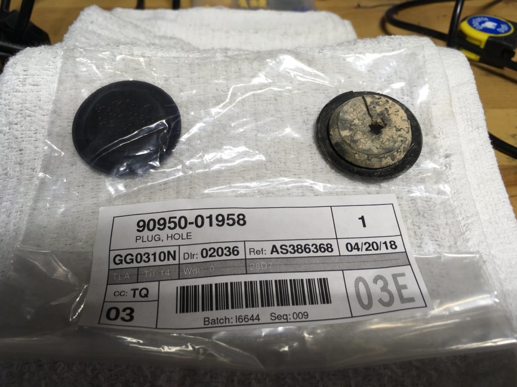

    For those looking for a part number for the ever-elusive and succinctly-named “plug, hole” in the floor:
    Yeah, didn’t think so.
