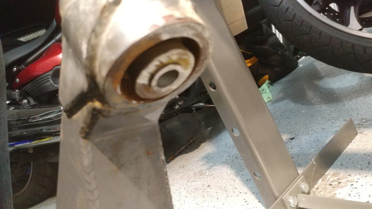

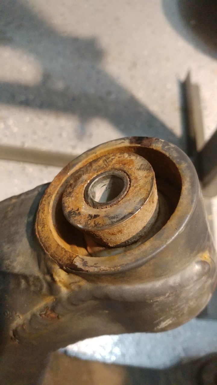

    Ok so, after multiple attempts I'm at a standstill. I cut out the LCA cam up front that was seized, now I'm stuck with the shaft for the bolt stuck in the uniball, it's got just a sliver poking out and I can hammer it a bunch of times to move either way but its good and stuck in there. I tried putting in my 12 ton press but the uniball just wanted to roll which could have caused some damage to me or something. I dunno how to get that MFer out now. I guess just find a bolt of the same size and start hammering?

    What type of penetrating oil have you tried yet?
    Try the ol atf trick.
    Edit - I still can’t load the pics. My new router is being a fickle bitch.

    I just threw some Kroil on it, hoping that helps. Seems like the metal might have expanded a bunch or something, It seems pretty wedged in there.
    whats the ol atf trick?

    Soak it in PB Blaster or some penetrating oil. Find something the same diameter or slightly smaller and beat her out. That would be my guess.

    It’s an old timer trick we would use in the engine rooms of big ships that move slow. Mix atf 50/50 with acetone. It works better than any other penetrating oil I’ve ever used.

    yeah I was soaking it in Kroil, just tried to put some flame on it, still nothing. Fuck man.

    No idea if it works for uniballs, but I used the bottle jack and torch method to pop out old oem bushings on my LCAs. Then I replaced them with poly bushings.

    Yeah problem is the Uniball starts to roll instead of pressing the shaft stuck in it out. I put it in my press and the uniball started rolling so I took pressure off it before it got violent.

    Can you heat up the whole thing and then spray some of that cold freeze or air in can on inside piece? Maybe that will change the shape enough?
    Also is the whole LCa steel? There is a trick with washing soda water and battery charger you can use to remove rust from stuff. Maybe you could get the rust that is binding the piece to come off. You need a sacrificial piece of steel and the charger is on anode and pull rust off your cathode or vice versa. You can make washing soda by dehydrating baking soda in oven. PM me if you can’t find it online but I’ve used it to clean rust off stuff and it works great.
