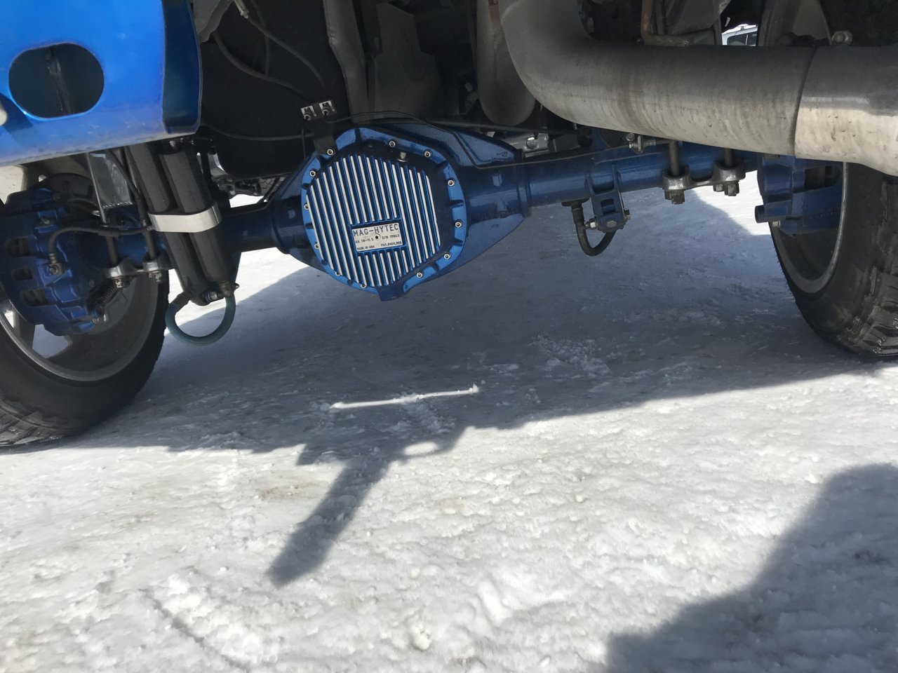

    Interesting way to mount resi’s
  5. Feb 11, 2019 at 1:43 PM
    LTDSC
    LTDSC 32oz of fun
    Apr 7, 2013
    #101544
    13,385
    Sam
    NorCal
    depending on vehicle, the upper mounts wont fit the eyelet with the body so close. I had to mount mine upside down on my Silverado. But i twisted the resi enough to not have the house hanging out like that.

    powdercoated axle, i highly doubt its seeing much trail time.

    With low profile tires what trail? #mallqueen.

    I ran over a brick on the freeway that ripped some plastics off my car, pretty sure that brick would sever his res lines.

    But it's color matched, dude! Gotta be worth at least 25 horses. But if it gets him hooked up I suppose it's worth more than butt dyno.
