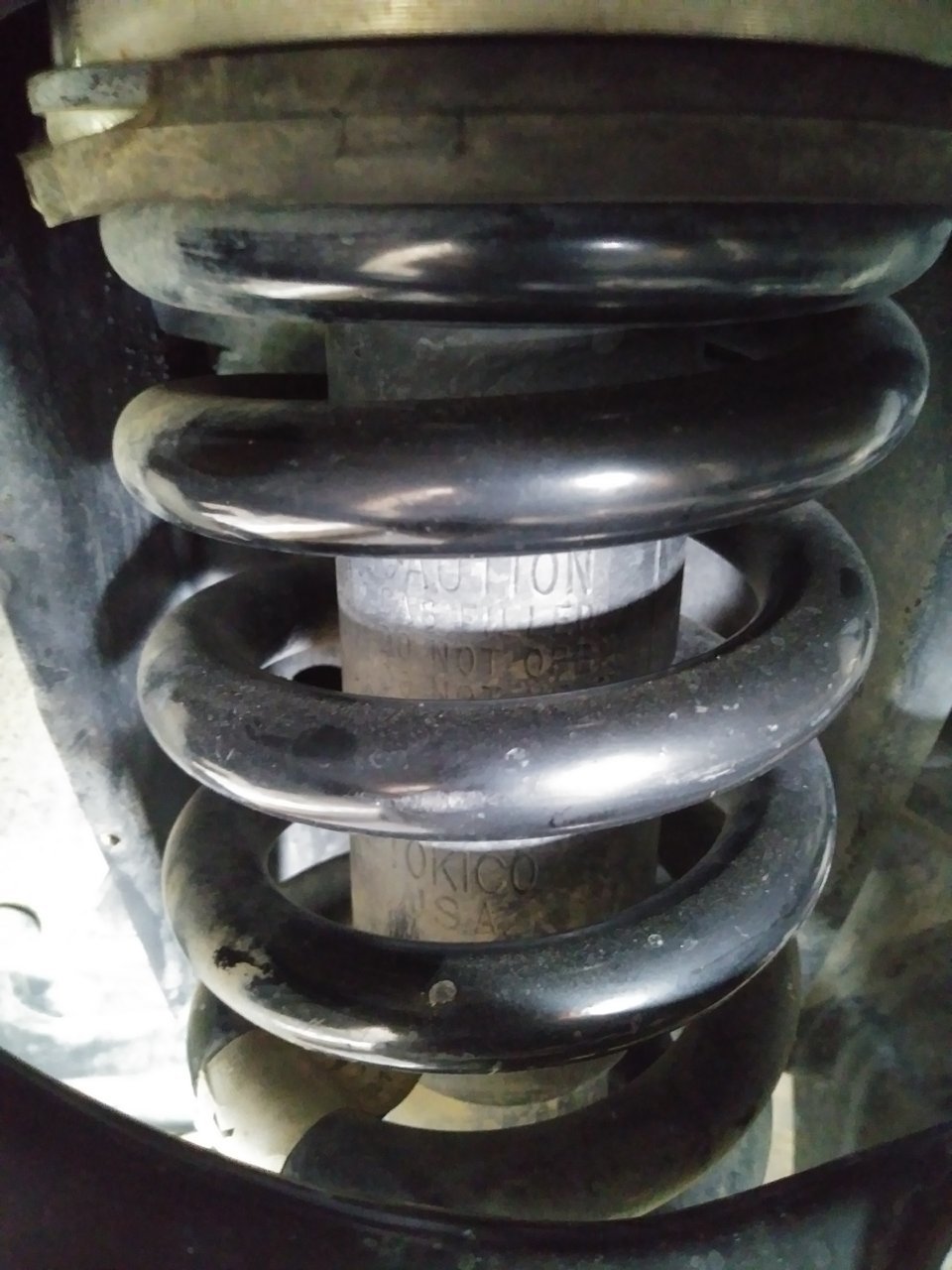

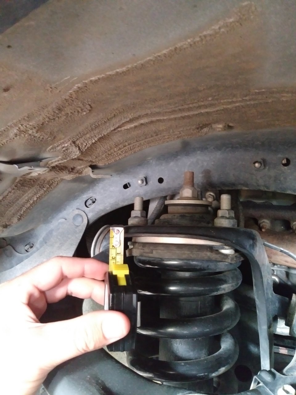

    what makes me nervous about all of this, is that comparing measurements it seems like ive got more than 1" of lift on my truck currently, even tho all i can see are 1/2" spacers up front (for the sake of conversation i will only be talking about the fronts)
    Hub to fender im at 22.5" ground to fender im at 37.25" (1/2 an inch ground to fender is due to my 265/75's) edit
    Lotta guys are saying they are at 20/20.5" stock.... now, i know were not using the most accurate methods of measurement here and that there has to be a margin of error. but god dammit i can read a tape, ive measured multiple times in the past 10 minutes just because im OCD like that (measure thrice cut once?)
    THIS is why ive left it alone for the past year and a half since i bought it. Opting to just do it right instead of trying to find a temporary solution.
    Now im second guessing this whole operation lol The struggle is real(ly in my head)

    yeah so, im on (what appears to be) stock SR5 suspension, with 1/2" spacers... and im sitting taller than you are. It makes no sense to me
    maybe i cant measure accurately enough, and theyre 3/4" spacers, but still, that shouldnt take me from 20" to 22.5". Even if i was off by 1/4" measuring it, the numbers just dont add up lol
    So unless the previous owner swapped for 3rd gen SR5 stuff (because it seems identical to the OEM SR5 suspension) and added the spacer. that would bring me up to 1.5ish inches of lift, which would make a little more sense. Its just odd and it kills me that i dont know. I knew not to buy a truck that was lifted by someone else, clearly i was in a daze and blinded by the rush of buying my first truck (finance that is) and skipped right over my own advice lol

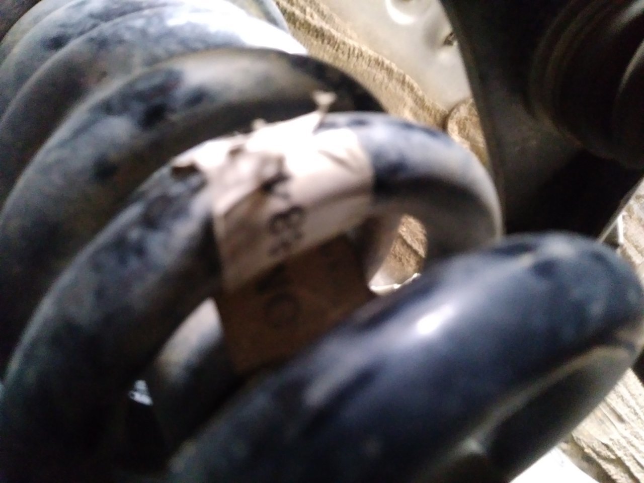

    EDIT! Ive made a discovery, i am an idiot. will update in a sec
    Im so dumb, i noticed this white sticker a looong time ago, but theyre in a hard to read place and i was too stupid to read them. Sticker reads OM(i cant actually see the E) 884x
    Well.... That makes a ton of fucking sense now. Havnt felt this dumb in a while.
