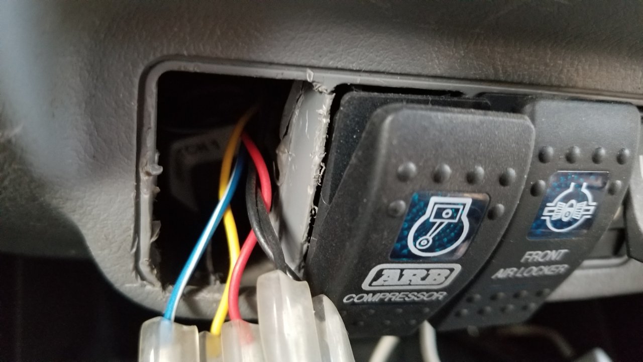

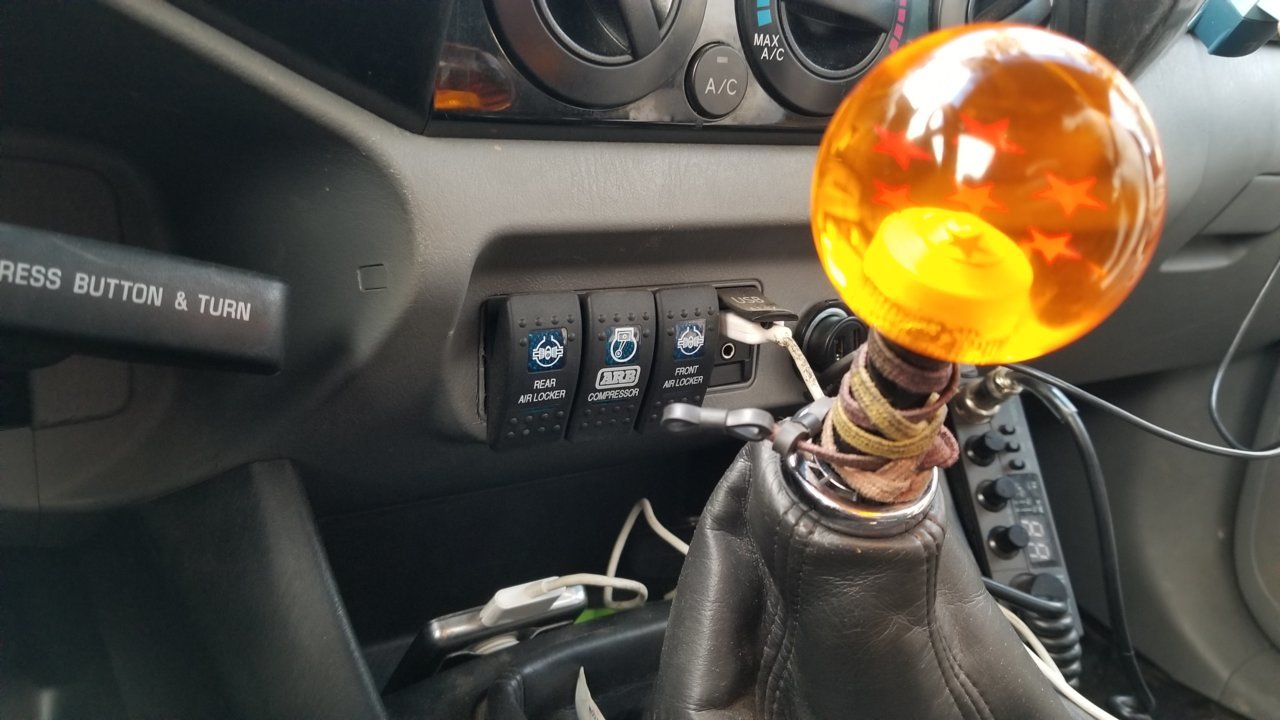

    Do your switches by chance dim with your dash rheostat? I know that our trucks have variable voltage on the negative circuit, so it's tricky. I was going to try a few things, but figured maybe someone here would chime in first.

    Mine did not. But I wired them straight from the battery and didn't bother with the dimming circuit.

    On the black HVAC connector, tap the solid green wire (+) and connect to the positive illumination wire from your switch.
    On the black HVAC connector, tap the green wire with white trace (-) and connect to the negative illumination wire from your switch.

    I followed the instructions for the dimming feature but it didn't work, I realized I didn't care enough about it to pull the wiring and try again.

    @bagleboy would know. He talked me through it before. I can try to dig up the thread if he doesn't chime in before.

    I tried before, but didn't source both wires. I'll be giving it another shot tomorrow with @EDDO's idea.

    Mine do. Followed the same steps eddo mentioned.
