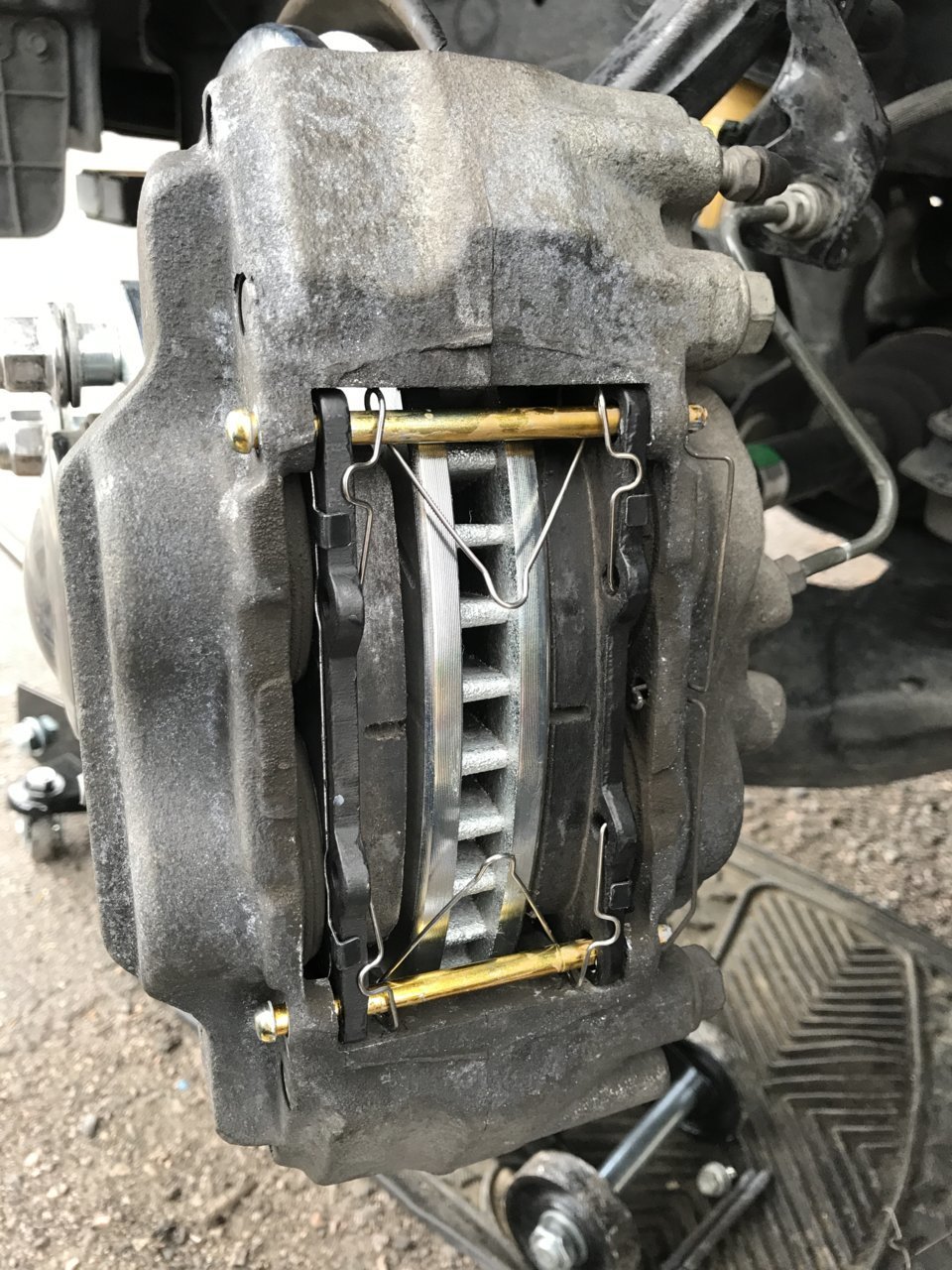

    Maybe try the double clip brake mod. It has solved the issue I believe you are describing for other TW members. Cant find a thread with a quick search but I am probably using the wrong search words. Here are some photos just add another brake caliper pin (only 1 stock).
    A3912E4A-116C-4E24-B437-8B3A5034B224.jpg E3FC4AA9-8D59-4050-AE4E-347F0B9BC40B.jpg

    I did the double spring mod and it fixed the clicking. Its called brake pad slap. As far as the transmission noise, is it a low pitched grinding kind of sound? My 6 speed only does that if I shift and then give it a bunch of gas under 1500 rpms. Anything over 1500 and no odd noises. Maybe post a video?
