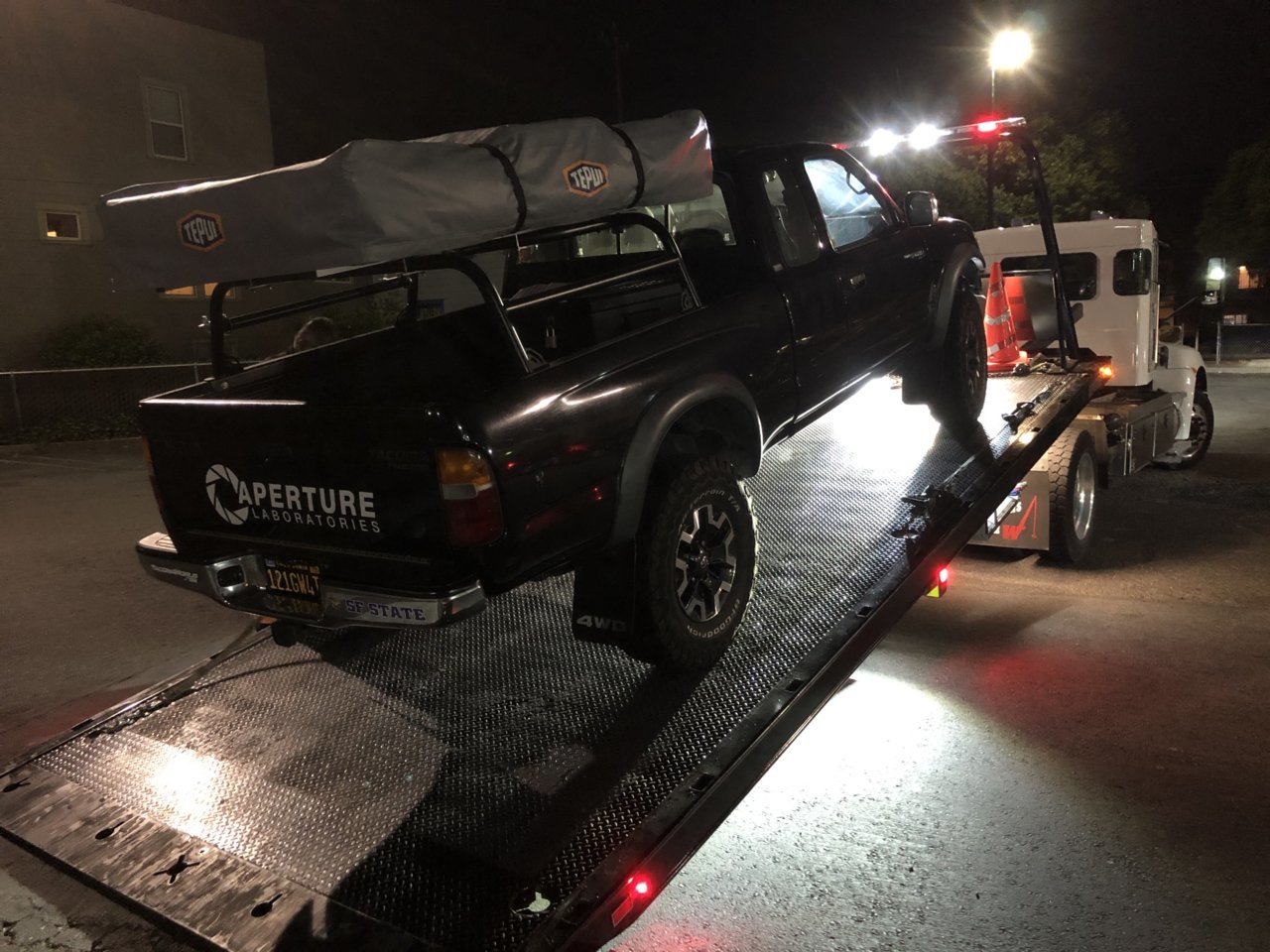

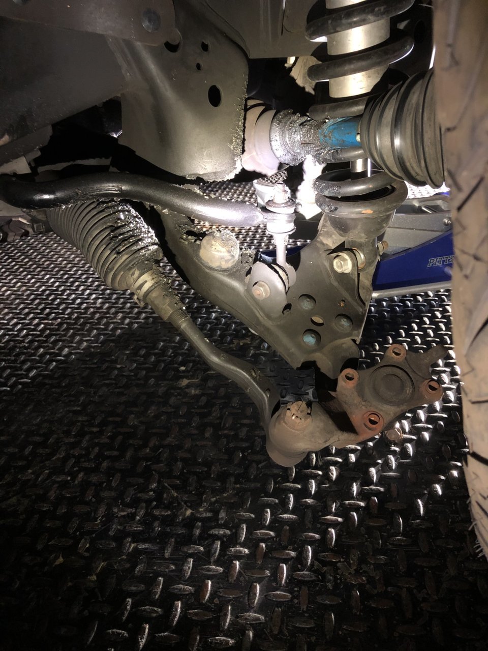

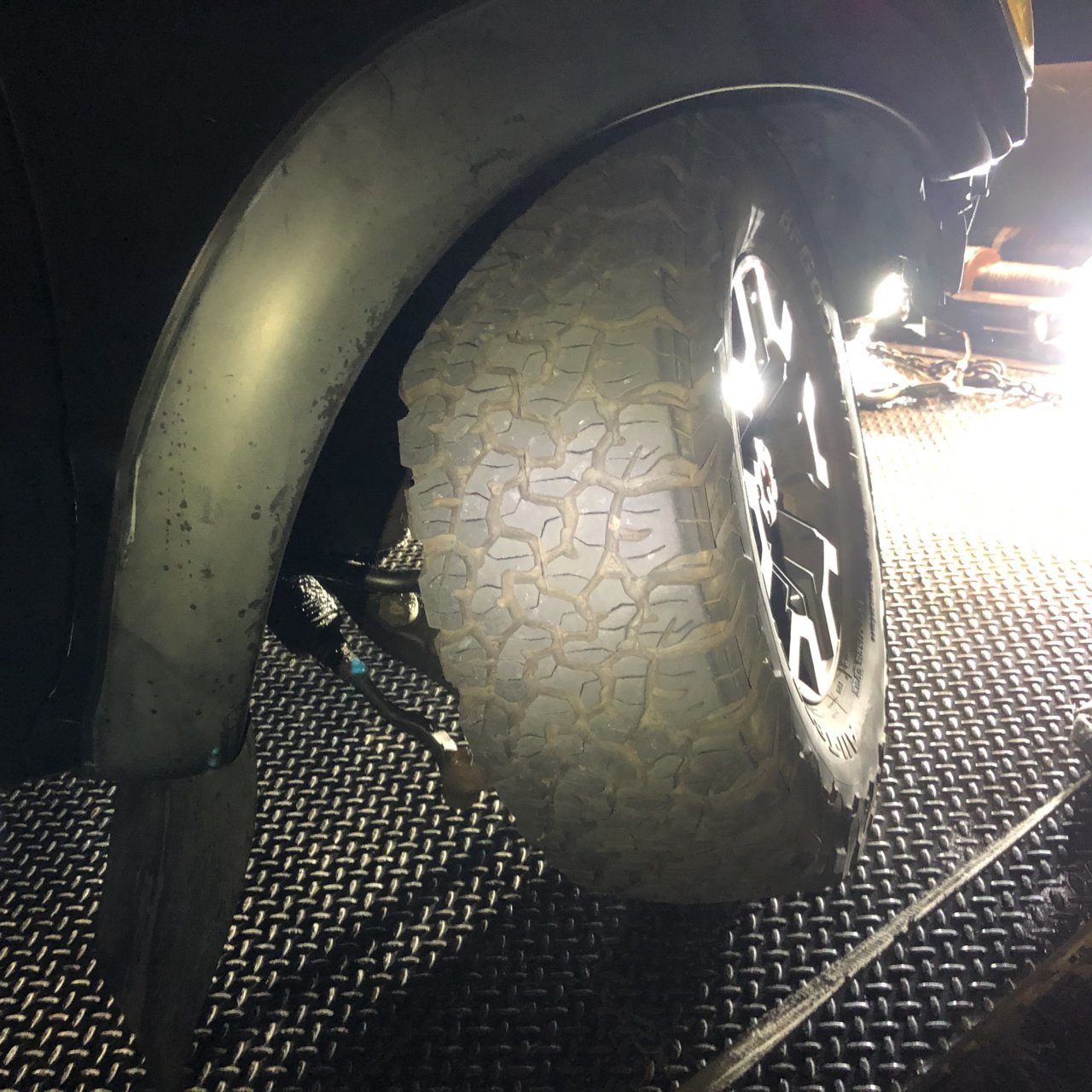

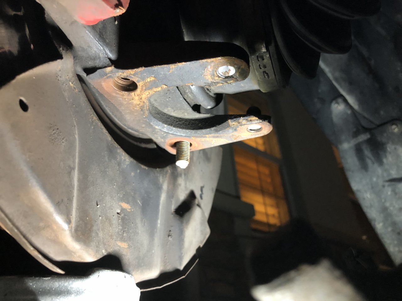

    Blew my lower ball joint bolts while I was doing groceries in downtown SF. Tow back to Hayward cost me about $400.

    Original LBJs? And bolts? Were they the flange bolts or the one with washers? How many miles?
    From the failures I've seen on 4Runner forums, it looks like you got out pretty okay (minus the tow bill).
    I know LBJs are a big problem on 3rd gen 4Runners but I didn't think so much so on 1st gen Tacomas (different P/Ns).
    I replace my LBJs every 100k miles and have done them on a few other 4Runners if you need a hand with them.

    They have about 115k on them. However, I removed them in December 2016 (~30k miles ago) to swap them to my new steering knuckles for my 4WD conversion. They’re the factory flange bolts.
    It was pointed out to me the bolts failed because I used Loctite. Loctite on bolts causes inaccurate torque readings apparently. The new factory bolts come with preapplied thread locker that won’t affect you.

    I never use loctite - some people do, some people don't. Did you use the same bolts as before or did you buy new bolts when you did the swap?

    Same bolts. Same ball joints.
