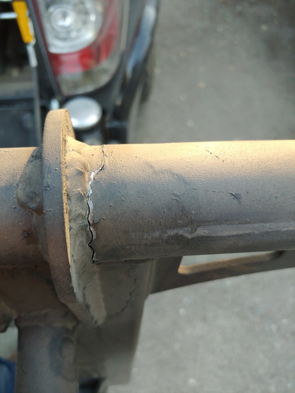

    Spotted this guy, nice truck but his tire carrier looked a little flimsy.....

    Maybe he should suck it up, with a gusset!

    Is that a single tube that goes all the way through? What size and thickness tube?

    Yeah, the reinforcement plates were added after the welds of the horizontal round tube to the vertical square tube broke a few weeks ago.
    Thickness; I have no idea.

    The bottom gusset is legit. But it looks like the crack started at the top at the weld. Which I would assume that maybe it got too hot. Normally wouldn’t matter unless it was too thin. Also you have a single sheer spindle. Those inherently are going to flex more. Add on the leverage and weight of the spare tire, I can see how it would oscillate.
    I would cut it all off and run a square tube to the spare tire carrier plate.

    Yes, the bottom gusset it what saved it from falling completely off both times.
    This is an early design of the swingout, and I know the current design is much better with even an adjustable mount for the carrier itself.
    To not clutter up with more pics, here are some of the original repair and some more of this recent break.
