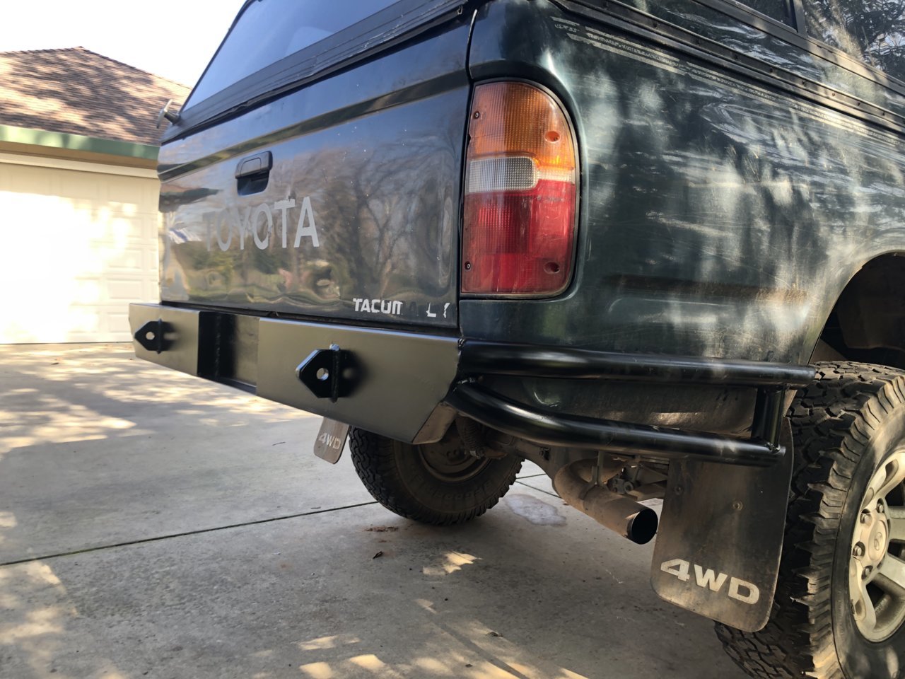

    Sweet looking bumper! Hope you find a buyer!

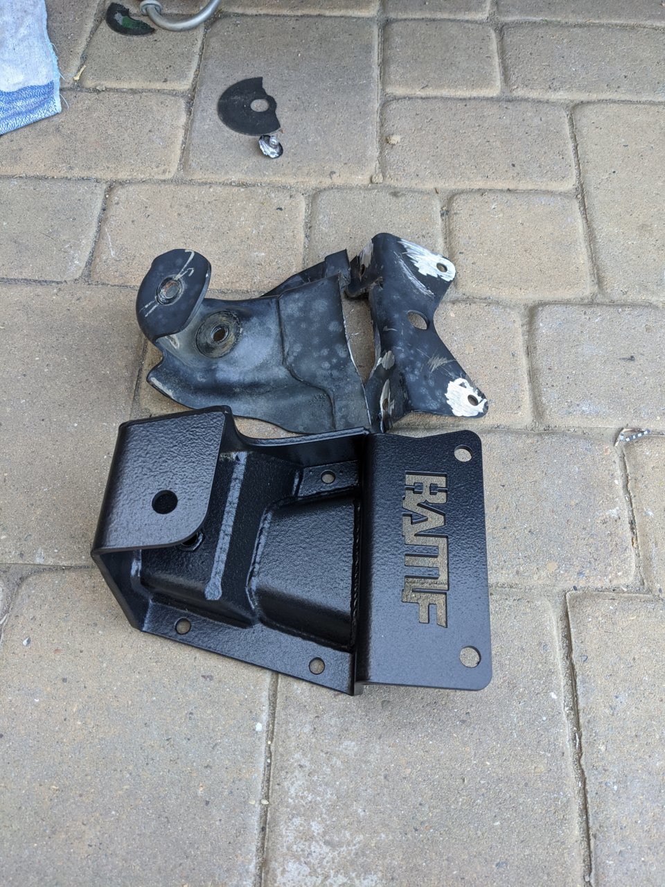

    Well, doing a thing or two today.
    Edit: oh and that broken grinder wheel got me good.

    I got my hangers this week. How long was the install?

    I'm still working on them. Between 3 kids and taking care of wife's work stuff and rain, I didn't get much done. I was able to take one of the hangers off and take out the rivets and make the holes in the frame bigger. I just need to install the leaf pack back in and I will be done with one side. Having extra set of hands to help with this project would definately make it quicker too.

    Fuck using that cutoff wheel to get those rivets. Grind them flat enough to get a drill on it. Drill a small hole and then move up a size to whatever you need the bolts to be). They come loose and then just knock em out with a hammer and punch.
    Done a few sets and found that process to be the easiest. Should have that other side done in about 30-45 minutes.
    Much less risk of getting impaled by flying cutoff disks too :notsure:
