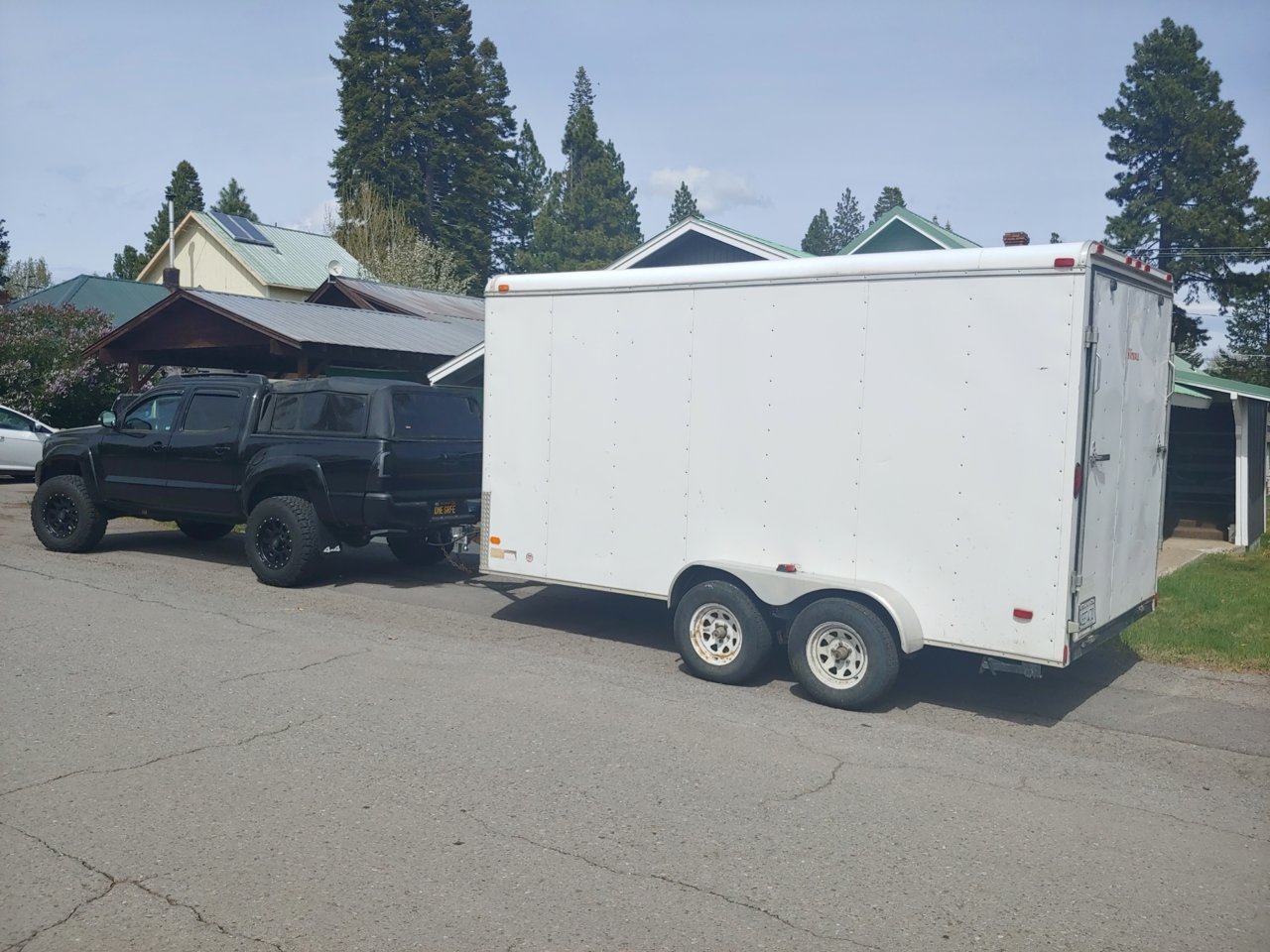

    After Buffalo Chips, we went to Lake Almanor, The Peninsula, and are now back home.

    How’d it tow?

    Actually petty well. The trailer is empty with only the spare and some diamond-plate cabinets, so it's pretty light right now. I'll get some weight in it soon.

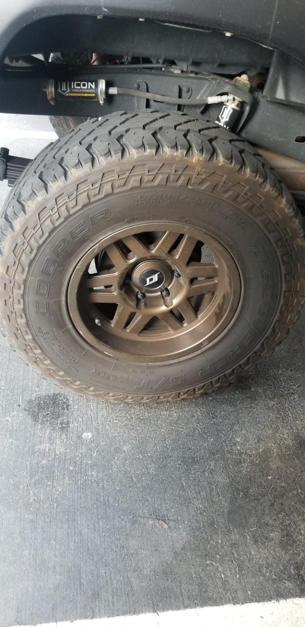

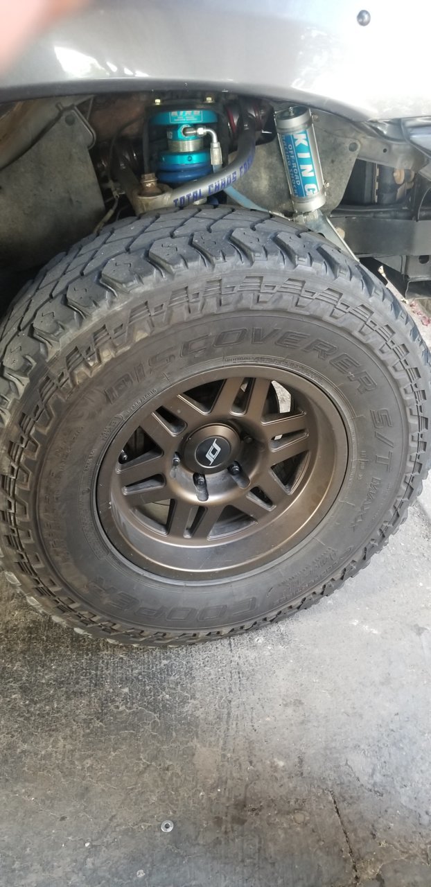

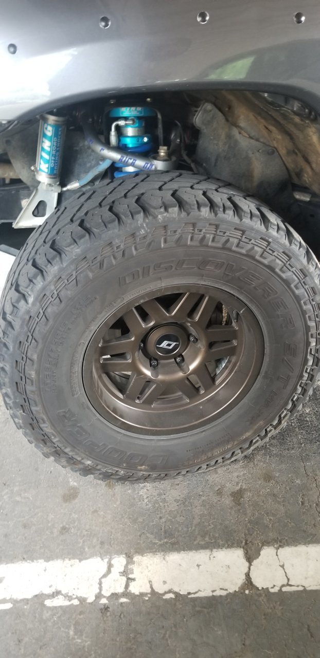

    When people talk about riding like sh!t I think it's mostly tire rating not size. Most bigger tires are rated for more weight/off road stress so they are Load E. I went pizza cutters although they aren't actually that skinny and despite taller size they ride like stock. Also the 17's fit GX470 brakes under them that the 16's wouldn't.
    I went Ray 10 17's w/DISCOVERER AT3 4S - 255/75R17 and they ride great but I wanted to go up to the Pros at 255/80\17 but they were more expensive, wouldn't fit in spare spot easily, and were Load E rated so the weighed a lot more per tire.
    Lots ot tire threads here but if you're looking to keep ride normal I'd suggest avoiding Load E unless you really need it.

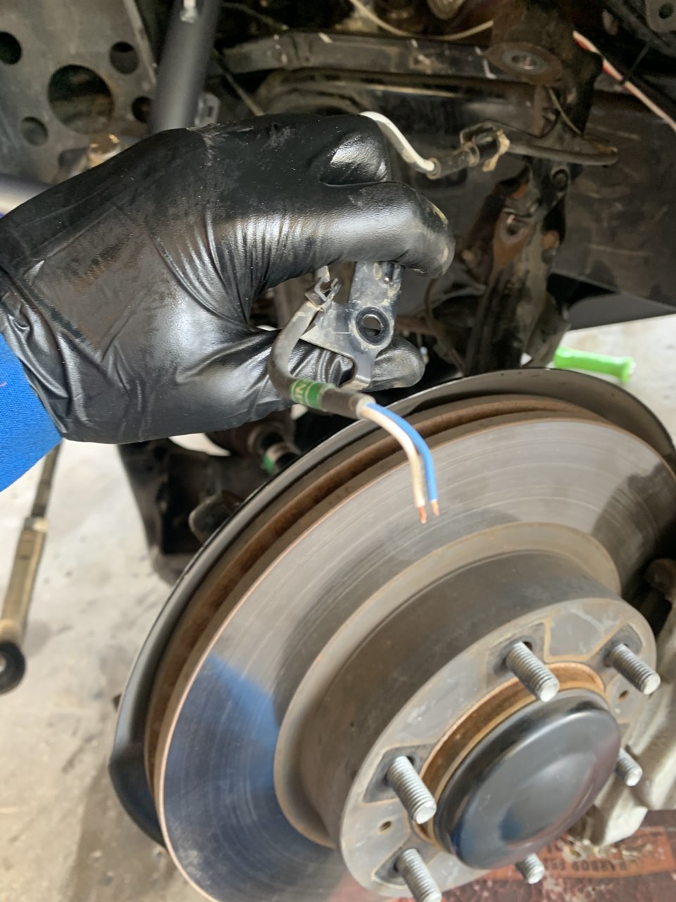

    3rd gen guys. If we rip an abs wire... what fuse do you pull to be able to drive? :anonymous:

    You should be able to drive without it till you get the new wire or fix this one. It will just throw the ABS/traction lights on and you ABS won't work. It will lock up the wheel (side with messed up wire) at first, but once you pass 20 MPH speed and use the brakes couple of times, it will work fine.

    sounds good thanks!
