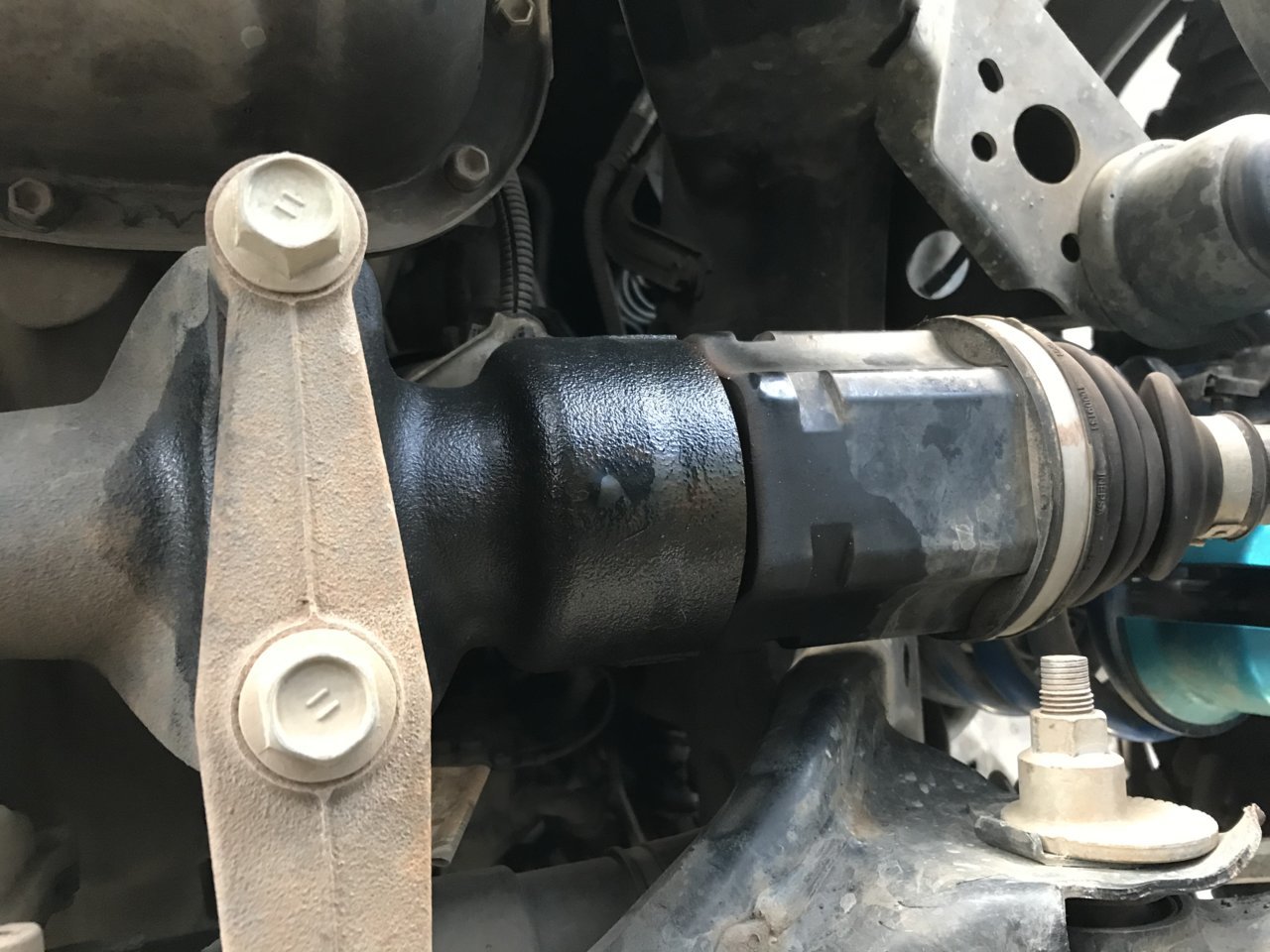

    Took the Taco into Livermore Toyota to change out the fluids in the difs, and t-case. Was going to do it myself but it’s just been too crazy lately. Also, wanted them to look at an oil leak. Still under warranty so why not.
    Here’s the leak.
    You can see a drip forming in the middle. It feels like oil. But they’re telling me it’s an outer axel seal. And said the other side needs replacing, as well. It’s under warranty so fine. I make an appointment. But it looks like oil, not grease. What am I missing. Also told that lift, and big tires, enhance wear of axel seals. Is that true?

    Based on location alone, I'd guess it's gear oil leaking from the seal at the diff to CV axle. I carry a few of those seals around in the 4Runner since it's a pretty easy seal to swap and they can get messed up pretty easily depending on how delicate you are with pulling and replacing CVs.
    Have you swapped CVs recently?

    No swap. Probably wouldn't be a bad idea to have those replaced while they're at it. Only 63,500 miles on the truck.

    Can't remember, have you regeared? If so and you're on Nitro's, they use a super thick oil weight with their diff fluid = could be a tell tale sign of what's actually leaking but my guess is still the front diff where the CV goes in.

    No regear.

    And yet, they changed the oil in the front dif knowing it had a leak. Why not wait until after the seals are replaced?

    They should only need to top it off (for free).

    Since it's warranty work, you're probably right. Since they're in there, should I replace the CV boots?

    That would be on you. Meaning not covered by warranty. Now, any labor that's overlapping with the work you're having done would be covered. In theory, if they have to pull the CV to do the seal, then the only labor you should be liable for is the replacement of the boot.

    Oh, I understand that part. But might be worth it. And I have a spare outer boot in the garage. OEM.

    Might be worth it. Like I had a leak and just replaced both CV axles with new ones.
