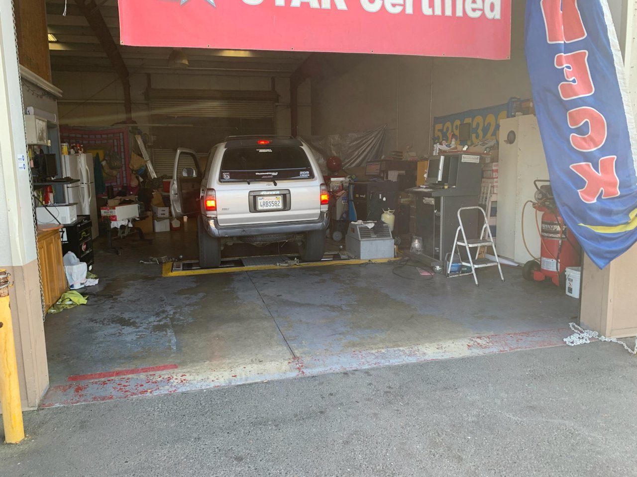

    So, time to vent
    For those that don't already know it. SMOG is a fucking scam.
    We're still trying to SMOG my son's T4R for change of ownership.
    This thing passed in 2019. It has less than 5000 miles on it since it's last smog. We had done a lot of work to the rest of the truck, but did basically nothing to the engine... so everything in there was in basically the same as it was when it passed smog last time.
    So it failed it's initial test due to HC PPM reading being too high.
    What are the causes of HC PPM being to high?
    Faulty ignition componants
    Lean/rich fuel mixture
    Faulty intake componants or vacuum leaks
    Low cylinder compression
    Bad Cat convertor
    Ok...
    So we replaced the spark plugs, the old ones were fouled, and the wrong ones were installed on driver side. We also replaced the spark plug wires.
    We ran the fuel out of the tank, (which was over a year old at the time of the initial test) and ran fuel injector cleaner (we did this before we replaced the spark plugs). We then filled the tank with 91 and octane boost.
    We also examined the intake system and found a half dozen potential leaks (loose connections etc) we addressed those.
    This made absolutely ZERO difference on the 2nd test. Numbers were exactly the same... tell me how that is possible.
    Now... the check engine light is not on, and the OB2 does not have any stored faults. The truck runs with a crystal smooth idle, there is absolutely no loss of power, no egg smell, and no rattling in the exhaust system... so I think we can run out loss of compression and cat convertor... but even if these were bad... how did the numbers not change at all, with all of the other stuff that was identified and fixed?
    Not to mention, the thing passed with all of the problems we identified... and you don't drop compression or blow a cat converter in 5,000 miles.
  18. Apr 19, 2021 at 7:30 PM
    nDub
    nDub Kan kun være malet af en gal mand
    Feb 6, 2017
    #209802
    10,773
    Central Sierras - NorCal
    ‘17 TRD OR DCLB and a dǝǝſ
    Lead Free Gasoline
    Oof. Does it burn oil? That’ll foul a cat fast.
    I’d run some kind of “pass smog” system cleaner and try and get the cat as hot as possible. Maybe burn some carbon out.
    Before all that if you have a IR temp gun I’d check the exhaust going in, the temp of the cat and the outlet exhaust. The temp should be way hotter coming out. Like 500f hot. Cat will be up there too if it’s working.
