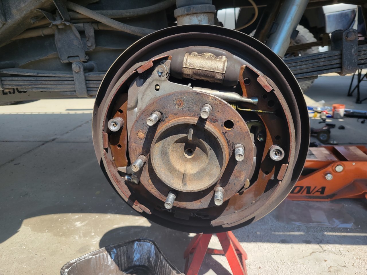

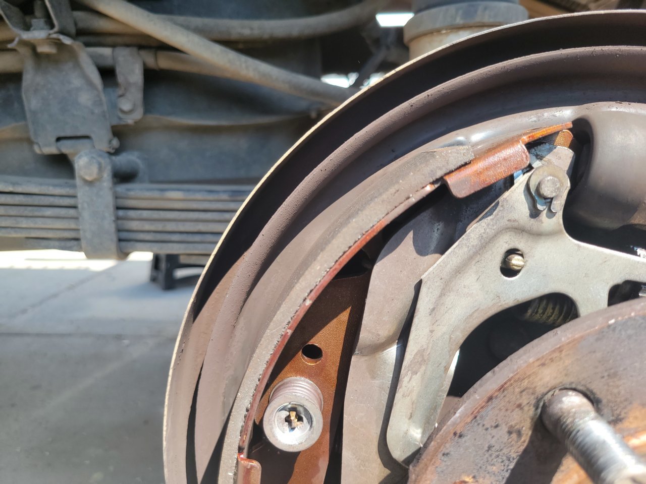

    I have not done all 4 wheels (up at the same time), but I have freewheeled the front... and now the back, and I can't get any noise.
    As a matter of fact... (also)
    So, now I'm chasing the squeek to the back. Thinking maybe one of the rear dust shields is bent, or I have worn shoes...
    Nope
    Shoes have better than 50% life left in them (with these drums of ours, that's like 100,000 miles lol) and I have better than 1/8th of an inch clearance from shield to drum all the way around (probably closer to 3/16)
