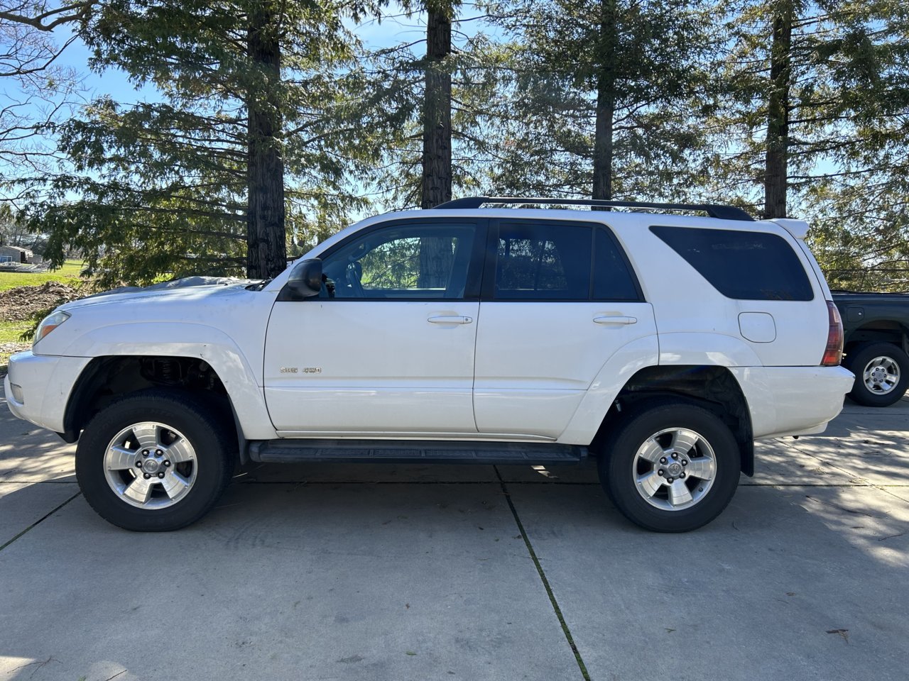

    Personal experiences with extreme lift height on 4runner, think I seen you said 4.25" front. SPC you'll need to get close to factory spects, need a tech that really knows how to use the settings, con about them, dont use if your doing extreme off roading, BJ are junk for them and will be replacing frequently if you do.
    The others with built in caster on that amount of lift, you'll be lucky to get 1.5 caster.

    Thanks for the info. Yes I was surprised to get a total lift of 4.25. The 885 on the lowest perch of 5100 were advertised to gain 2.5”.

    Are you sure they're assembled correctly? If the bottom seat perch is inverted you'd be close to 4 in. Just a thought
