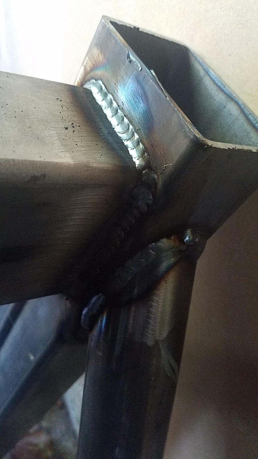

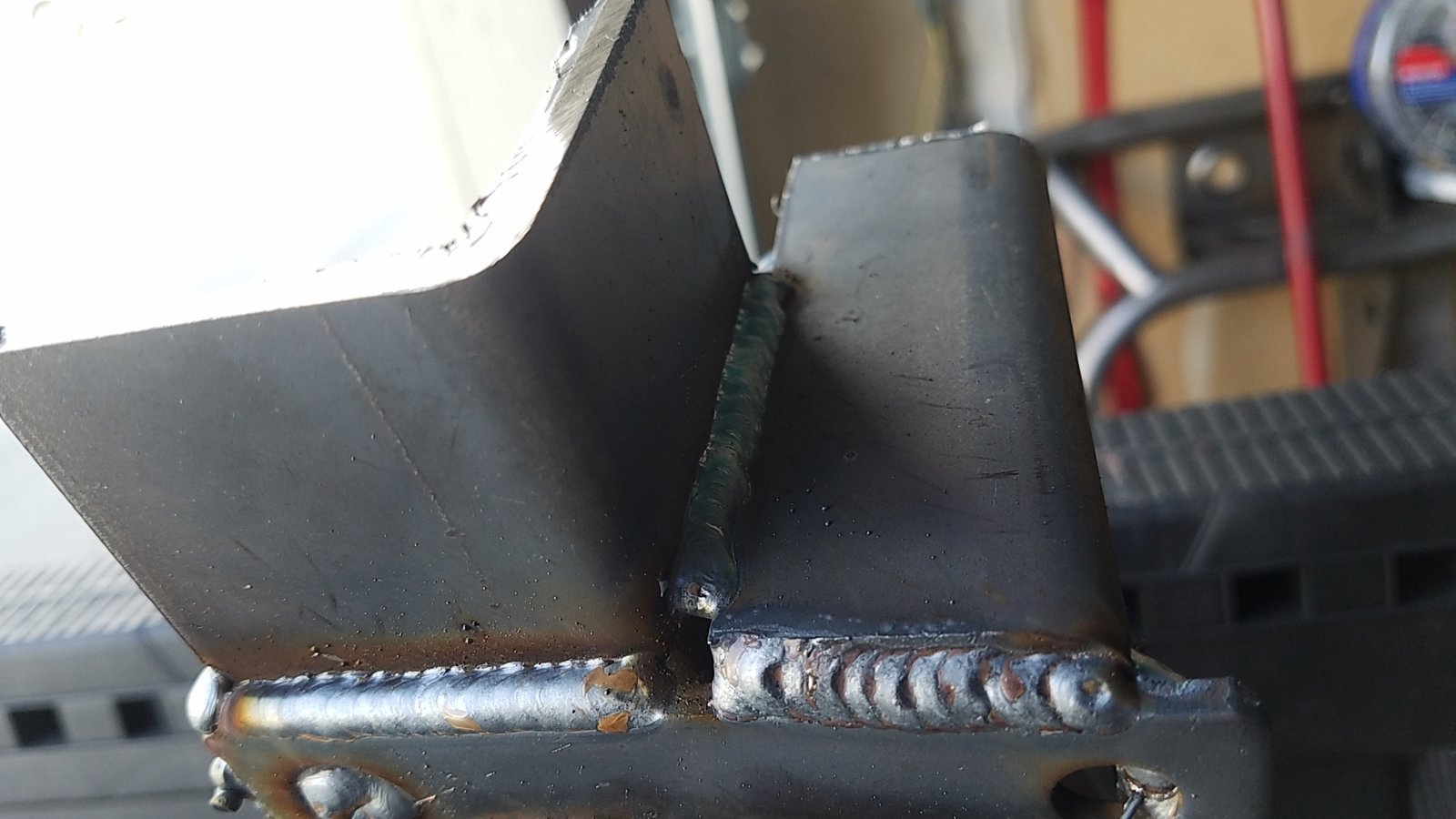

    I have a Lincoln 140 and it works for about 80% of what I want, but I have noticed limitations for things like suspension brackets or things that I need to know are solid. I learned by getting some metal scraps from a fab shop and literally just welded them together, cut it, welded, cut it, welded it lol and watch youtube on how to approach different welds!
    20180329_162703.jpg 20180412_185926.jpg 20180412_183517.jpg IMG_20180629_184457_263.jpg
    May wanna consider a 240 or 120/240 when you step up just in case you want the extra go juice.
    It really isnt that hard, and you get to be really creative! Im still not that good but youre gonna do great! Shouldn't run into issues unless you want to weld aluminum (mig can with a spool converter), stainless, or something exotic.

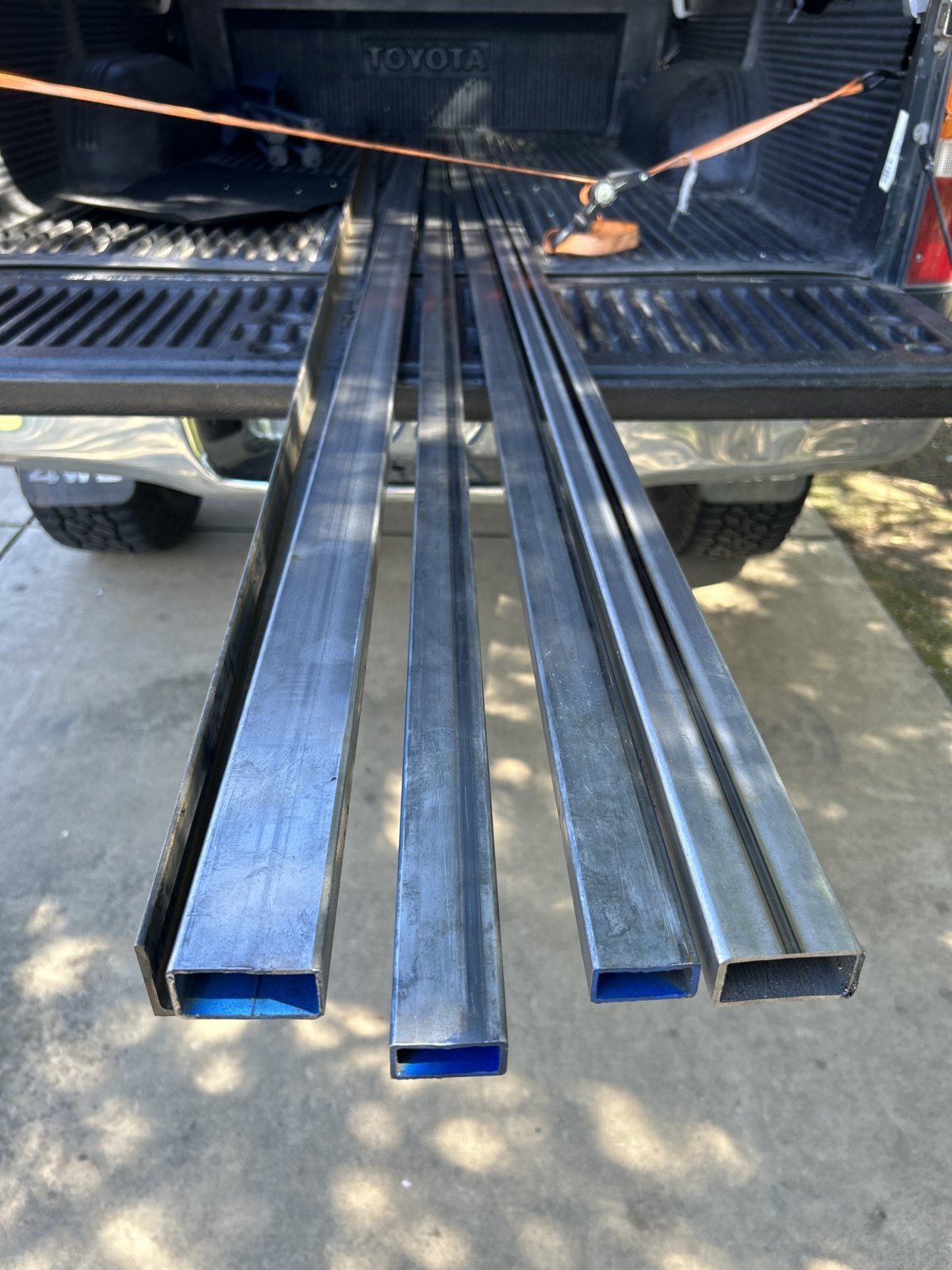

    Sweeet! bad assery! I actually went to Metal Mart (local metal store) and picked up some 1x2, 1x1 1/2 rectangle and an angle iron today. I’m hoping I’d be able to weld a bed rack. I’ll just need to figure what I could use other than and angle grinder.

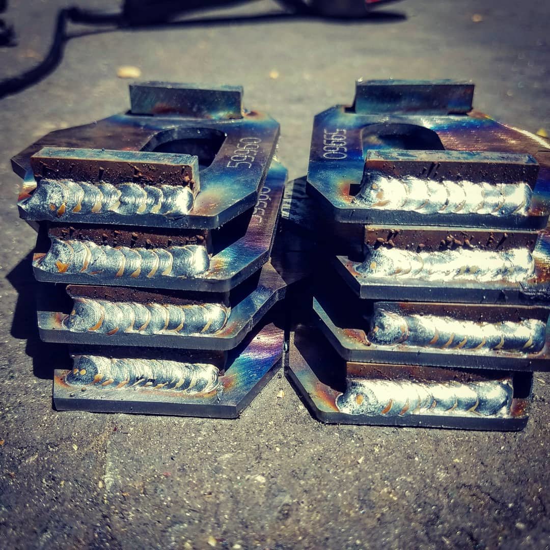

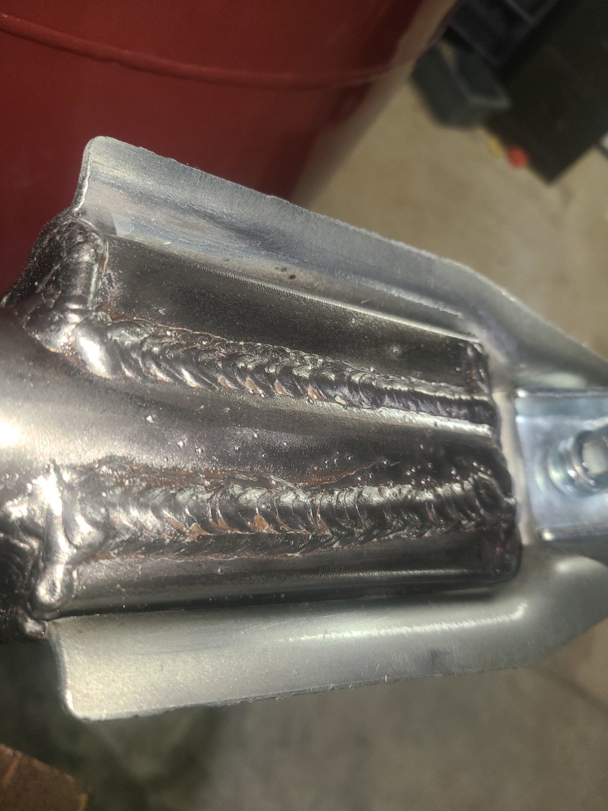

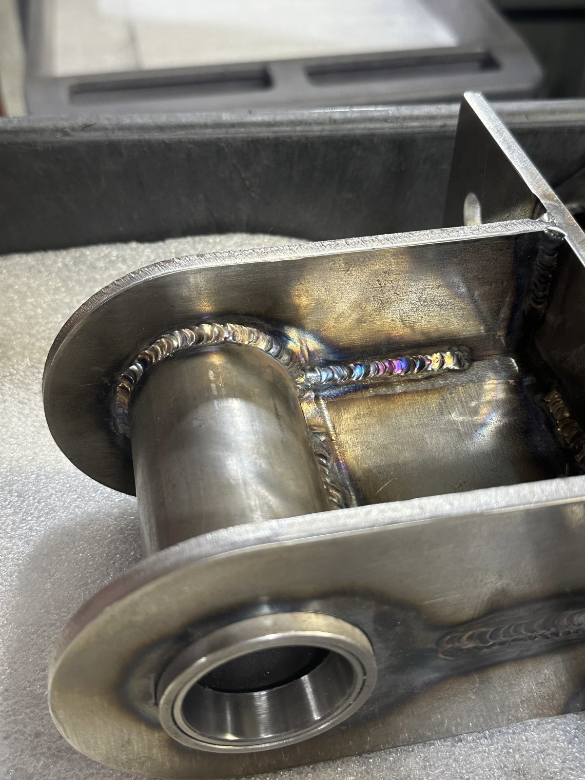

    Heres some friday metal-melting motivation for ya :D Welded up these pivots I designed for a custom wall jib crane for work. 1/4” clean plate is the most fun I’ve ever had with a tig.
    Not perfect by any means but they are beefy

    Harbor freight chop saw is good to have for a budget option. Another option is a metal miter saw but more monies. And cutting, grinding, and wire wheels (basically req'd for flux) for the grinder. Angle magnets are basically a must. Degree finder magnet is a must if you're ocd. Drill bits and a small harbor freight drill press will help too.
    Or market place the stuff
    Riv nuts might be good for that project. You could make inner and outer sleeves on the verticals and horizontals so you can adjust the height and width with some pins.
    https://www.amazon.com/s?k=rivnut+t...efix=rivnut,aps,370&ref=nb_sb_ss_ts-doa-p_3_6

    Those are nice looking stacks. It's crazy how different mig and tig look. Entirely different skills
    techfinsoup likes this.
