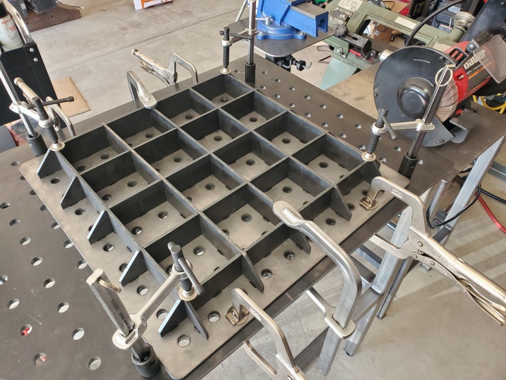

    Anyone have someone/ recommendations in the area with a plasma table setup to help me cut a welding table top?
    Hoping to finish this project before I get down and dirty with the roll cage.
    I have the 1/4” sheet and Cad files ready togo.
    Stock size is optimized for a 4’x4’ table capacity

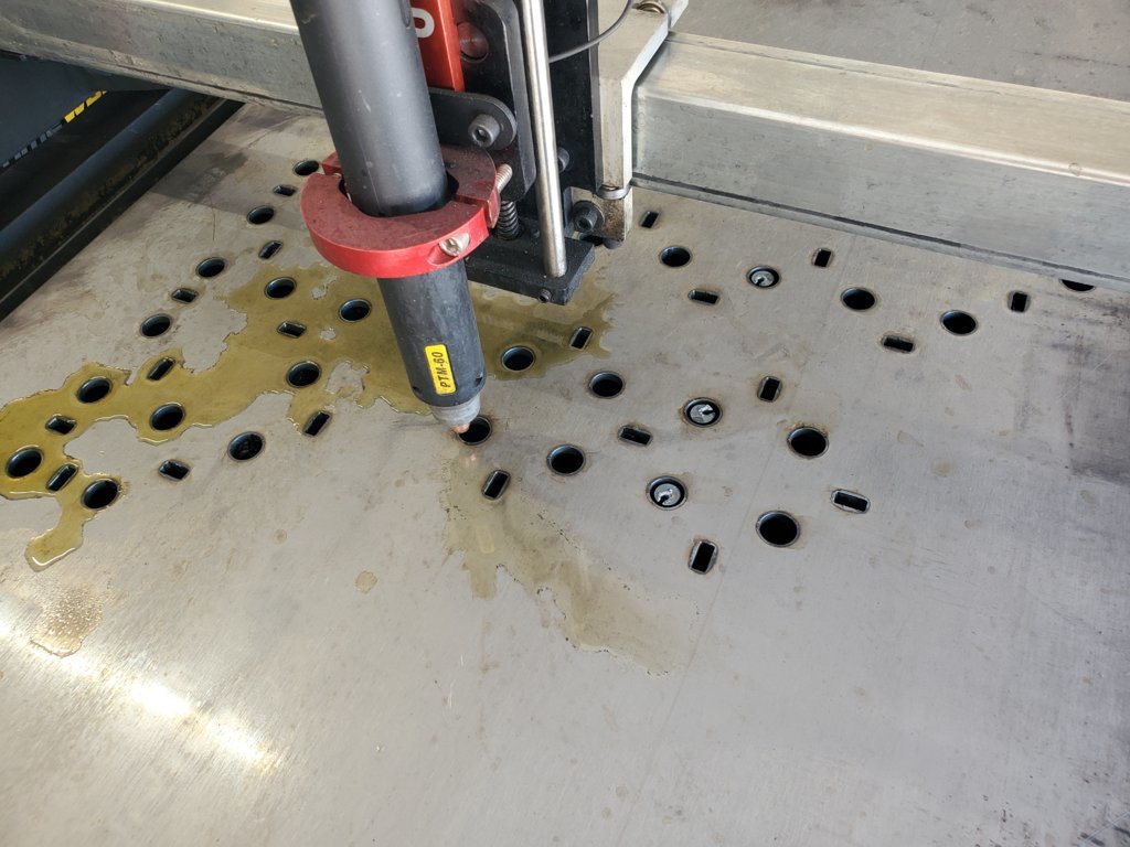

    As someone who has actually cut out a fixture, had one done locally, and bought one that was machined, I can share a few things.
    1. If you get it done via CNC plasma, you will have to go through reaming out each and every single hole. This is because of the naturally occurring bevel that is present in plasma and the shape of the flame. Now, I cut a lot on my CNC plasma table and get some square edges but normally fixture tables have holes measuring within a thousandth of an inch. For this reason, anytime fixtures are done on CNC plasma they are undersized a hair before they're reamed out.
    2. I would advise against 1/4" as it's too thin. You'll warp the surface easily over time as you use any fixtures to clamp your material down.
    3. On top of the whole clamping thing, 1/4" is pretty thin and will warp over time with heat from welding.
    4. Find someone locally to laser or waterjet your setup, you'll get far better accuracy and you won't run into the holes not being ready to use like you do with plasma.

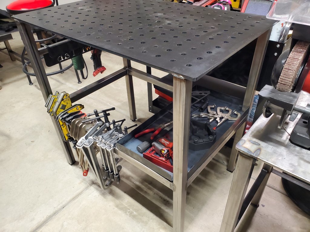

    Here's the one I did for fun. Free since I always have extra steel and made it out of scrap. Literally just gave it away a few days ago -
    Here's the one I got laser cut locally. Was only $158 which included the material itself (3/8" steel plate) as well as the labor for laser cutting. The legs, shelf, etc were all made from left over scrap -

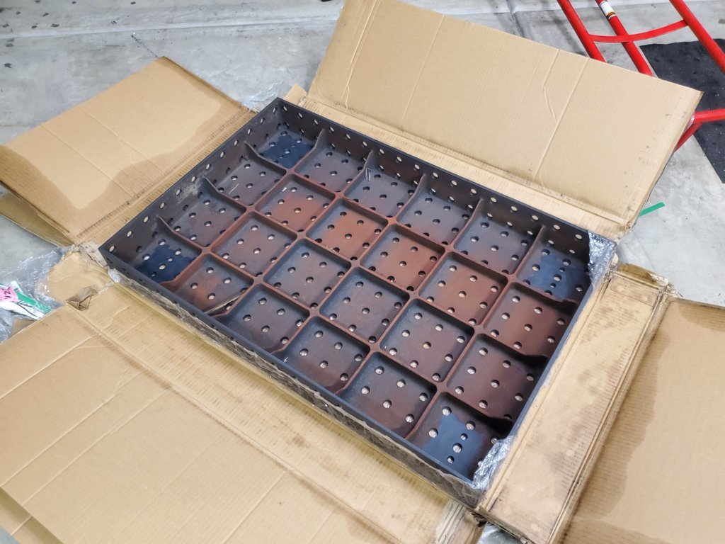

    And lastly, a cast and machine finished fixture that's also 3/8" thick for just under $1,000 -
    If I did it all over again, I'd go straight to the cast and machined fixture from the get go.
    But if you want to save money, get it done on laser or waterjet.
    And since you have the CAD files, I assume you're going with some sort of top with a tab and slot ordeal underneath? I'd nest it and see how much steel it uses IE one or two 4' x 8' or 5' x 10' and figure your raw material costs followed by labor.
    Most shops will want you to buy the steel from them if they're doing laser or waterjet from you so it shouldn't be much.

    All good points, The reaming is definitely something I was planning. i have accounted for tab/slots for trussing aswell, everything fits on a 4x8 sheet. final shape is 2x 3x3 squares cross braced for stiffness. This definitely wont be a heavy duty fixture top. But I believe it will work for my purposes. And 1/4” is what I got to use so Im making it work for me. Id love to get my hands on a cast table once I have a better budget and a more permanent garage/ shop space.
    Im getting ready to install my cab cage in a garage that only has about 2-3ft of clearance on either side of the truck:anonymous:
