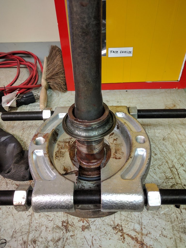

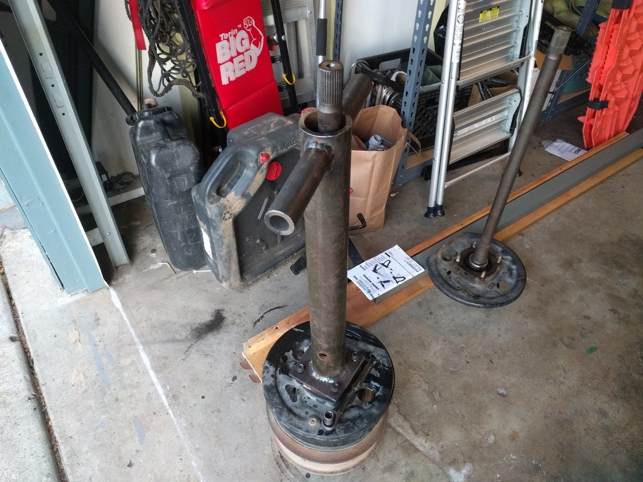

    Heavy Metal Off Road in Livermore, Tim https://heavymetaloff-road.com/ , fabricated a tool to do the job, I tested it out and it works! was able to change out the left rear bearing. Along with the tool you will still need a press or access to one, and either a cut off wheel or another tool, a bearing puller thing, which I have to complete the job of disassembly. For reassembly, you will need another tool to help press the new bearing in, and its basically the right size pipe to push against the bearing, not the bearing housing, which I have.
    I'm going to leave the bearing removal tools and the little pipe for assembly with Tim, great guy and skilled fabricator. Also, if anyone needs to do the job, I can help and guide you!bearing puller.jpg
    the too Tim fabricated, heavy duty :benchpress::benchpress:
    the bearing puller I used to remove the outer race. The heavy duty one only pulls the bearing housing, the retainer ring and the bearing. the outer race part ends up staying pressed in on the shaft, and I've seen vids of people cutting it off. This tool was perfect and removed it easily using the press to push down on the shaft.
