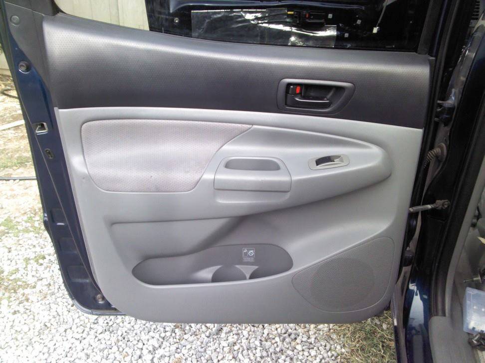

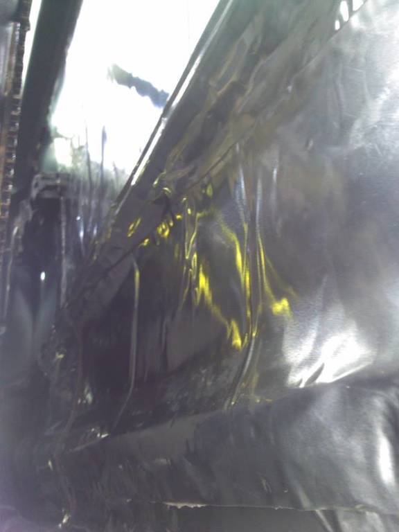

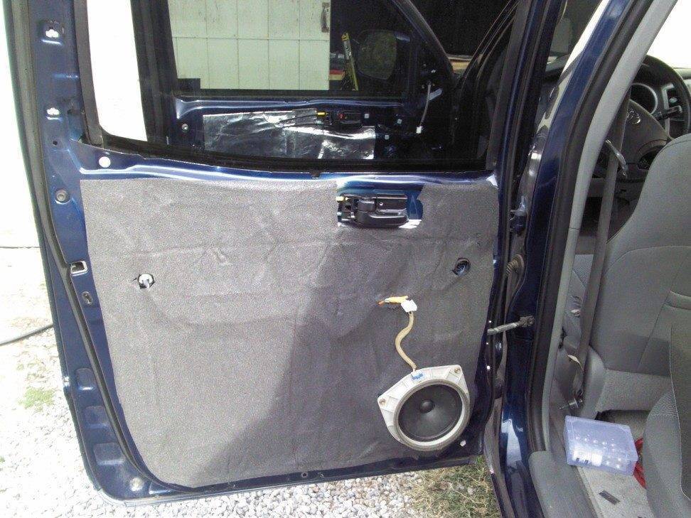

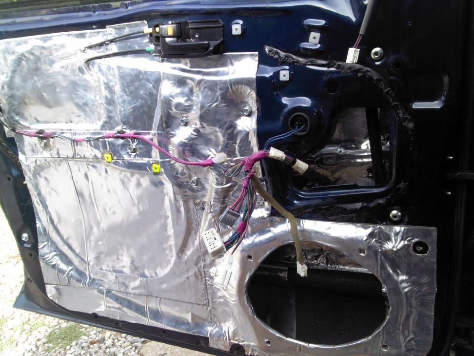

    Today I managed to get all the doors deadened inside and out using RaamAudio's Raammat and foam sheets.
    The back doors i closed up but the fronts are still waiting for the HAT speakers to arrive to be finished.
    I ran the 4G power to under the driver seat and then ran 16g speaker wire from there to the front speaker locations, I just a piece of 12 gauge romex and electrical tape to pull the wires through tight spots and the door boots.

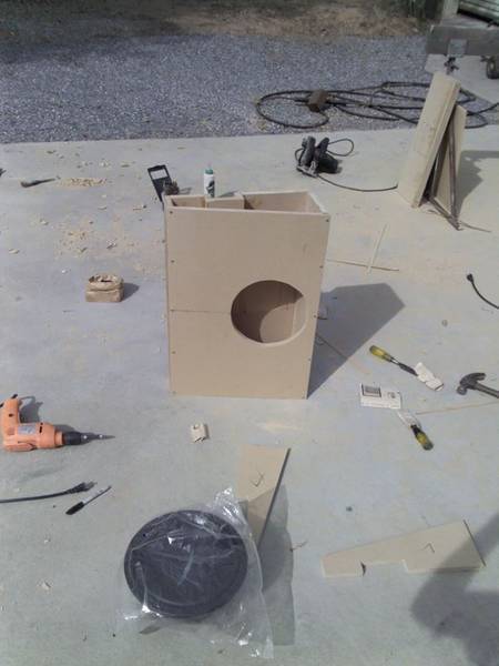

    I think both amps will fit under the drivers seat and also I plan on building the sub box on friday or saturday.
    Should be finished up by next week.

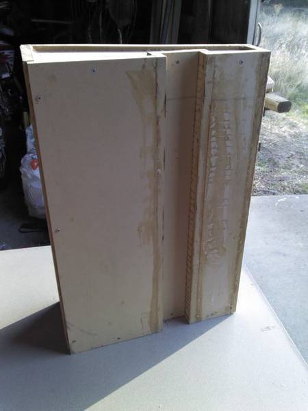

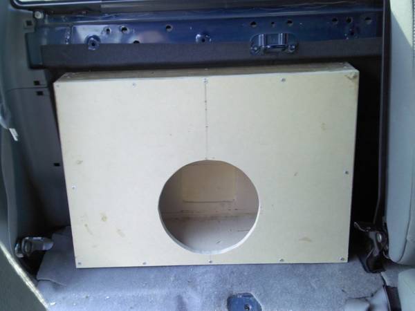

    Built the sub box

    Got the sub box built :)
    pics uploaded
