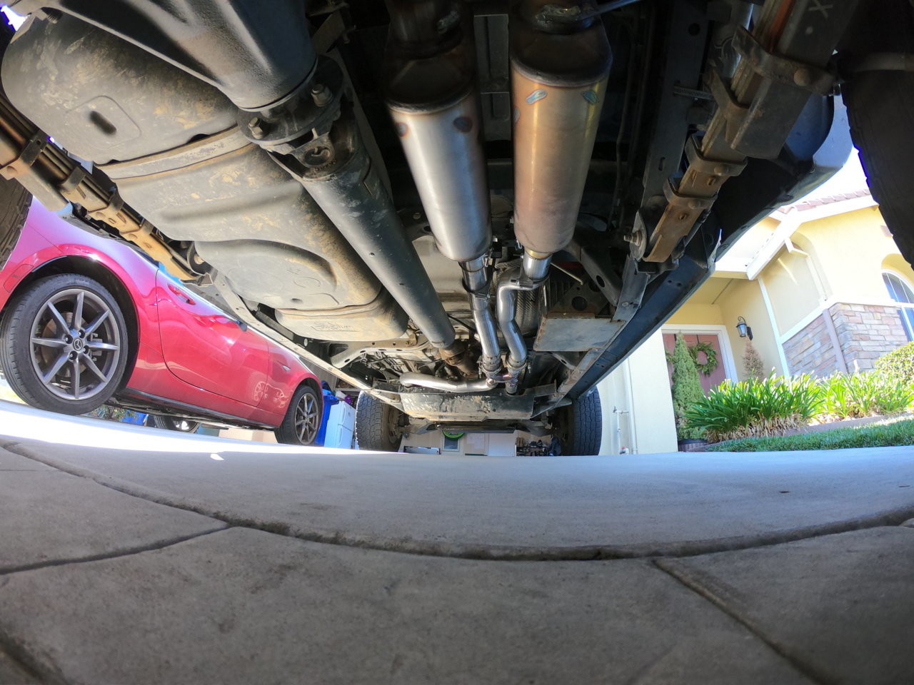

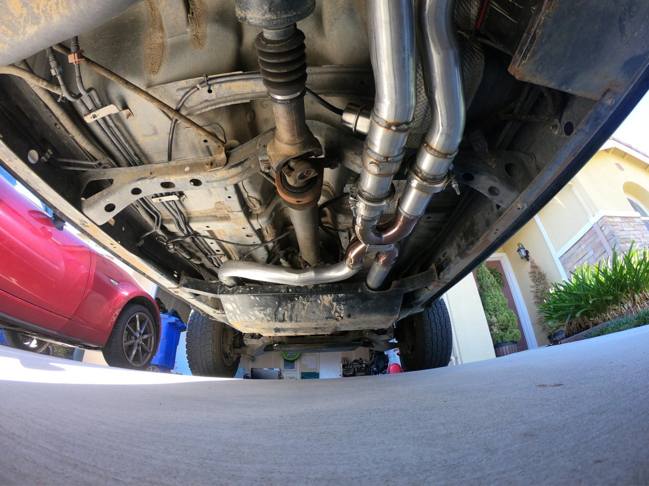

    True dual Black Widow with a variable second Y pipe to X pipe setup. Fully opens at WOT, 7.5 psi. Gives it power when I stomp it and quiets it down to act like a normal Tacoma when the truck is in vacuum.

    Very nice setup!
    What's the exhaust pipe width?

    2.5" post secondary cats all the way through.
    It's overkill for NA setups and may sound differently without a supercharger and if you don't have cam gears.
