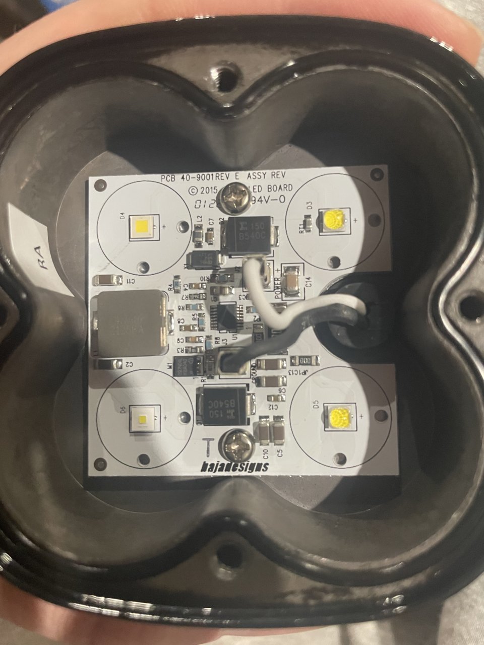

    Picked up a set of Baja designs, squadron pros. Was wondering why the leds are mismatched and it it’s normal. Thanks

    Yes. The domeless LEDs are XP-L HI's, a "high intensity" chip, where the other LEDs are XP-L's, which use a silicone dome ovee the chip to extract/redirect some lumens that would be "lost" within the LED. The XP-L's would be more efficient in terms of lumens/watt with the same die as the -HI variant, but the die also magnifies the "apparent die size," reducing the intensity of the die, which reduces the maximum intensity you can reach with any given size/type of optic.
    The extra lumens but lower intensity don't matter as much for the wide spread/flood type optics, which is why they use the two different types of emitters

    Thank you very much for the information!
