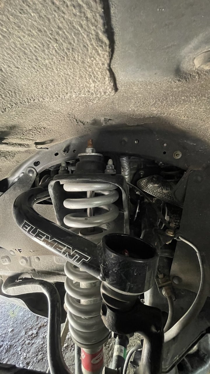

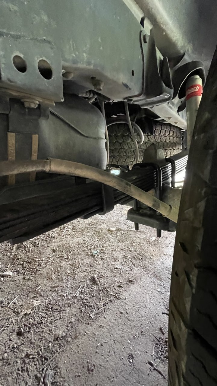

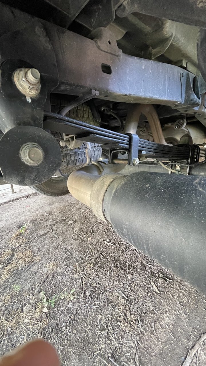

    Post some pics of your new leaf pack installation and your front Eibach’s. I recall a few people not having the front coils seated correctly and even a few that had the lower coil support upside down. Maybe me or someone else can spot an issue for you.
    I’m pretty sure my buddy, @71tattooguy has that same leaf pack. Maybe he can chime in with his experiences with it. Don’t get discouraged, you have a good setup. Something just needs tweaked. Don’t settle until you love it.

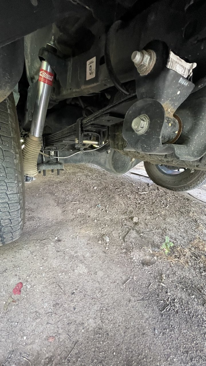

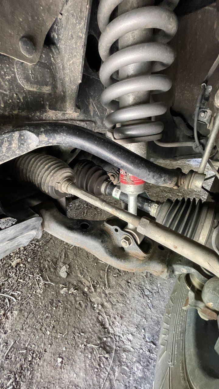

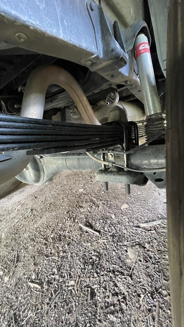

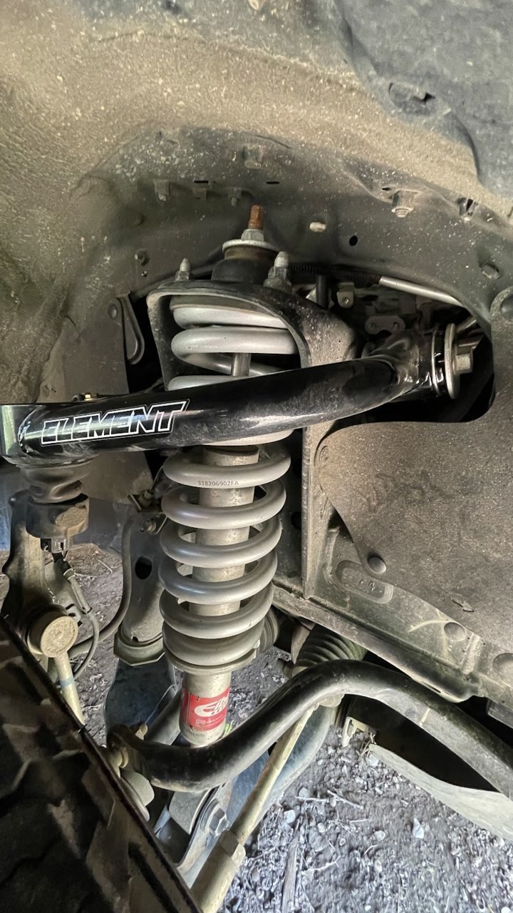

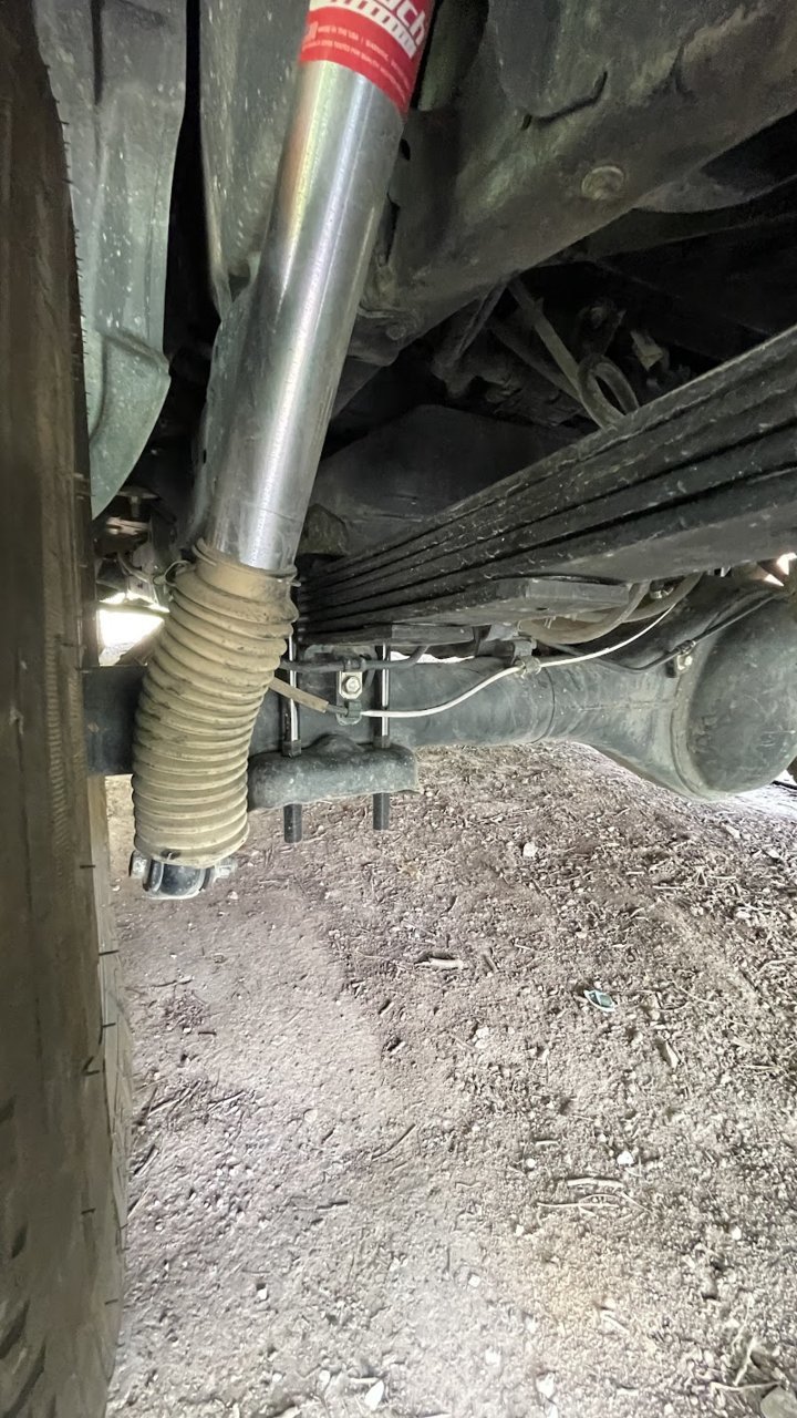

    Went out and got some pictures. Funny enough after triple checking and 100 ish miles of breaking them in.. The front leaf spring bolt on the passenger side was loose. Idk if that is what the cause is, but I bet it had something to do with it. I will update once I can take a drive after work. For now here's the pictures in case anybody notices anything else.
    Front Drivers Side:
    DEiviV5thTYDuHpac8k3EE7dQG2ZcfuhuFhyJOqh_b1d98d96d6e80e6b53782c0b446b67d1c1b8754b.jpg
    dN0SrMrx_cxjlL_SgMpmwta_8hhsEezjg_21u53L_8bb2bf70ba1ebb7c98f24f6ac47c1a760132e0bb.jpg
    Front Passenger:
    FqxWwoMr0tXnhCztmMTWfizVRtM8FHmLmBwf3vFI_3e94a3807900909e18d84bd6a8e6ca9f1b7574ef.jpg
    F6ayU19kGjNYlxKp6mBogy_p50DAEx10ROkZm9Xz_65256d12082a6f7d338d4de3cd679a6e651eb644.jpg
    Rear Driver:
    HyJiJDT2Nk96sVYd9UNPPM93OKWVnZOopCsOGjvu_b8439314ebd24dca005f8863b96ebb3ec01ee9af.jpg
    60INE39BVMOZ_zH0Mc9oD8Y8JEP6emgMOJxe8ntb_857b955847e416c5bffddf0048a72ab8f0e3176b.jpg
    A2V5rehE6UUmbU_JpN4iqmbXcuVl4WumM7TKCcgm_e856b6bb513d56aa7ce5b4bd49a1a69c606bdb8c.jpg
    Rear Passenger
    aFOf4tDmDTSCSCNHRET7EpG6G-YeI5r2VZReCgpt_9039de89f1329eb6dc41e892b7553a437c34eab9.jpg
    1KmZg-arGbOn7qYs5JNj64adoJ2YInUth87KDYmi_97221a3b149b4b8d29f9a5ac2879f7e5c788ff3b.jpg

    Kings 2.5” front and rears from Accutune / ICON RXT LEAF PACK black badges doors and tailgate / method 315 / 255/85/16 Yokohama G003 / magnaflow exhaust , axle dump / meso int delete kit / meso led map lights / dome lights / wheelers front super bumps / accutune Flip kit with spacer and new bumps / Cali raised fog light pods / Cali raised ditch lights / RCI FULL SKIDS / SLIDERS / RCI rear bumper / rigid backup lights / tuned on 4.88’s
    Looks good from pics. AAL Get tired after a while. IMO I recommend a full leaf pack. I’m running icon rxt on option#2. What’s nice about this leaf pack you can use it in three configurations depending on weight.

    So just an update after tightening the leaf spring bolt, the bouncing is still there. After paying some attention to the bed I can see it shaking in the side mirrors whenever I’m getting the bumping up and down feeling. Sometimes it’s a lot worse and sometimes I don’t feel it. Might try adding some sand bags to see if It changes anything.
