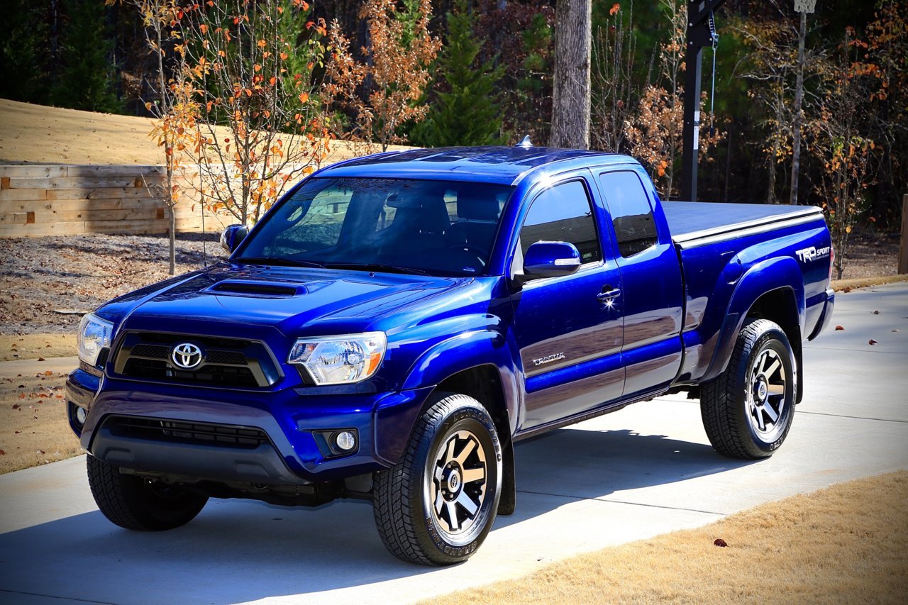

  4. Jan 2, 2020 at 10:01 AM
    Senoia Norm
    Senoia Norm [OP] Member
    Dec 10, 2019
    #313011
    8
    Norman
    2015 Blue TRD pro

    That is a pretty truck:thumbsup:

    Man I like that blue...no harmonics on my 2015.

    So jealous good looking truck
