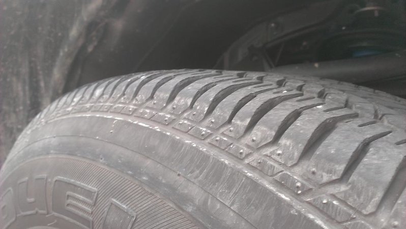

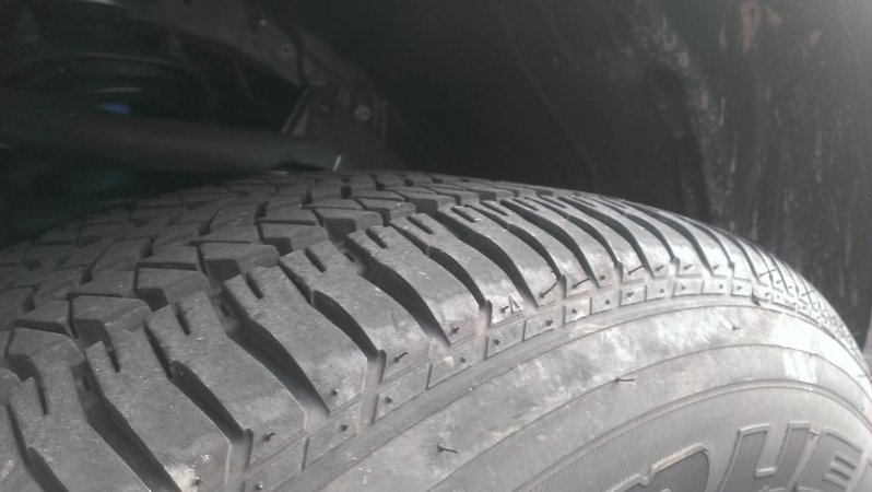

    Within the 1st 4000 miles, I noticed uneven tire wear on my right front tire outer edge. I live pretty far from the dealer, so I went to a local alignment shop and had it checked. They said it was only slightly out of specs. Shortly after I had my 1st service and they were rotated. It was noted on inspection list that one tire had less tread then others.
    I'm now around 8300 miles and am scheduled to have new wheels put on this sat. When setting up the appointment, I noticed the wear again but on both front. These are the stock dueler ht tires and this vehicle does battle up and down 270 being a work vehicle making around 15-20 stops in a 4 to 6 hour period.

    I think you have too much toe in. The alignment can be "in spec" but can be at the far end of the spec. In addition, the aligment machine can be out of calibration. My truck chewed up the outer edges of the Rugged Trails with only 300 miles on it from the factory. Took it to an alignment shop, and found too much toe in. The truck was realigned to "spec". The tires took longer to show feathering (about 900 miles later). I gave up, and did the alignment myself with jackstands, strings, and a lot of precise measuring. Tires have been wearing perfectly since.

    On both my Tacomas the front tires have worn the outer edges first and the rears wore the center treads first. If they're rotated front to back it evens up pretty well.

    That is normal for a truck. It is due to hard cornering or lack or rotation generally. You are about due for a rotation, every 5K for a truck.
    Also keep your tire pressure at the most psi possible that the chalk test will allow.

    Outer edge wear ( both inner and outer edges ) is due to under inflation of the tires.
    The Center wear is due to over inflation of the tires.

    Yes, this is very common. Especially on softer compound tires. The SRA is a soft compound as well. Dueller has a soft compound as well. The heavier the vehicle the more common. Also check PSI.
    What will likely happen is even with rotation at 5K intervals you will have this wear pattern on all four tires due to vehicle weight, suspension and tire compound. Dont worry about it, it is not cupping or belt separation.
