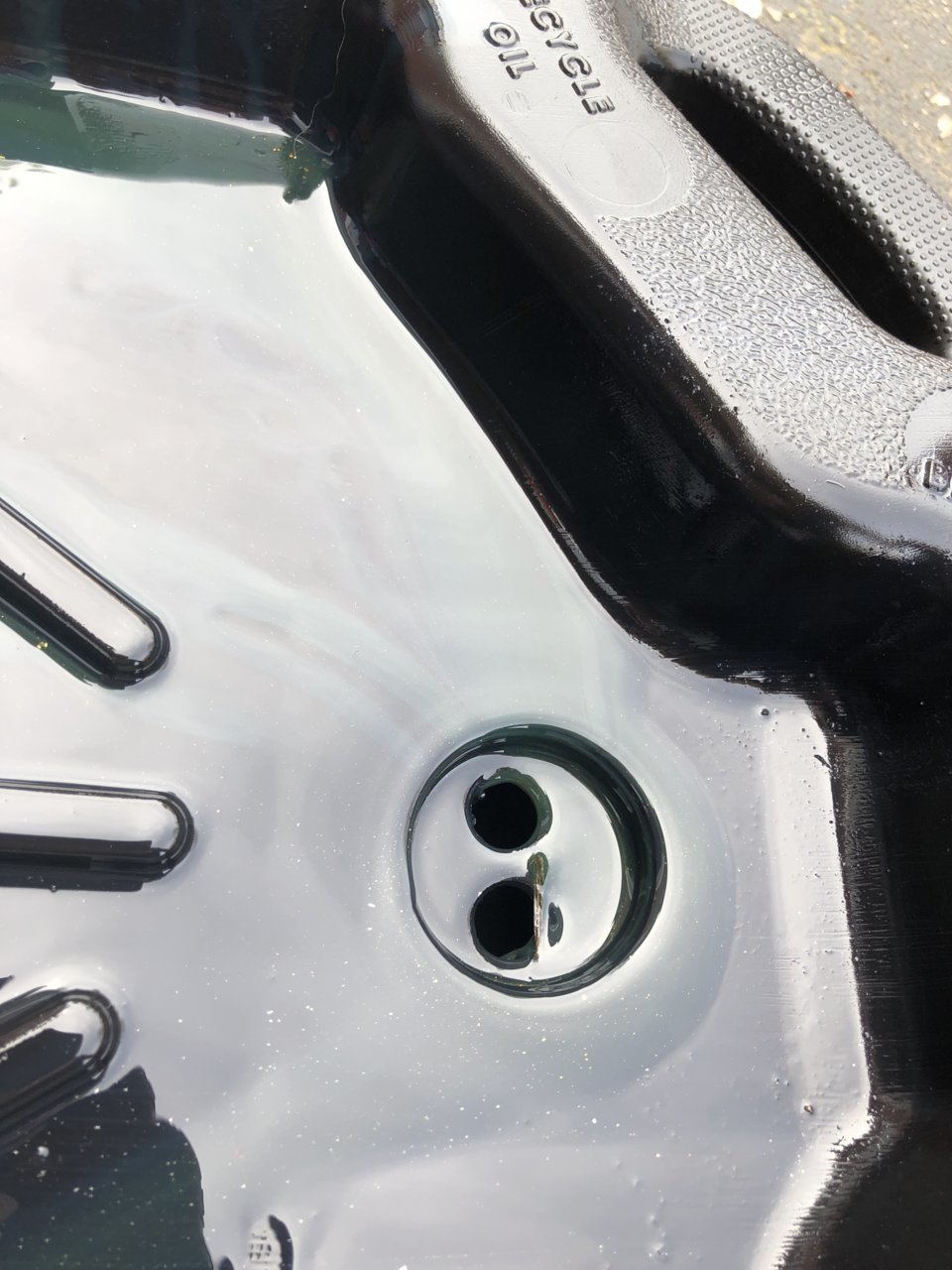

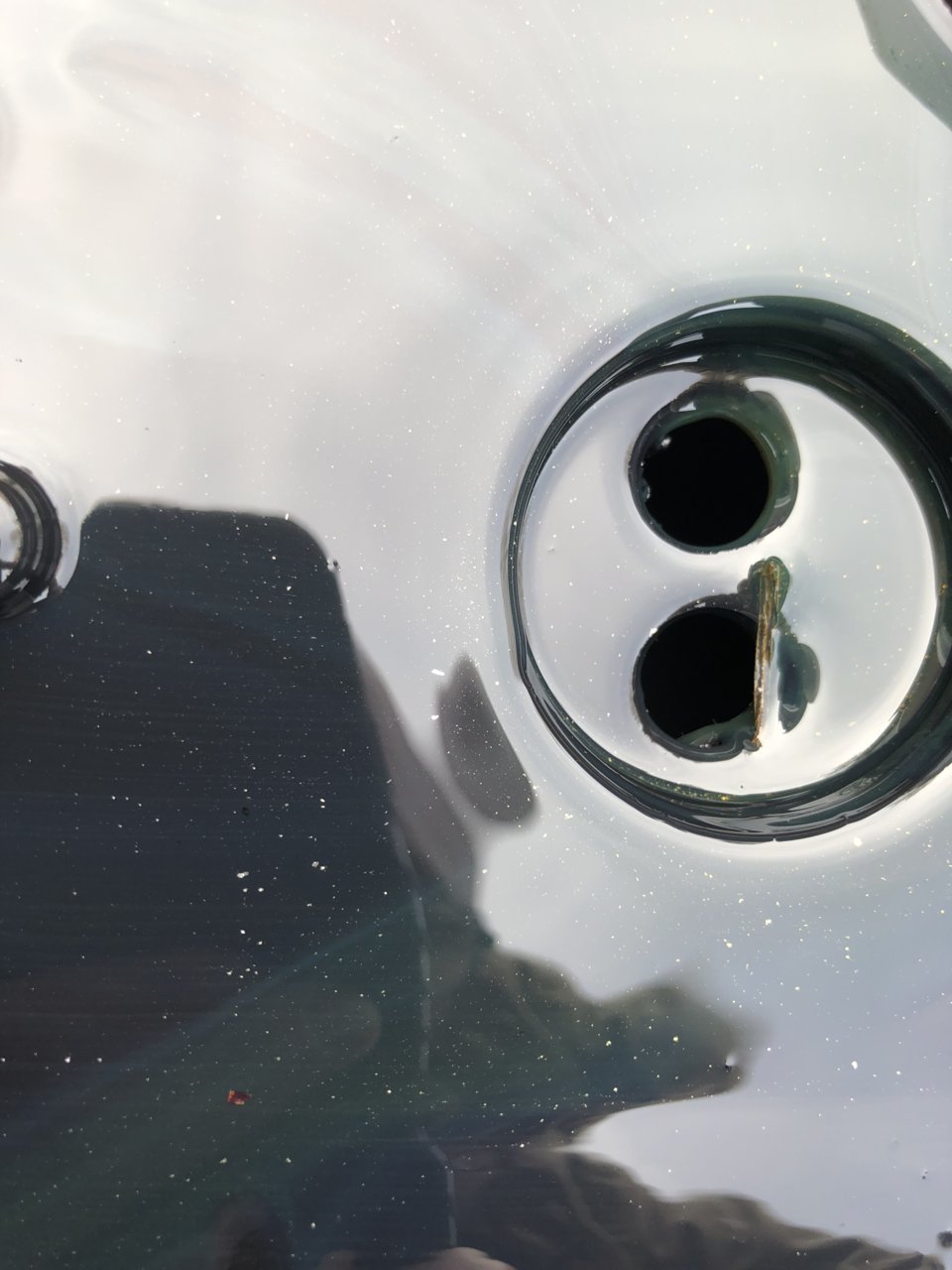

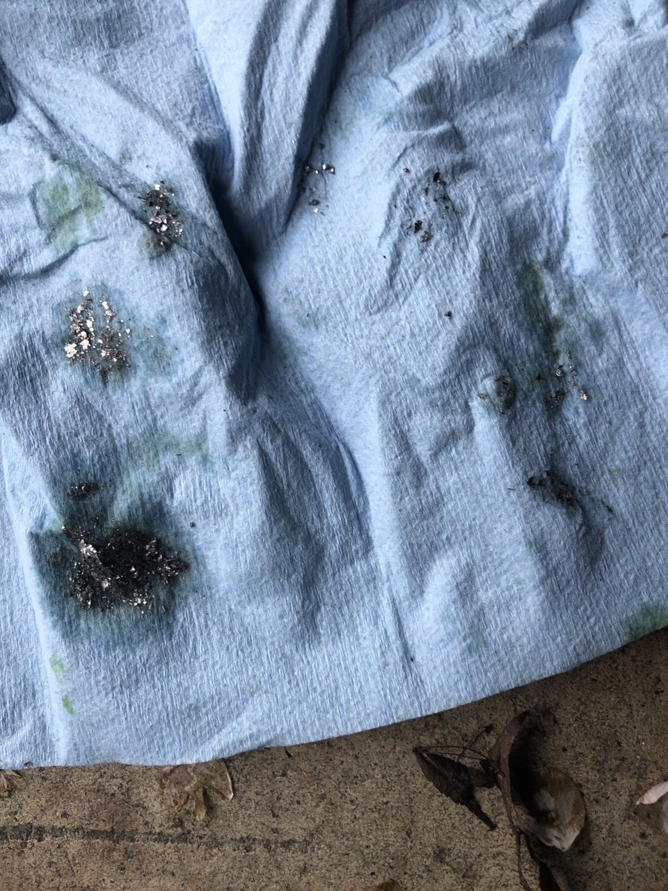

    I’m having an issue with my rear differential. The bearings were totally shot when I got the truck so I pulled the third member and send it off to have the bearings replaced. I got it back, put it in the truck, and it runs great! The only local automotive store that was still open by the time I finished up installing it only had some cheap gear oil in stock. So I bought it with the intentions of putting some better oil in after a couple of days. When I drained the oil there was a TON of metal in the oil. So i filled it up, drove it a couple of days, and drained the oil again. This is what it looks like now. This is the second “flush.” Is this normal? I’m getting nervous something is grinding in there.
    The oil battle on the driver side did not want to seat properly. Is it possible it’s grinding on the left axle shaft? There are no noises or anything.
