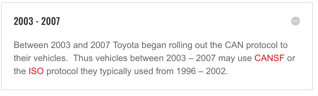

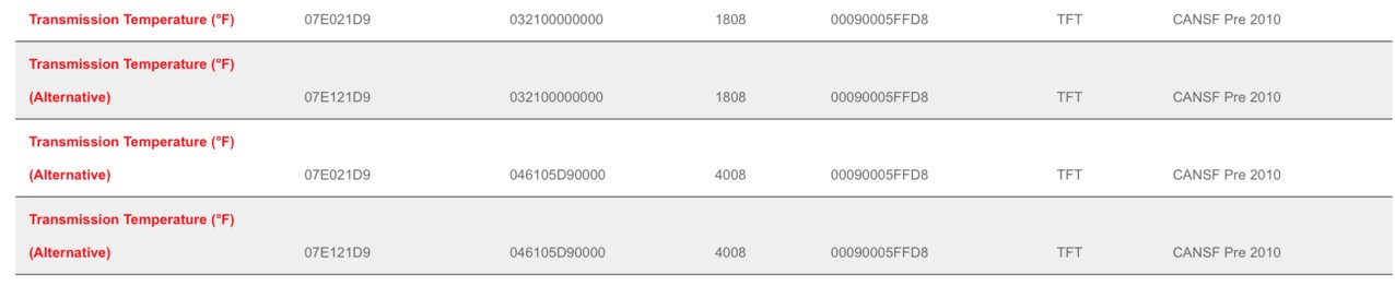

    OP: I found this on the Scangauge website. I am attaching two screenshots for you. @Tmar04
    For your 2004 you might want to try the code(s) paired with the CANSF protocol first and then try ISO after only if needed. I am on ISO but I have a 2001.

    Which of these four sets of numbers should I use? Thanks

    I’d try in order from top to bottom. The first complete line of numbers and code might do the trick.

    Finally called Scangauge and got proper codes. After about 4 tries. I got them entered and works like a charm. Radiator coolant 190f and AT temp 150. That’s with an auxiliary cooler in front of ac condenser and radiator. Now to figure out a place to place the thing. Thanks for the help. Have a good one. Terry in hot and humid so Georgia!

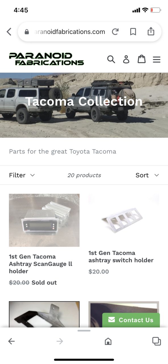

    I taped mine to top of the steering column.
    Somewhere on the forum I found a mounting bracket to move it where my ashtray was I believe. It’s been so long since I had my Taco I can’t remember now.

    Here’s one from:
    https://www.paranoidfabrications.com/
    Of course it’s sold out though
