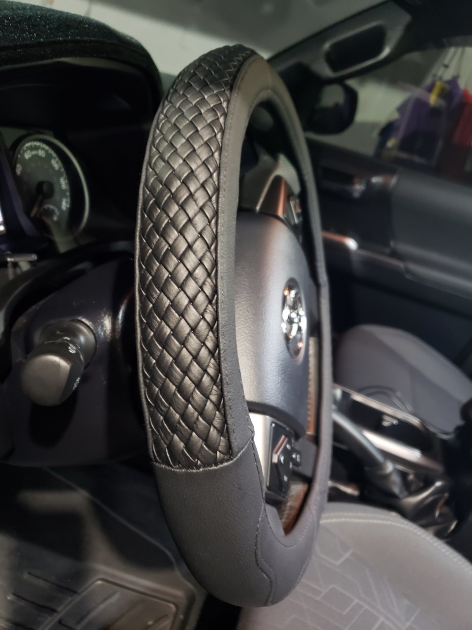

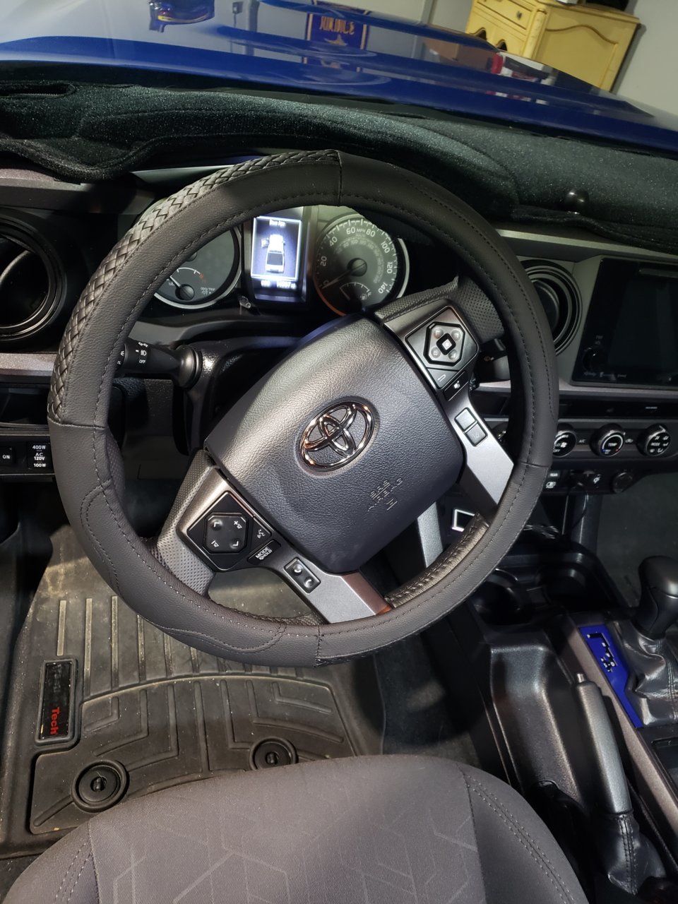

    '18 Sport 4x4, DblCb, ShBd, BBP
    I ordered a Moyishi "Top" Leather Breathable Steering Wheel cover from Amazon and used a free Prime Trial account to order it ( it's a Prime Member only item ). I know these things are kinda out of style for most folks, but the top of my steering wheel started feeling "slick" and it started to get worn from use. So I opted to get this cover to alleviate any chance of the steering wheel unexpectedly slipping. I have to admit, I've never put on a cover that didn't need to be sewn on and this took some effort to stretch it to put on ( thank goodness I heated up the inside with a blow dryer first ), but it's a nice tight fit and it actually feels good. The manufacturer shows it with the braids on the sides, but I preferred to have them top and bottom. I believe that it's a great improvement on the grip!
    https://www.amazon.com/Moyishi-Leather-Steering-Universal-Breathable/dp/B01GFNZK4Q/

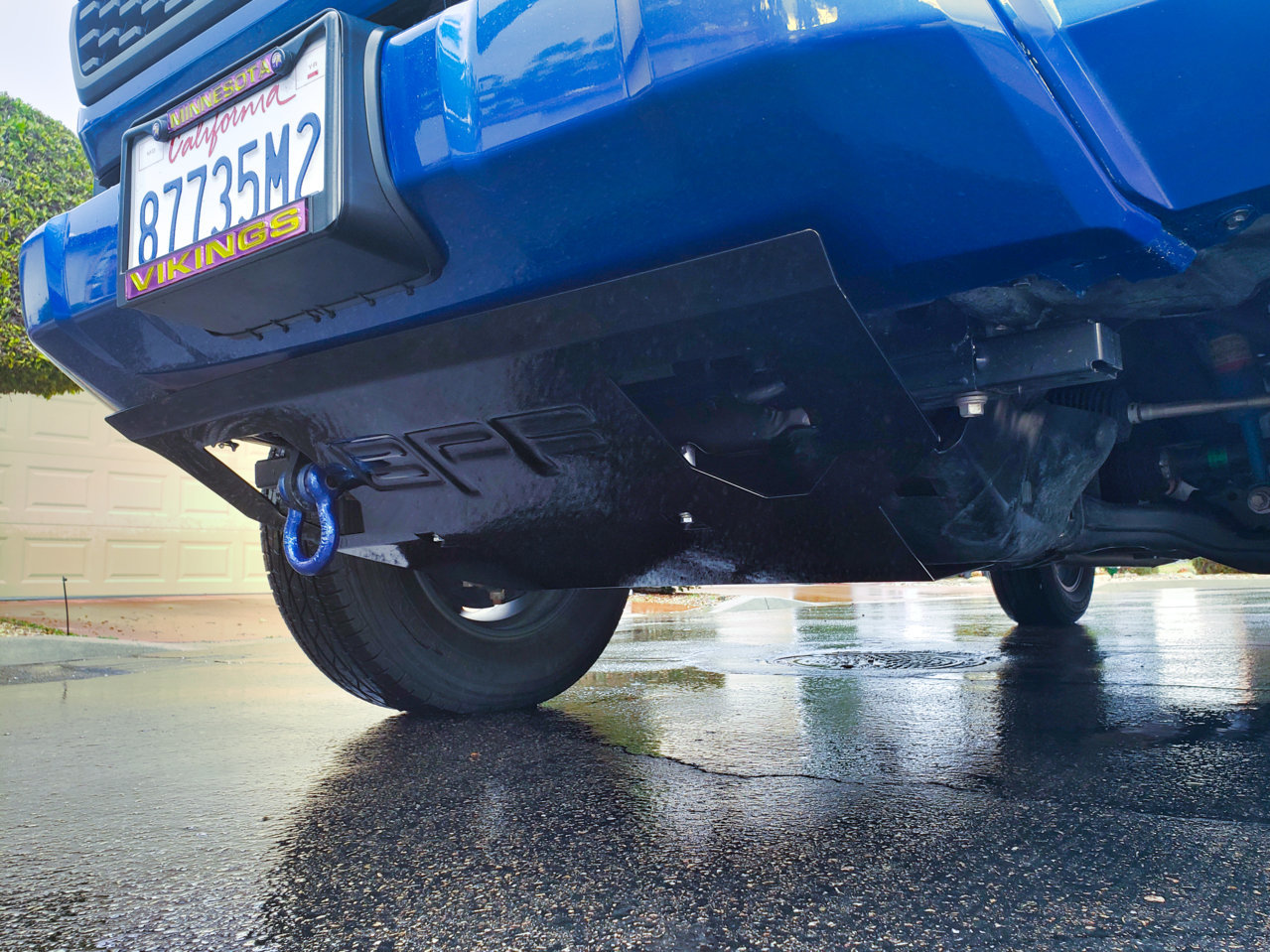

    This is what I did to get it on...
    1) Loosened the rear bolts to help hold up the back to of the skid to help with leverage.
    2) I loosened the factory passenger bolt, but left it intact, to keep the front lined up correctly.
    3) Removed the driver's factory bolt, then put in the BPF spacer and bolt. It went in MUCH easier after just a minute to find the right angle for the screw to grip. I got it in finger tight enough that it didn't slip when I reached for my impact drill.
    4) Getting the passenger factory bolt out now was a bit of a challenge since you have to slowly work it out with your fingers which took some time because of the weird angle I was at, but then the BPF spacer and bolt went right in.
    5) Tightened all 4 bolts nice and snug. 15-20 minutes this time vs 90 minutes on my first try.

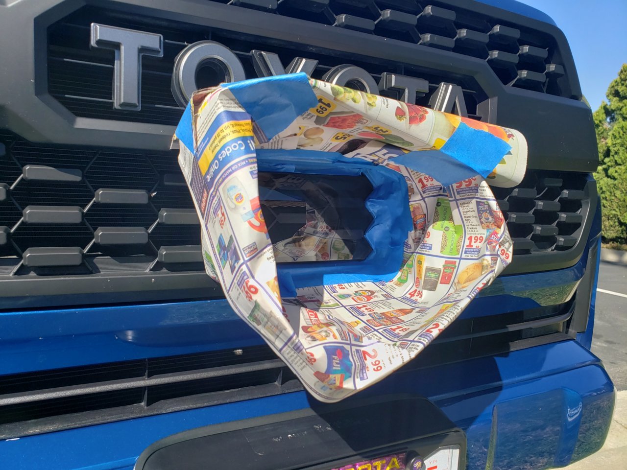

    It was warm enough today to finally start some plastidip projects. First on the list, dipping the TSS garnish to get rid of the sun glare for photos. I'll be able to test it on the way to work tomorrow morning.

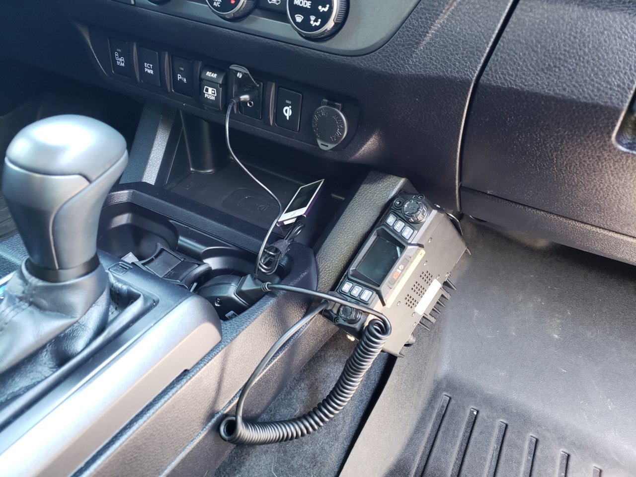

    On 27APR, I had my in-cab ham radio installed. The radio is a BTEC ( Baofeng ), antenna is a Motorola TW-7500 ( no tuning required ), and the tailgate mount is from CaliRaisedLED. The install required the initial hole on the mount to be drilled out to 3/4" and left marks on the top side, so I used PlastiDip to recover the whole thing along with part of the actual antenna mount to minimize the chrome and in doing so, I unintentionally created a weather proof seal between the bed mount and antenna mount ( which is a good thing ). Unfortunately, I can't leave the antenna on 24/7 because it won't fit in the garage if I do, so it will only go on the truck when being used.
    Radio
    https://www.amazon.com/gp/product/B06XK83VRV/
    Antenna
    https://www.amazon.com/gp/product/B077TXL6VQ/
    Tailgate Mount
    https://caliraisedled.com/collectio...lle/products/05-15-tacoma-bed-accessory-mount

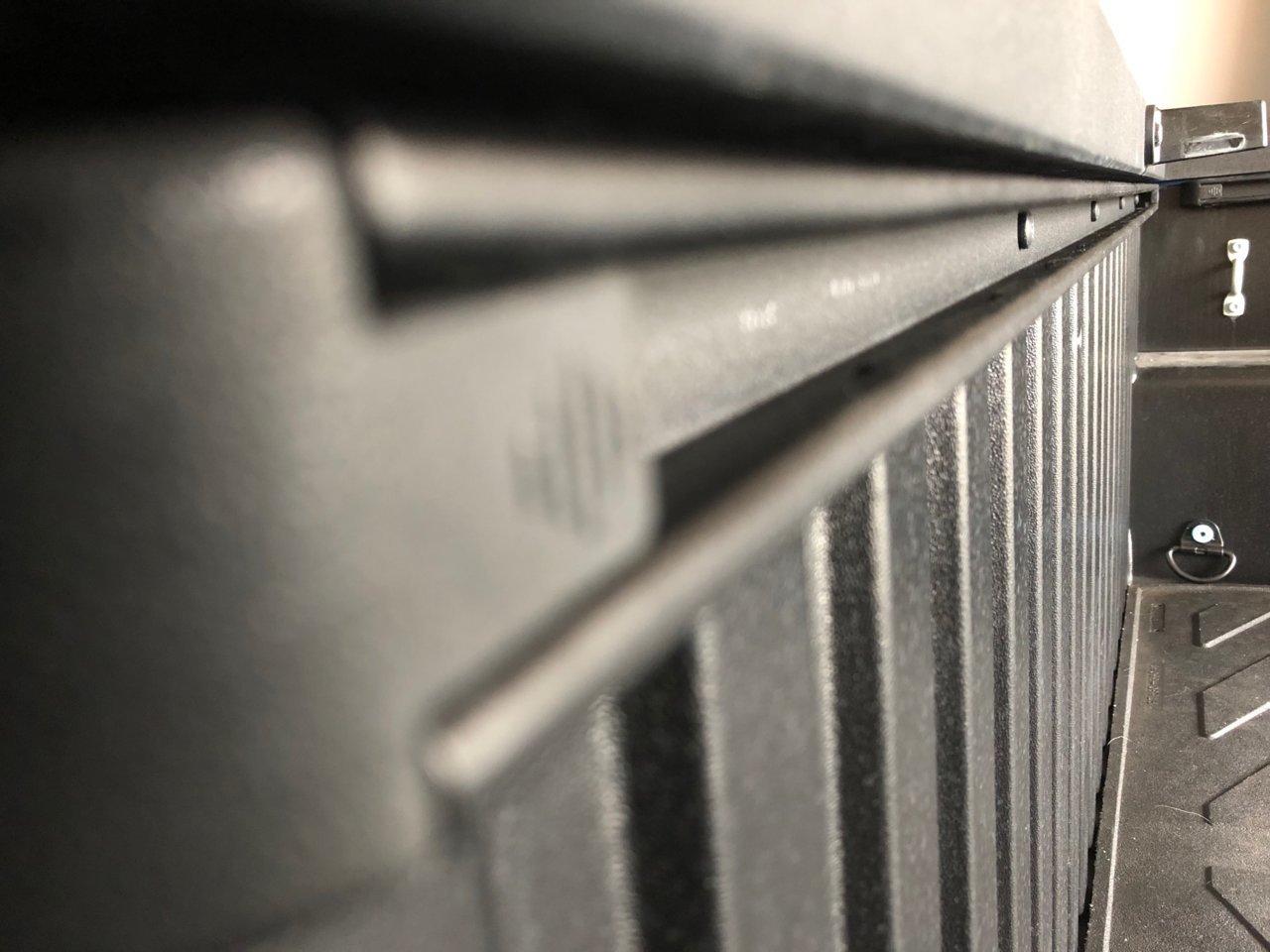

    Odd as it may seem to some, I got the bed front header rail for Azure yesterday for my birthday. YES! My wife called it "the truck's bed thingy."
