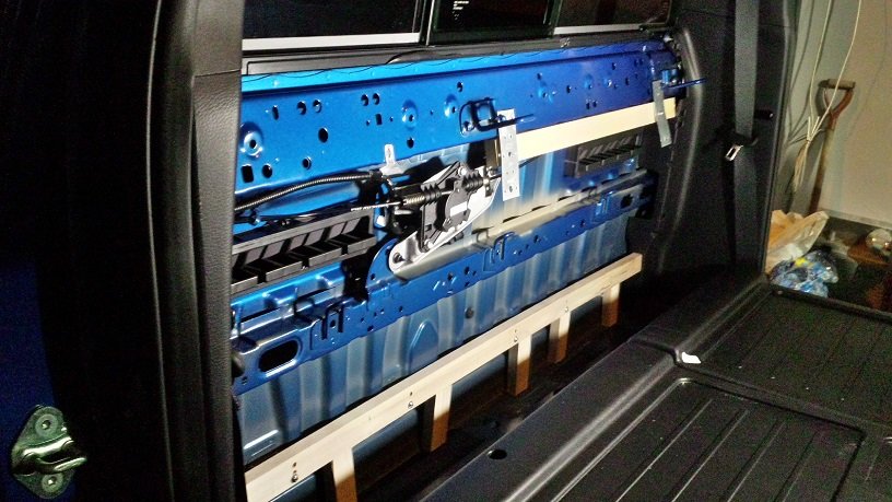

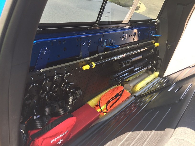

    DIY MOLLE PANEL
    Wood, 16"x16" rigid black plastic pegboard panels, and minimal hardware from Home Depot, hardware from Ace Hardware.
    From Home Depot...
    1) Buy the Poplar 1 1/4 wood slats ( $1.20 p/f - Need two at 48.5") for the base of the main support frame. I chose this because it was lightweight and cheap. You'll also need this to create lower extensions off of the horizontal wood frame to help anchor it against the bottom of the cab and for anchoring the peg board panels.
    2) Buy the 16"x16" rigid black plastic pegboard panels ( $5.97 ea - need 3 ).
    3) Buy a pack of L brackets ( under $10 ).
    ** I would have bought more hardware from Home Depot, but they wouldn't let me take one-off screws, bolts, etc to my truck to check for fit. Ace Hardware did.
    From Ace Hardware...
    1) Metal support brackets to hold the upper wood frame rail in place
    2) Small wood screws to attach the support brackets to your wood frame as well as L brackets.
    3) Misc. nuts, bolts, screws, you discover as you go.
    Install Steps...
    1)
    Remove the rear seats to make this process much easier. Check YouTube for instructions. Please note, that if you unscrew the center bolt holding the seat belt latches in place, you'll notice a hole through the cab to the ground. When I pulled mine out, it undid whatever rust prevention the factory had there, so you'll need something to re-seal that exposed bolt after everything is done.
    2) Use one piece of the Poplar wood to run across the bottom and mark where you need to drill holes to anchor it. I chose to use the existing locations that I could get my fingers behind so that I could hold a bolt in place ( if you have huge fingers, you may need a volunteer to assist you. Drill the holes in the Poplar and make sure you've got the right locations down and if so, anchor it into place.
    3) From the other piece of Poplar, cut 6 pieces that will fit under the wood frame you just installed and allow it to push against the bottom of the cab so that will provide a bit more support. I used some sticky foam pads I had laying around to take up any potential slack.
    4) Remove the bottom wood frame. Using your peg board panels, place them down so you know where the peg boards will anchor into the wood, this is where you'll attach the 6 smaller pieces with the L brackets.
    5) Re-install the entire lower wood frame and make sure it's nice and sturdy.
    6) Moving to the upper frame now, remove both bolts holding the center seat hook anchor thing in place. Remove only the left bolt of the one on the right side.
    7) Drill holes three of them that are large enough for the seat anchor bolts to go through them. Same for the other two brackets that you'll use to the left of the motor, but drill out to the size you'll actually be using. Additionally, keep in mind that if your peg board anchor points don't line up with an existing holes in the metal brackets, you'll need to drill them.
    8) For the spots you've chosen to the left of the motor to use as anchor points, open the holes as necessary to allow your bolts to grip what metal you leave in place.
    9) Attach all of the upper metal support brackets to the back of the cab and the wood.
    10) Attach the peg boards using the little tabs they have to help you keep them aligned. You may need to trim off some of the tabs if you're so inclined like I did.
    11) Use peg board hooks as necessary to organize what gear you need. If necessary, you can cut slits between holes to for gear with straps.
    NOTES: Do as much pre-planning a possible to reduce trips to the hardware store. When drilling to open the two upper holes in the back of the cab ( left of the window motor ), you'll need to use smaller drills to systematically open them up and on the last drill bit, you shouldn't drill all of the way through, but just enough to allow the bolt to grip what metal is left. Be very careful so that you don't suddenly push through and drill a hole in the rear of your cab!
    You're done!
    I'll admit, this was WAY more labor intensive than I expected, but for less than $75, it fits my needs extremely well since the goal was to be able to hang some long camera gear ( monopod, tripod, and light painting pole ) . I used paint I have from other truck projects to paint the wood black and the support brackets and bolts to color match the truck.
    If you plan to pursue this yourself, feel free to PM any questions.
    Test for fitting the frame, Not the entire setup, but enough for a proof of concept to see if continuing was worth it.
    Finished install view from both sides.
    A couple of example close-ups.

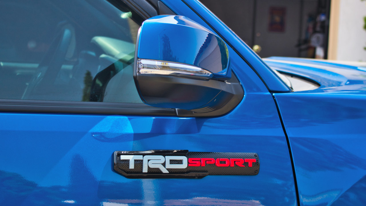

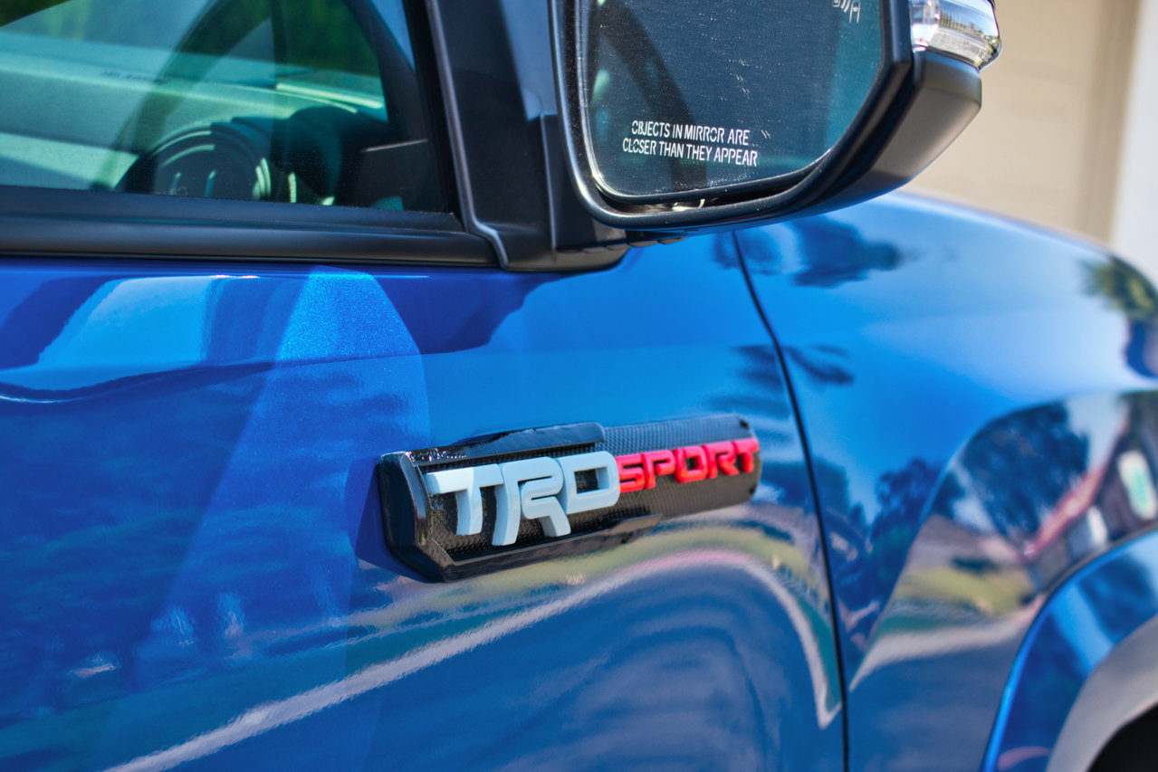

    Removed the Tacoma front door badging to make room for the Faux TRD Sport Emblems. My wife was initially skeptical, started to like the as they were getting painted, was leery of removing the chrome Tacoma badges, saw how the TRD Sport Emblems looked and said that the chrome Tacoma badges aren't going back on. LOL

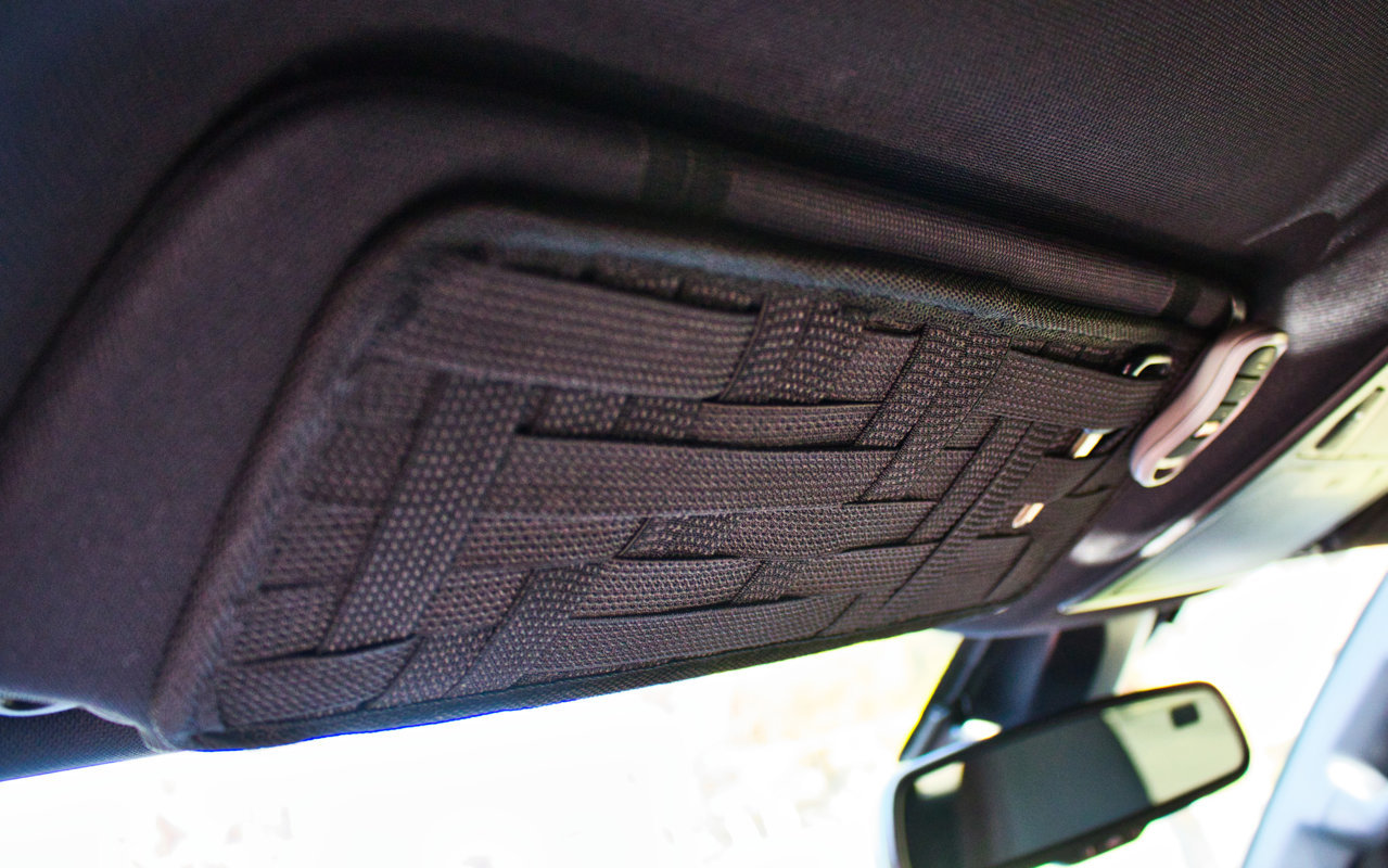

    And Amazon delivered the Sin Visor organizers today! One for each side.IMG_5252.jpg

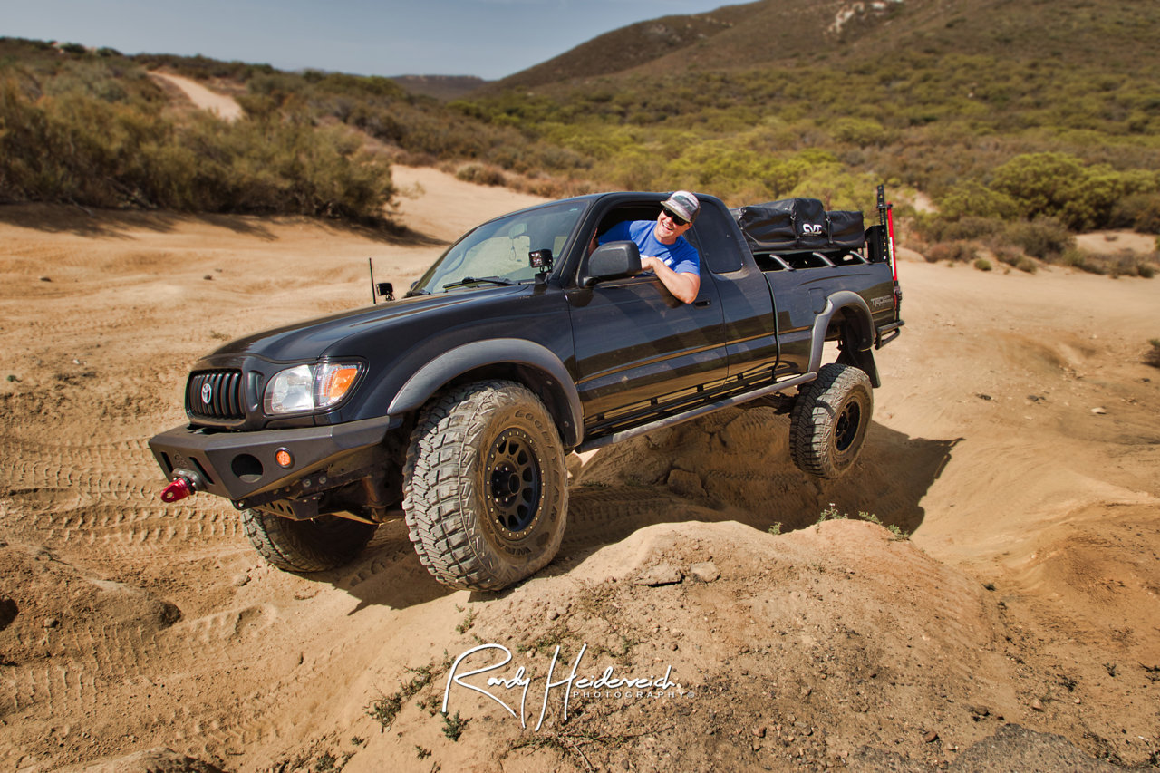

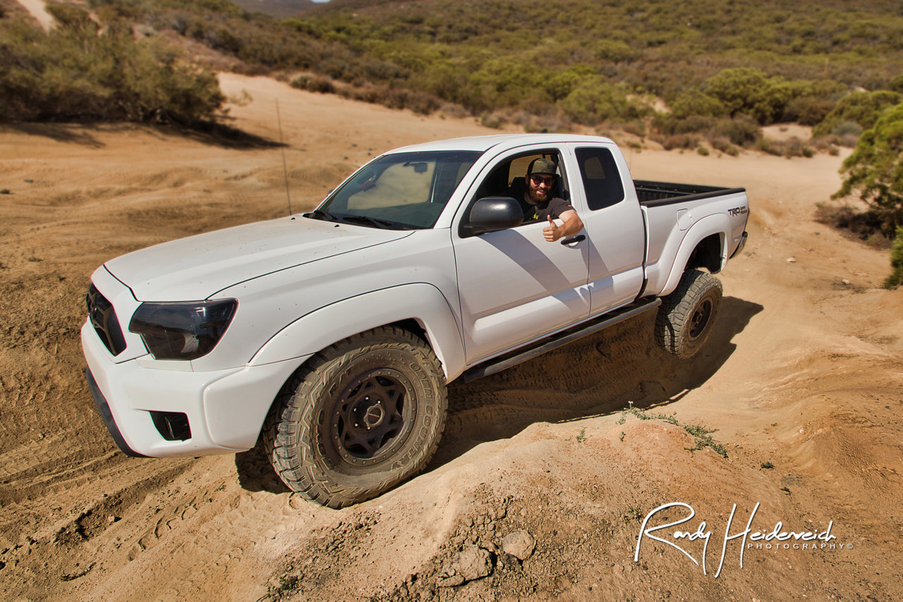

    Photos from my first trail run led by experienced off-roaders @Prayn4surf , @desertjunkie760 , @eccracer104 , and @erice with photo credits to myself and @erice . Yup, a 3rd Gen out gett'n dirty with the 2nd Gens and there were far too many good photos to choose from, so I just chose a small sample. Huge thanks to all for the crash course...
    2018_JUL_PineValley12.jpg 2018_JUL_PineValley10.jpg IMG_5433_Small.jpg IMG_5463_FB.jpg IMG_5497_FB.jpg IMG_5507_FB.jpg IMG_5547_FB.jpg
  11. Aug 2, 2018 at 8:03 AM
    #31
    Prayn4surf
    Prayn4surf 20 minutes late
    Jan 6, 2017
    #206776
    5,982
    Socal
    2004 Tacoma xtra cab
    Great shots Randy! And a good looking truck! Dont forget the two first gens that went with ya :boink: lol.

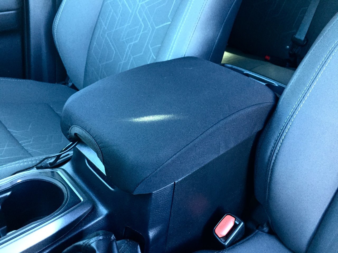

    Added the Issyzone center console protective cover today and I have to admit that it’s far better than I thought it was going to be. It’s fits like glove and is comfortable.
