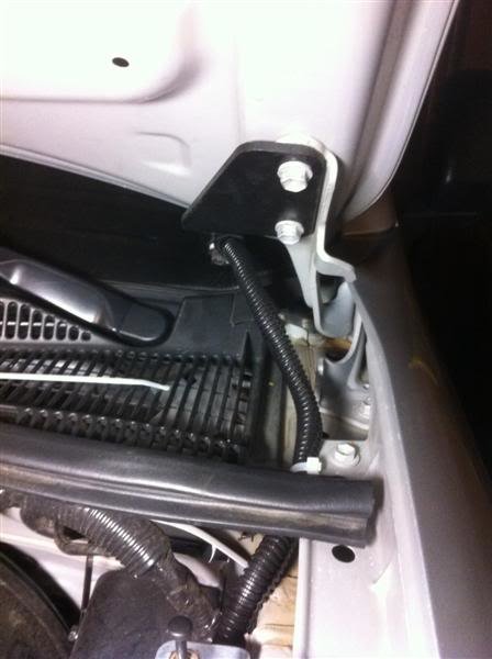

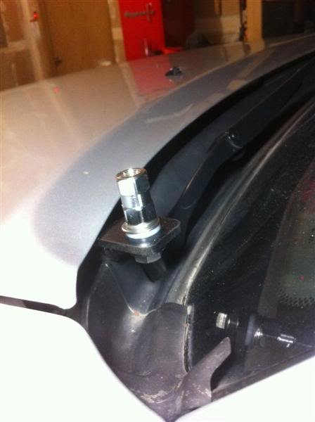

    Alright, I've pretty much convinced myself it isn't even worth mounting my CB antenna on the bed of my truck and want to put it on the hood hinge instead. I've been looking at relentless's hood hinge mount and I'm thinking about trying to fashion something similar. What size plate do you think that is and do you think it could be cut with a sawsall. I also have a side grinder that could be used on it also, I'm just not that comfortable with it. I am guessing that is maybe 3/16th or 1/4 and I believe it needs to be steel plate.
    Pics stolen from Relentless fabrication "other products thread"

    i would say that is approaching 3/8 plate, could be off on that but if you look at the size of the bolts holding the hood on and reference that to the plate i would say that about it. although 1/4 would be waaay strong enough and would also make it easier to cut and work with. a sawzall will do the trick bu you better bolt your vise down on this one. also you dont have to cut very close to your lines as you can easily grind either of those size plate to the lines to make it easier cutting them.
    or just make me a template and give me a lil bit of time and ill make one for ya.

    I think I'll stop by Lowe's and see if I can get a plate while I'm going to get the hamburgers, hotdogs, buns, chips and other stuff for the meet tomorrow. I need to go crank one of those bolts off to see if they will be long enough or if I need new ones.
    I might take you up on that offer. We will see what I can do tonight.

    I think it's 3/16th. I bet you could use 1/8th and be fine. I used sheet metal for mine and it's not beefcake, but it's strong enough. Different antenna though. The fiberglass antenna may weigh a little more. Trick is cutting it just right so that it doesn't interfere with the wipers. I went through three uh... design modifications... and a lot of expletives and several beers making mine.

    Dude you could probably dremel that even, you may have to run through a couple of cutoff wheels, but I bet you could do it without too much trouble...
