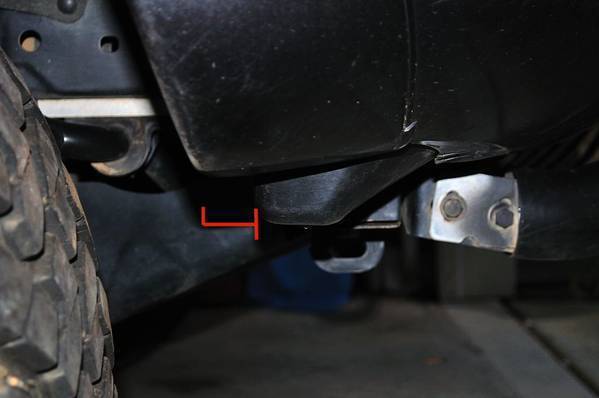

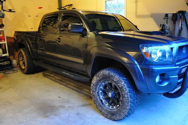

    So started checking fitting on Paul's 285/65's on my truck with a 2" lift.
    Here is the overall look

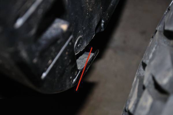

    Just to fit them turning stop to stop with no flex will require to cut the rear of the front fender flare like this.
    And I believe I can move the front part of the inner fender like this.
    I moved it in this picture, just didn't drill a hole and remount it.

    I had to trim a bit more then that with 285's and 3" lift. If that's all you trim, they will scrub whenever you hit a bump while turning.

    Yeah I'm pretty sure that will only be the beginning. I put my regular tires back on it for now and I'm going to look around at how much other's trimmed. I only mounted the one side and didn't take it out of the garage. No since flexing it any until I can at least drive it with no flex.

    I trimmed a shit ton and still rubbed while off roading. I would hit the body mounts on the passenger side.

    Springs settling I bet. How worn are these anyway? A new set would add some size. I do like the side bite tread on these.
