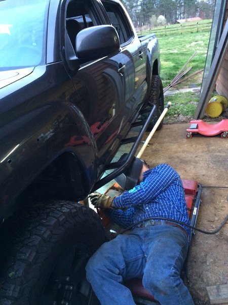

    No gussets?

    Nah, not necessary. These suckers are strong. I haven't actually seen any with gussets, have you?

    Yep. About 99% of the ones made by vendors are gusseted at the legs. Keeps them from bending in to the body panels with a good solid drop or hit.

    Can't say I've actually seen one up close from a vendor then, just pictures and haven't noticed. I really don't think this Schedule 40 pipe is going to have any trouble haha.

    Sch 40? Not dom or hrew? Interesting. What's wall thickness on that?

    Off the top of my head its 1 1/2" Schedule 40 that measures 1 7/8" outside diameter and wall thickness is a little over 1/8"

    Ok correction, he does plan to add gussets to the square "legs" tonight. I didn't even consider it, but apparently he did haha. Thanks for keeping me in check though @TacoFMS he is waiting to add them after we mount because with the 4" mounting plate the gussets will have to be partially mounted to the frame and partially mounted to the plate.

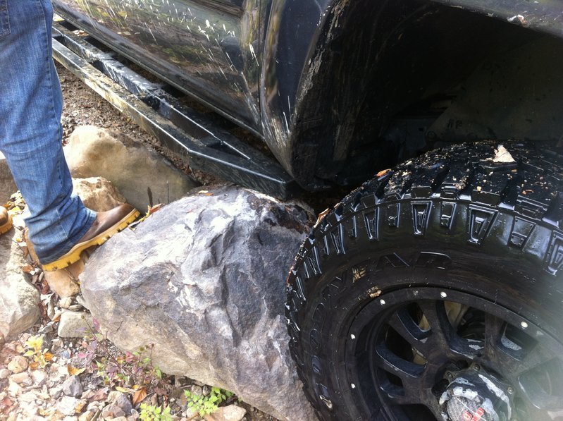

    Just found this old picture this morning.

    You had to switch over to 24v to get over that didn't you?

    Do you like the square tube and did you make that yourself??

    I think I was able to just turn left and gas it off. You can see the rock falls away to the inside, so it didn't to much. That corner of the slider was holding the tire off the ground though.

    I love the look and platform they make. They are Demello RockCrushers. Not sure how it will all come together with the round hoops that are on my bumper, but we will see.

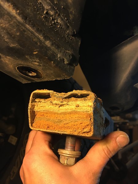

    So I may actually lose weight in my bumper swap. I have a geological study available in my end cap.
