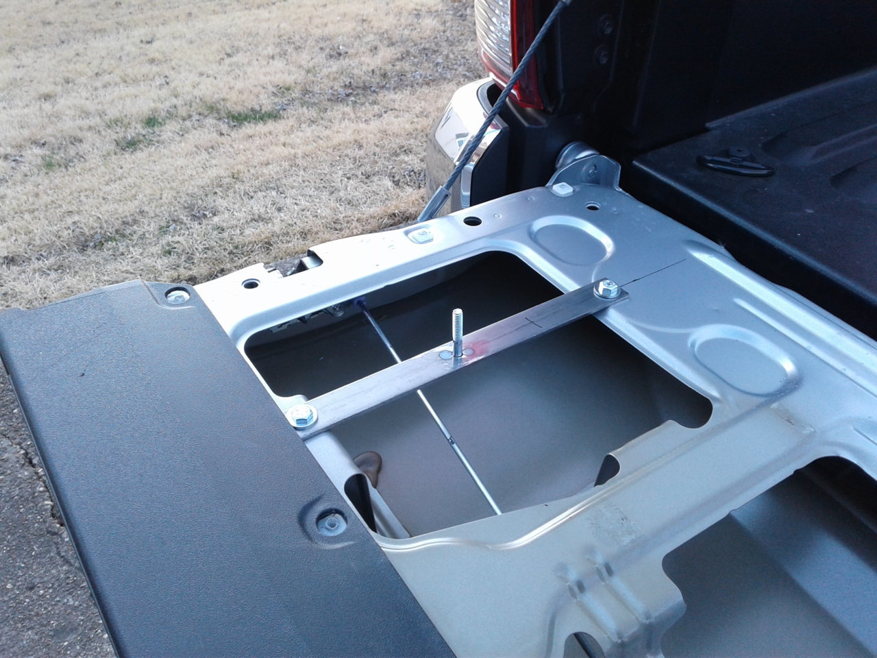

    I've been wanting to do something similar to this since I no longer have my table on the rear bumper swing arm. Do you have any photos of how it is actually attached? Very slick setup.

    Yeah I took off the panel and bolted a piece of flat bar across the void, welded a bolt to the middle, and put a hole in the panel. You could probably use double nuts on the bolt if you did not have a welder.
    Thanks
    Zim
    EDIT. I have to tell you I'm not a fan of the kitchen permanently mounted to the tailgate. It's very hard to get things in and out. I think I'll change the permanent bolt into a threaded deal. I'll have to tap the hold on the bracket to fix that.

    Thanks for the photo, I'll have to give this some thought.

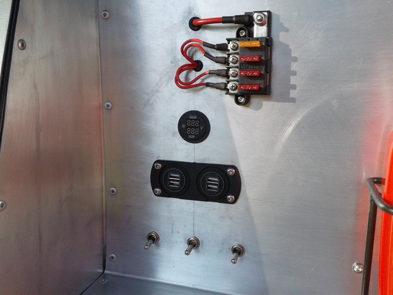

    Adding some charging stations to the front driver door.

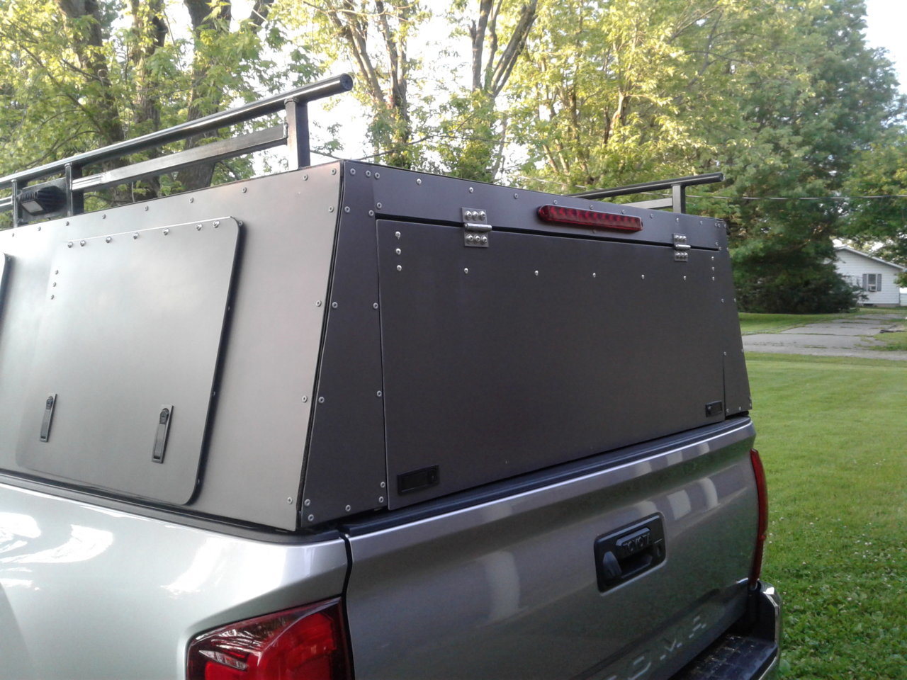

    I like the rear door, but as stupid does, I mounted the latches too low, and now I can't put on the edge molding across the bottom. I'll fix that later, not a big deal.

    Nice topper. Looks like you caught a tree? The top corner next to the cab.

    No lol. That's a over excited welding clamp that was....over excited. LMAO. I don't have a sheet metal brake that is 6 or 8 ft. so I had to pull the corners in a little. Just too much pressure. I'd change the design on the next one to fix that issue. Thank you Sir.
