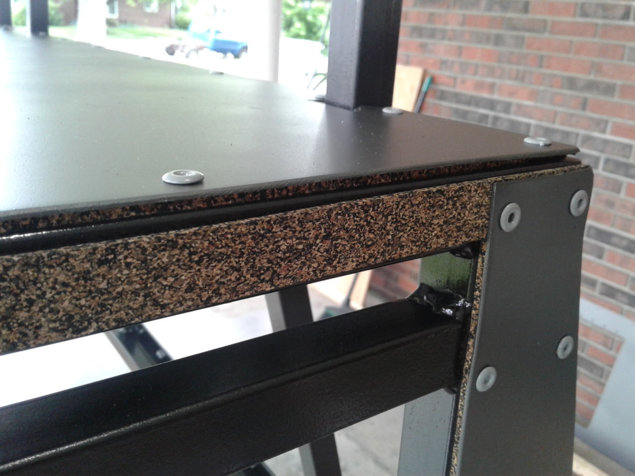

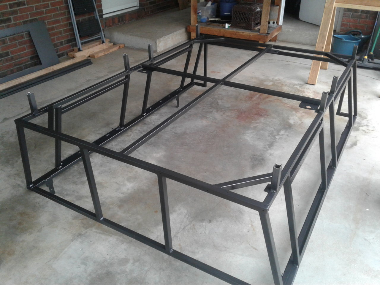

    Way off. I'm a whole different world as I wanted 4 doors.
    This is as close as it gets. 1x1 tube with alum sheet over cork gasket.
    And I have some leaks. I will disassemble this winter and finish some welds, and seal it. I really never thought I could get this waterproof. I just don't have the machinery to do it. This was built with simple hand tools, and a home made sheet metal brake.

    Looks pretty darn good.
    I’d probably go with a butyl type of seal on anything that doesn’t move.

    That box looks good! .060" aluminum is some pretty tough shit, especially if it's 2024 or the like. It's nice to see some well executed craftsmanship on here. 20 year A&P here.
    Those rivets look like hollow aluminum, is that true? Any issues with loosening? If the frame doesn't flex I would assume they are up to the task of holding the panels down, just asking because they would save a significant amount of $ over a structural shear blind fastener like a cherry-lok on some in bed boxes I have an idea for with a similar panel on frame kind of design.

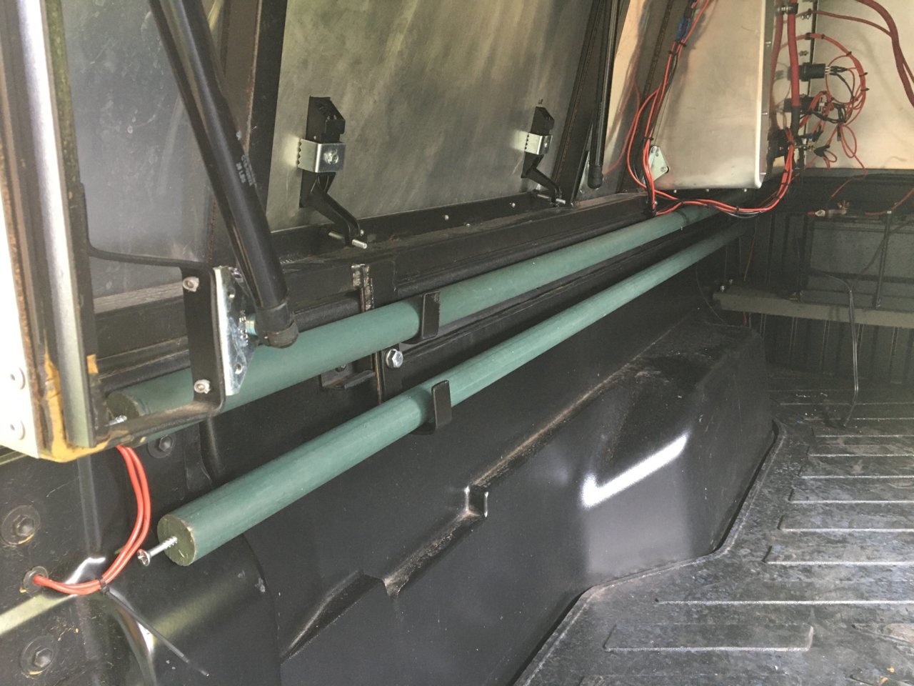

    Got tired of the tarp poles rolling around. Made some brackets, done...lol

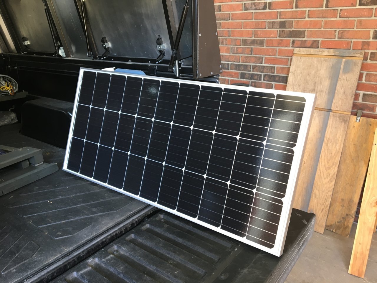

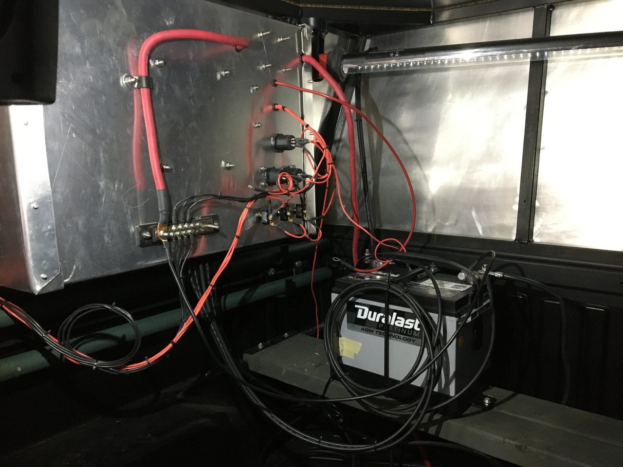

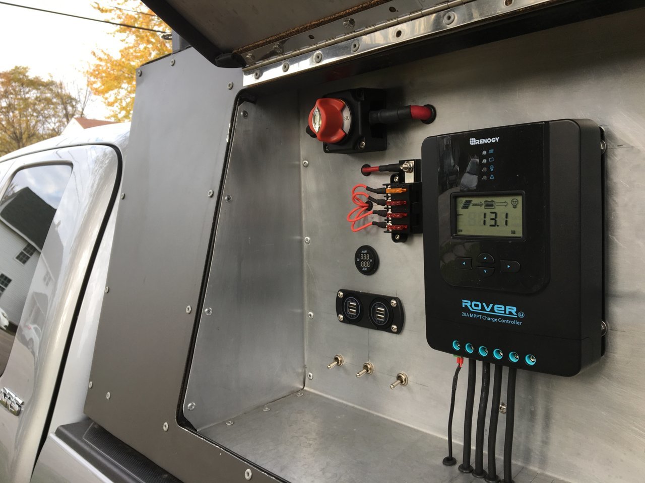

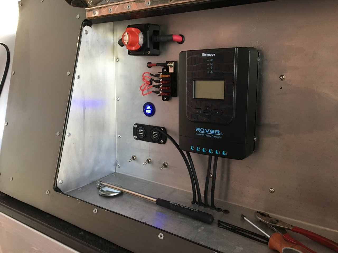

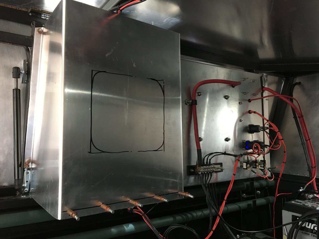

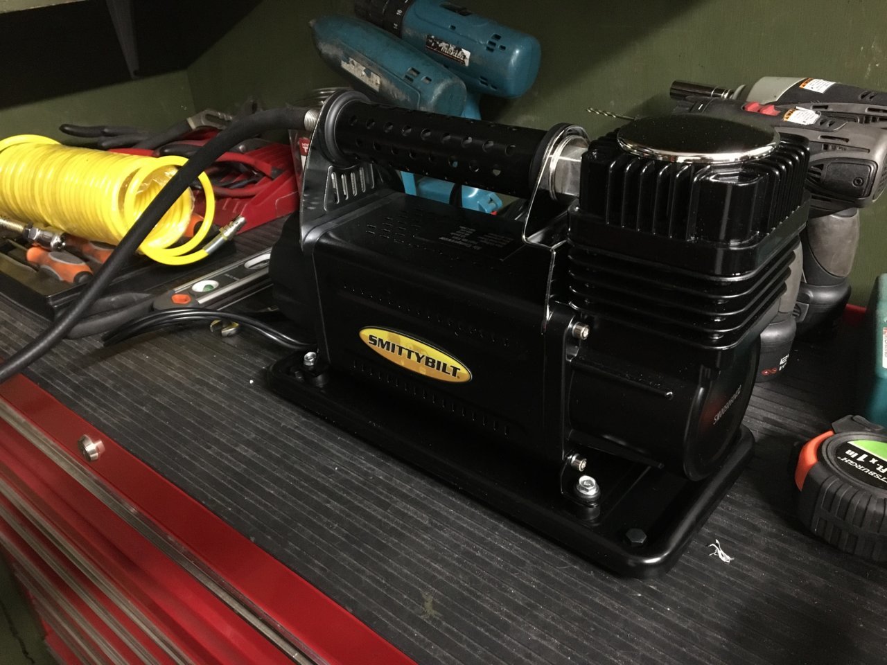

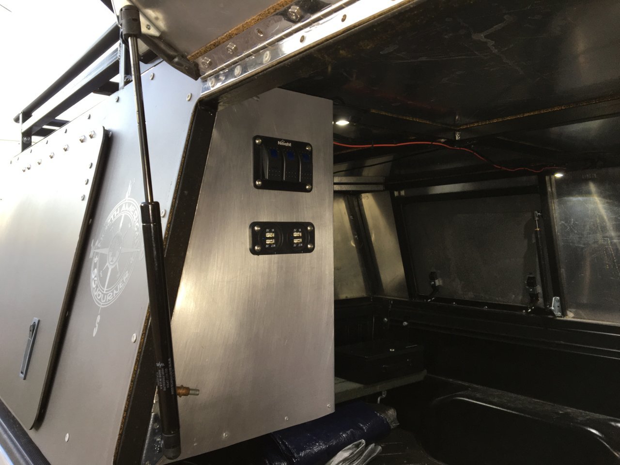

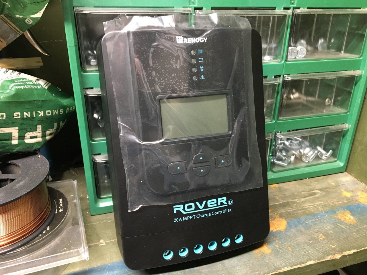

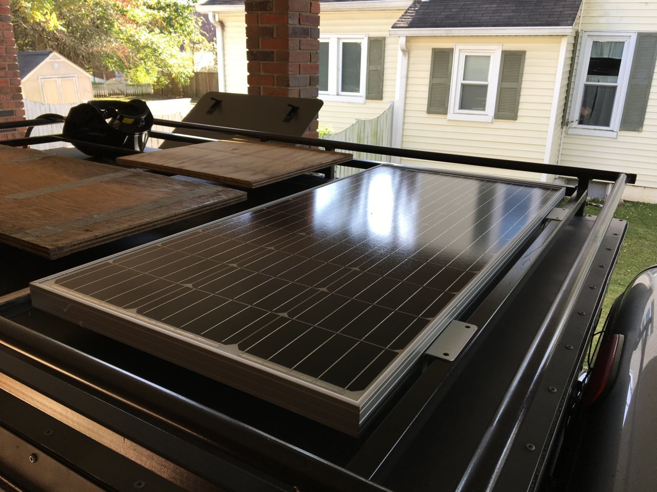

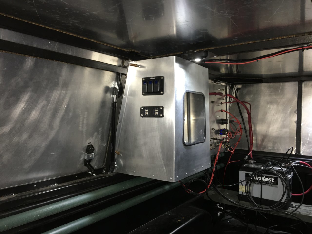

    This is a major pic download. Descriptions to follow as I get some time.
    The best way to explain this set of pics is to mention the onboard air system. I wanted to put in some interior lights, and switches to operate the compressor, both in and out of the truck. I also installed a solar panel, controller and wired the whole thing together. I'll add more as I can.
    Zim
