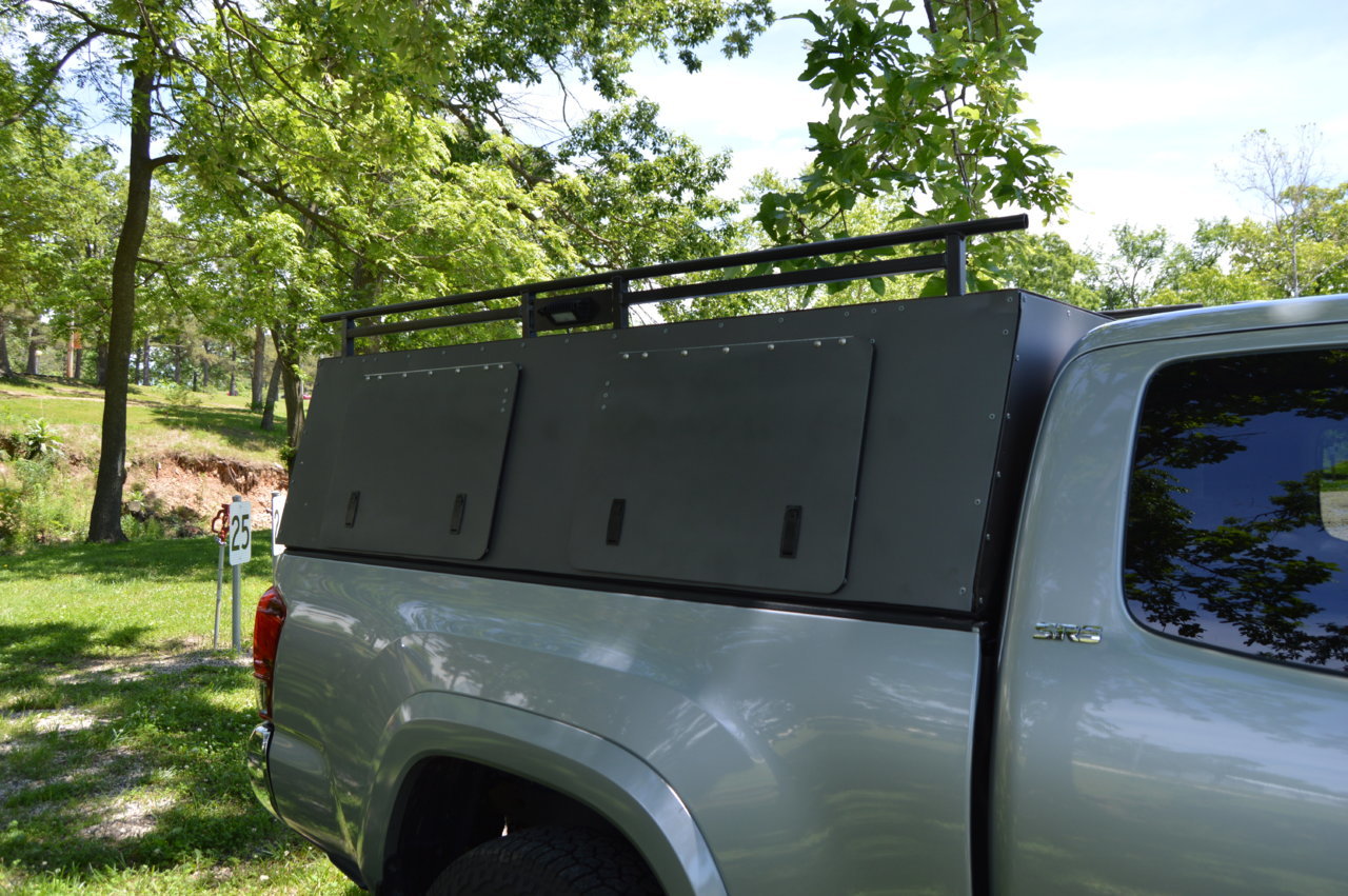

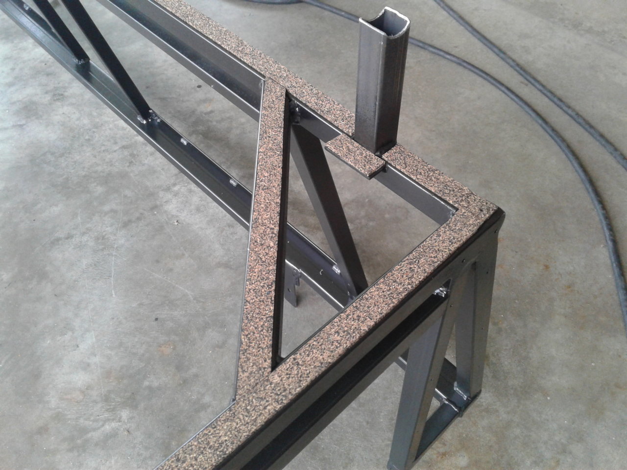

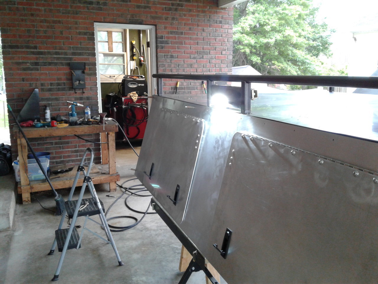

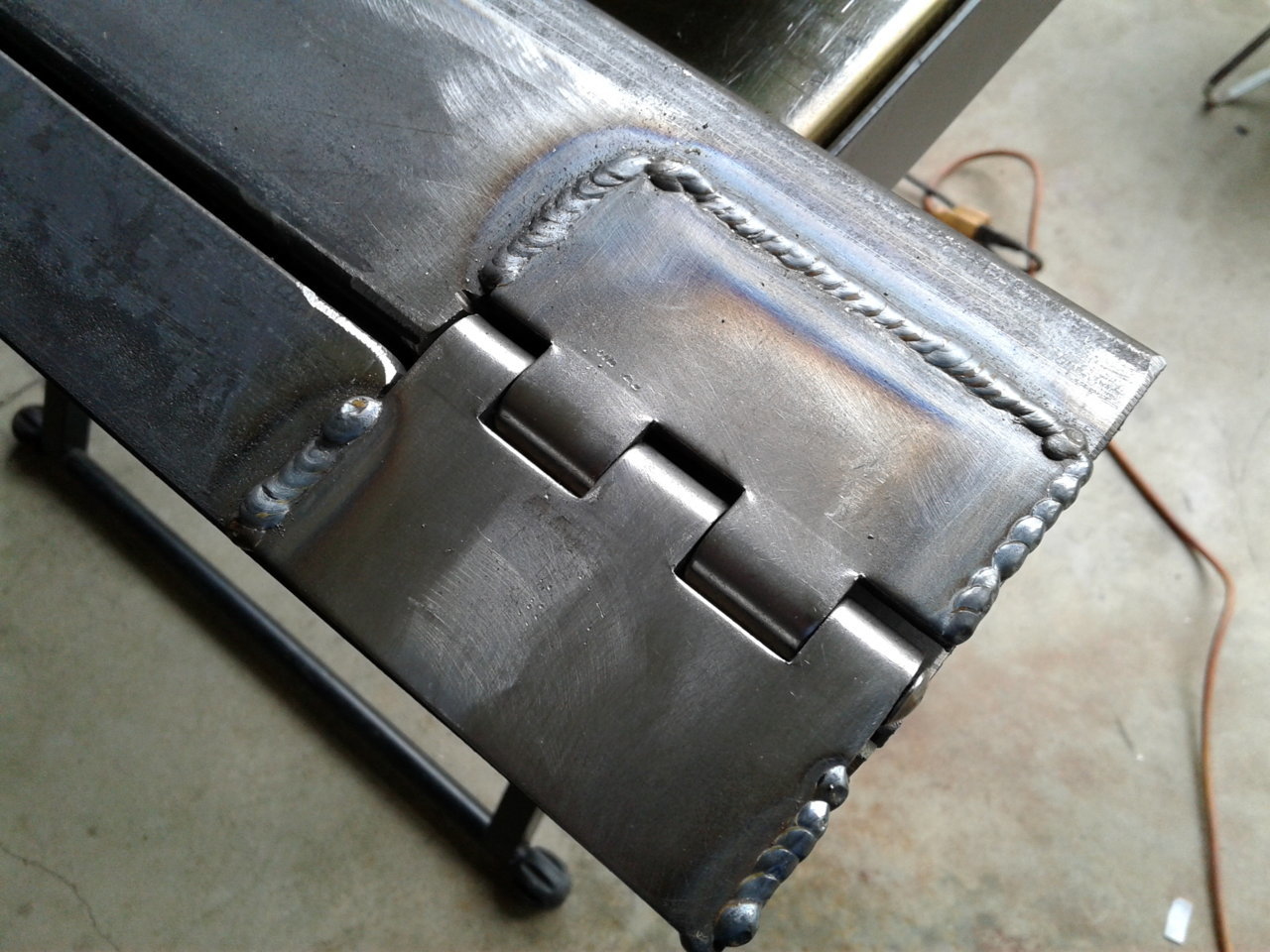

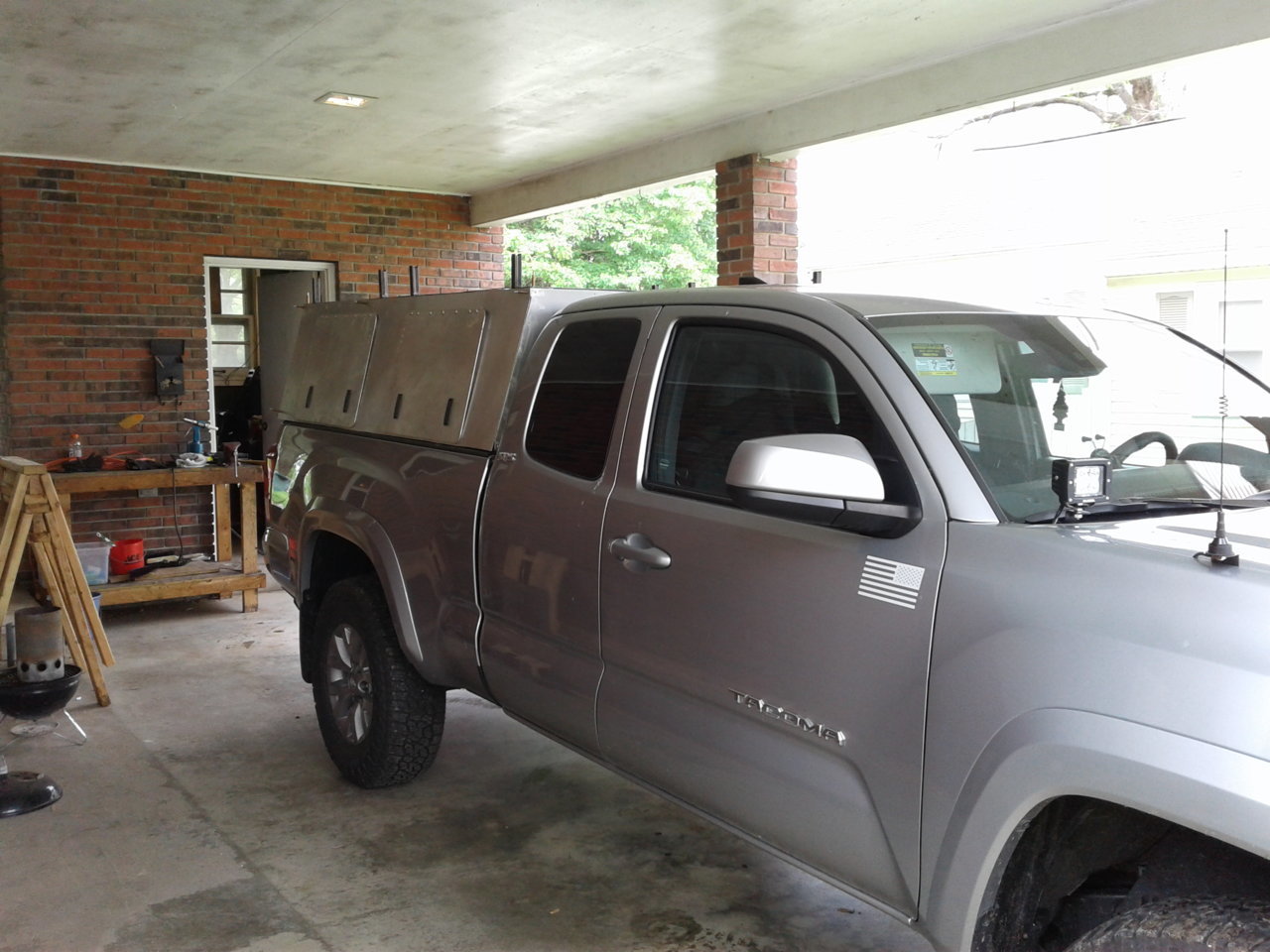

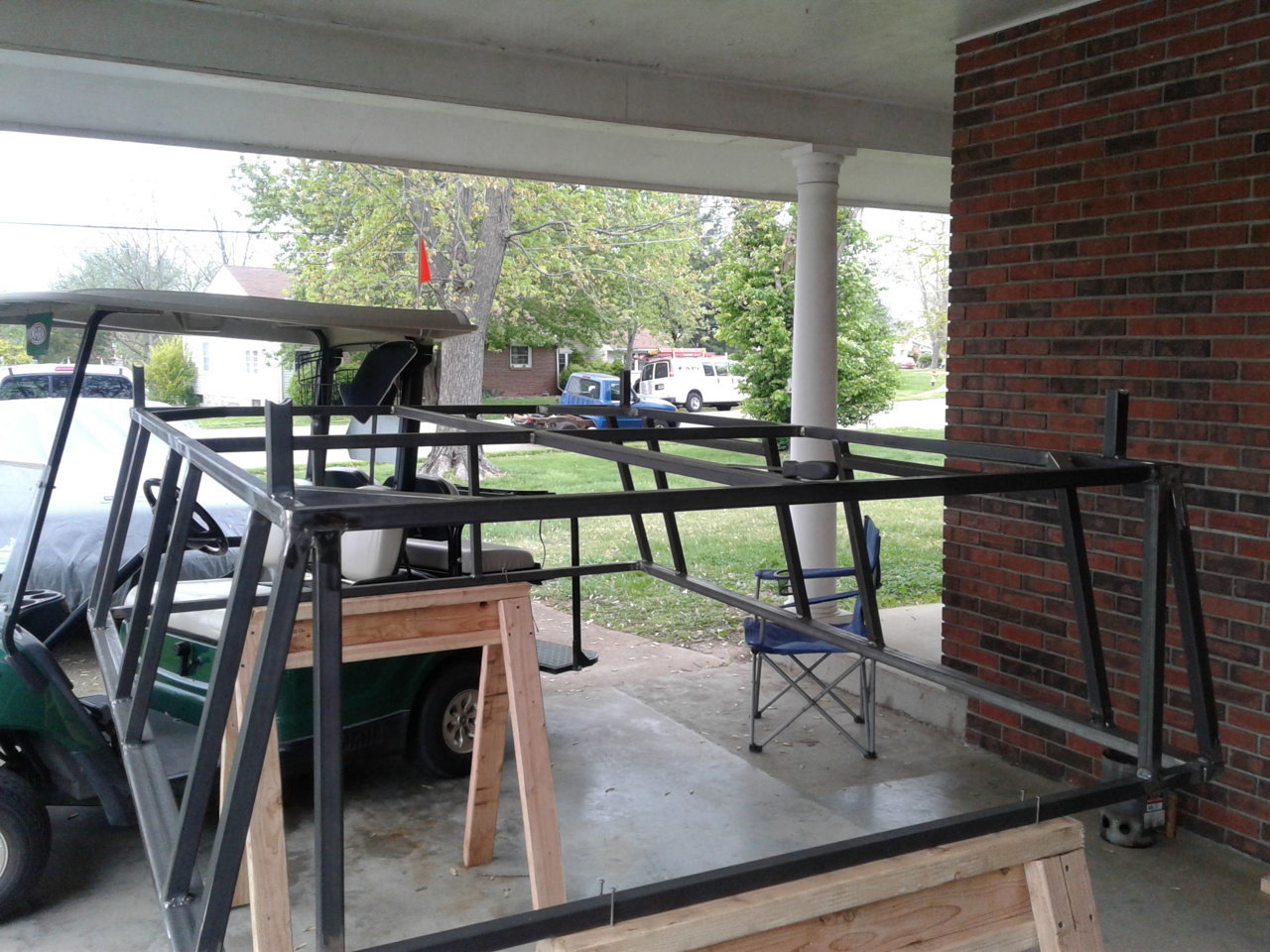

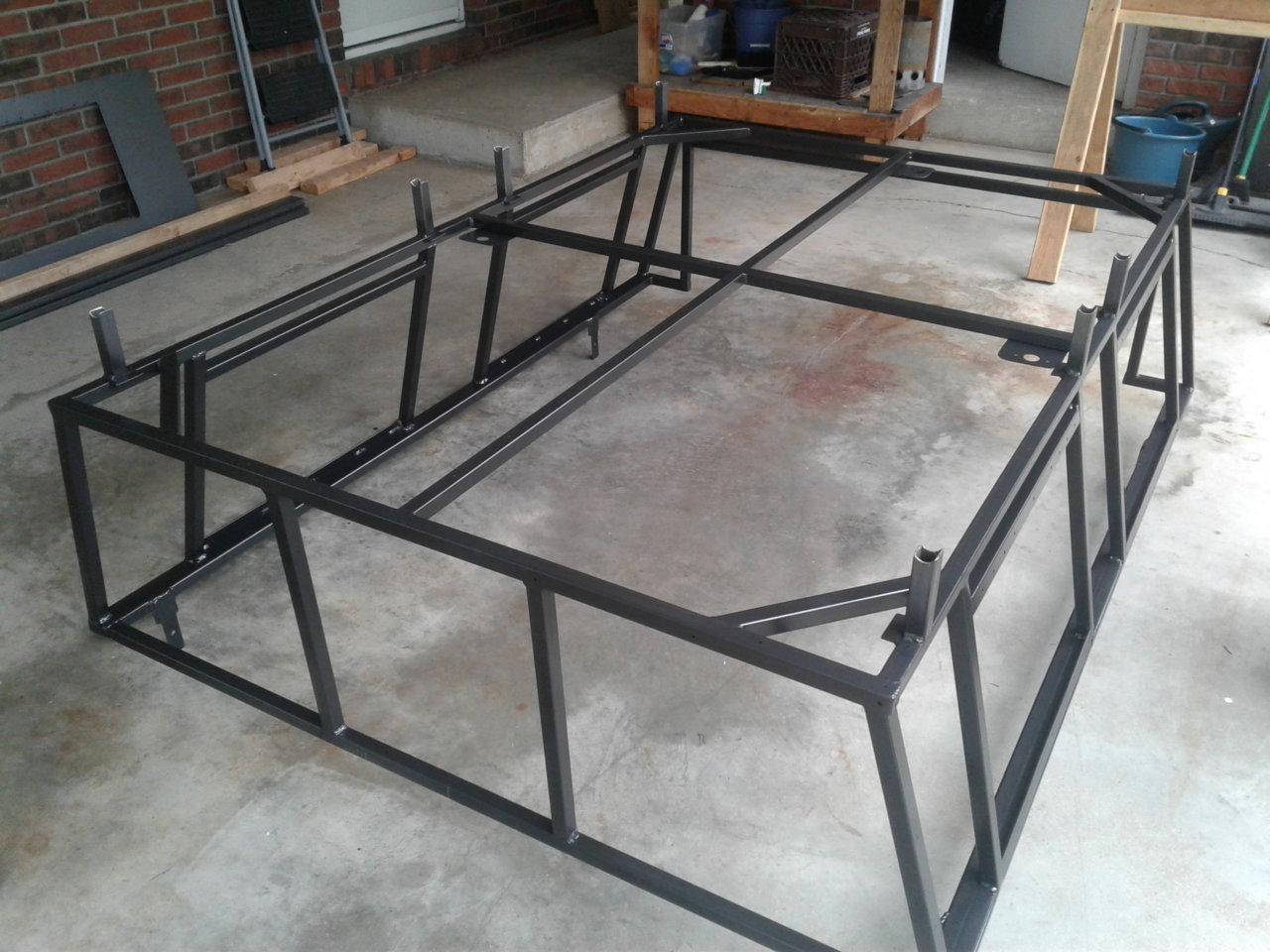

    I did some basic things like phone mounts, IPAD mounts, and then started on a camper shell. I'm about 80% done with that as of today and I'll update as I go along.
    I started with a 1x1 frame sitting on 1x2 base. I'm using @Ripcord's build as a inspiration, if I needed one...lol. He did a outstanding job.

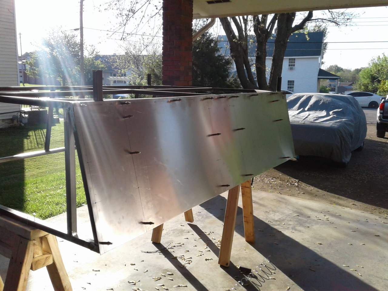

    Instead of using composite sign material, I'm using aluminum, .060 for the shell, and 1/8" for the doors. There will be 4 doors, 2 on each side, and the door in the back. I'm not doing any kind of tent at this time, but I have several cutting tools should I decide to alter it...Lol

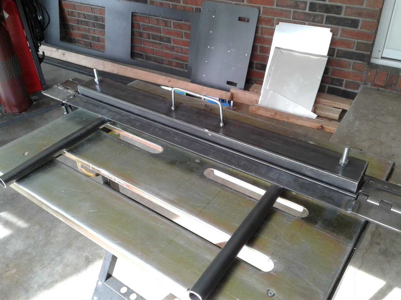

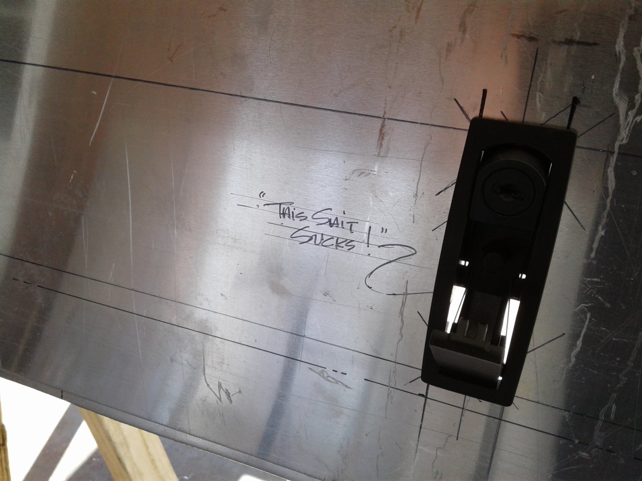

    So I don't have any cutting ability for long cuts. I have some shears (milwalkee) that do well on sheet metal, but cutting a straight line is a challenge. I have to do lots of grinding, sanding, filing and cussing. It's a lot of work.
    I love these latches....they are knockoff's of what @Ripcord used but they are nice.

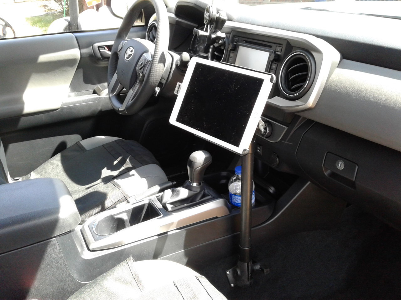

    This mount is for the IPAD air, and I have another for the 7th gen. I have Gaia maps loaded, and have the Dual GPS unit as my SAT finder and plotter.
    This system is awesome as even without phone service, you have GPS capability.

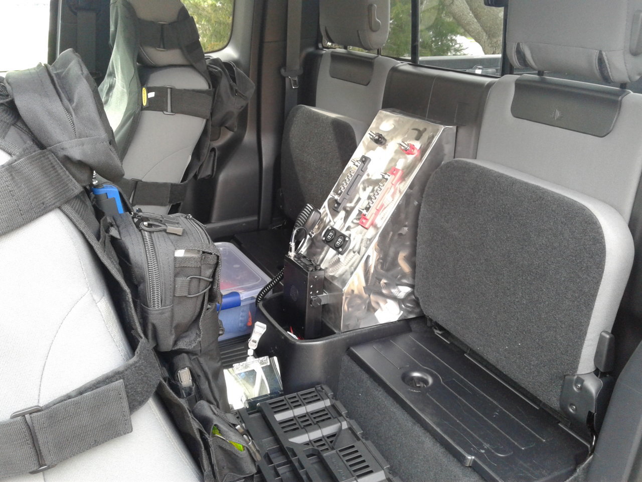

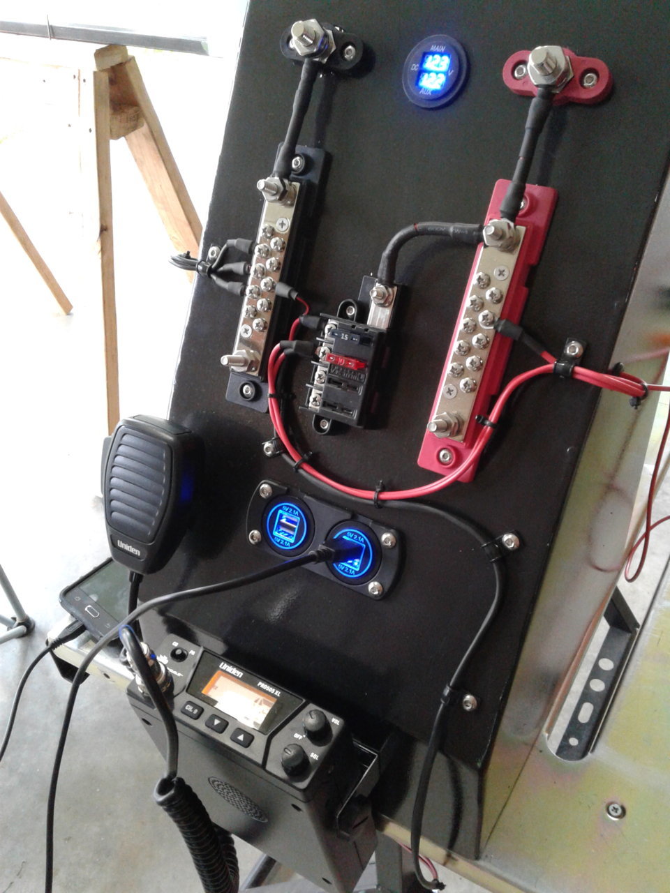

    I also will have some radio's so I started with the CB, and decided to put it in the back. I don't need all that stuff up front so I fabricated a "command center" lol.
    So the above was a mock up, and I've changed a few things, but I love the setup. It allows me to get the junk from the front to the back, and the mike still reaches. Will also have charging stations, voltage monitors, and a fuse setup for the cabin electrical.

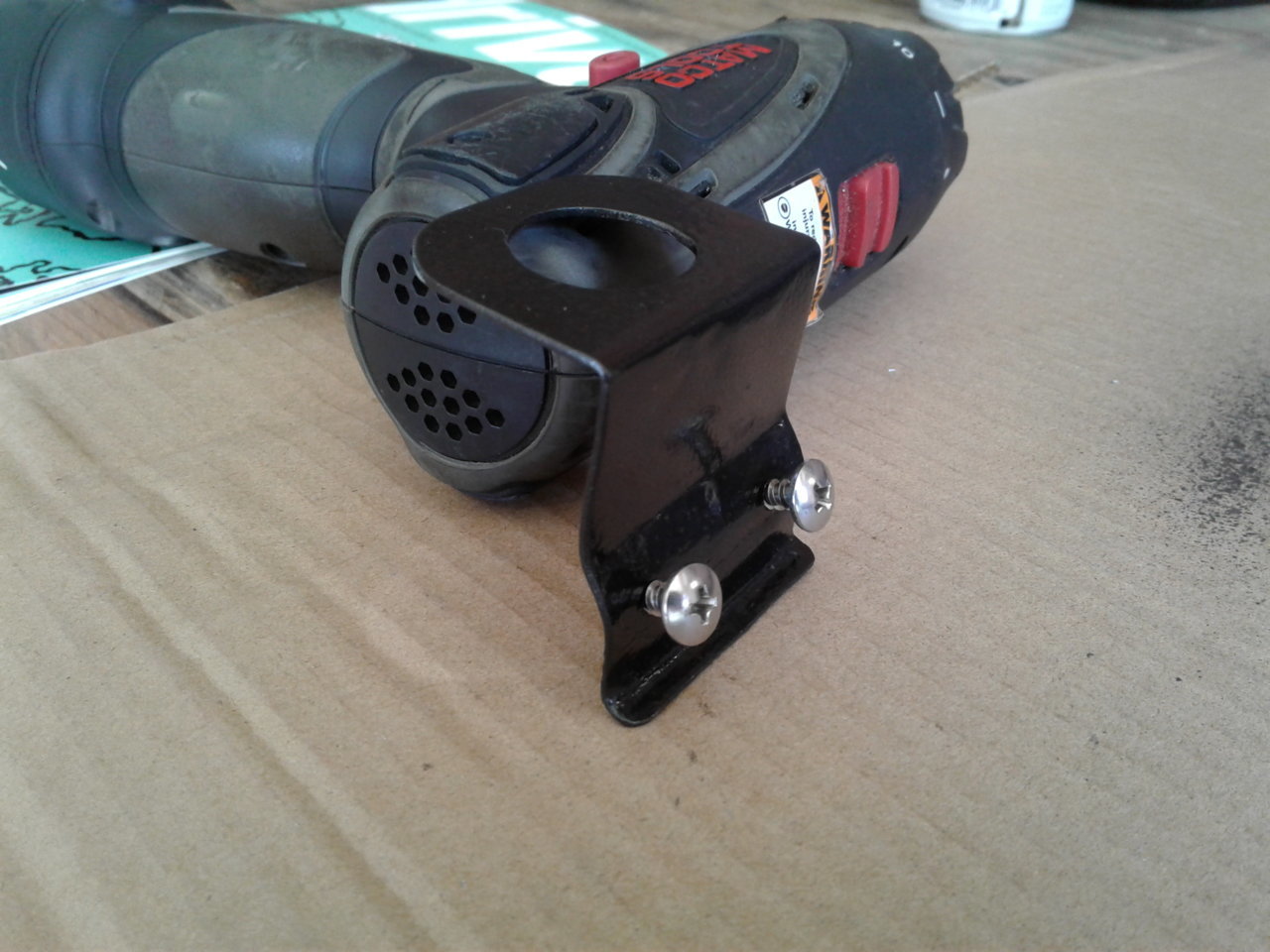

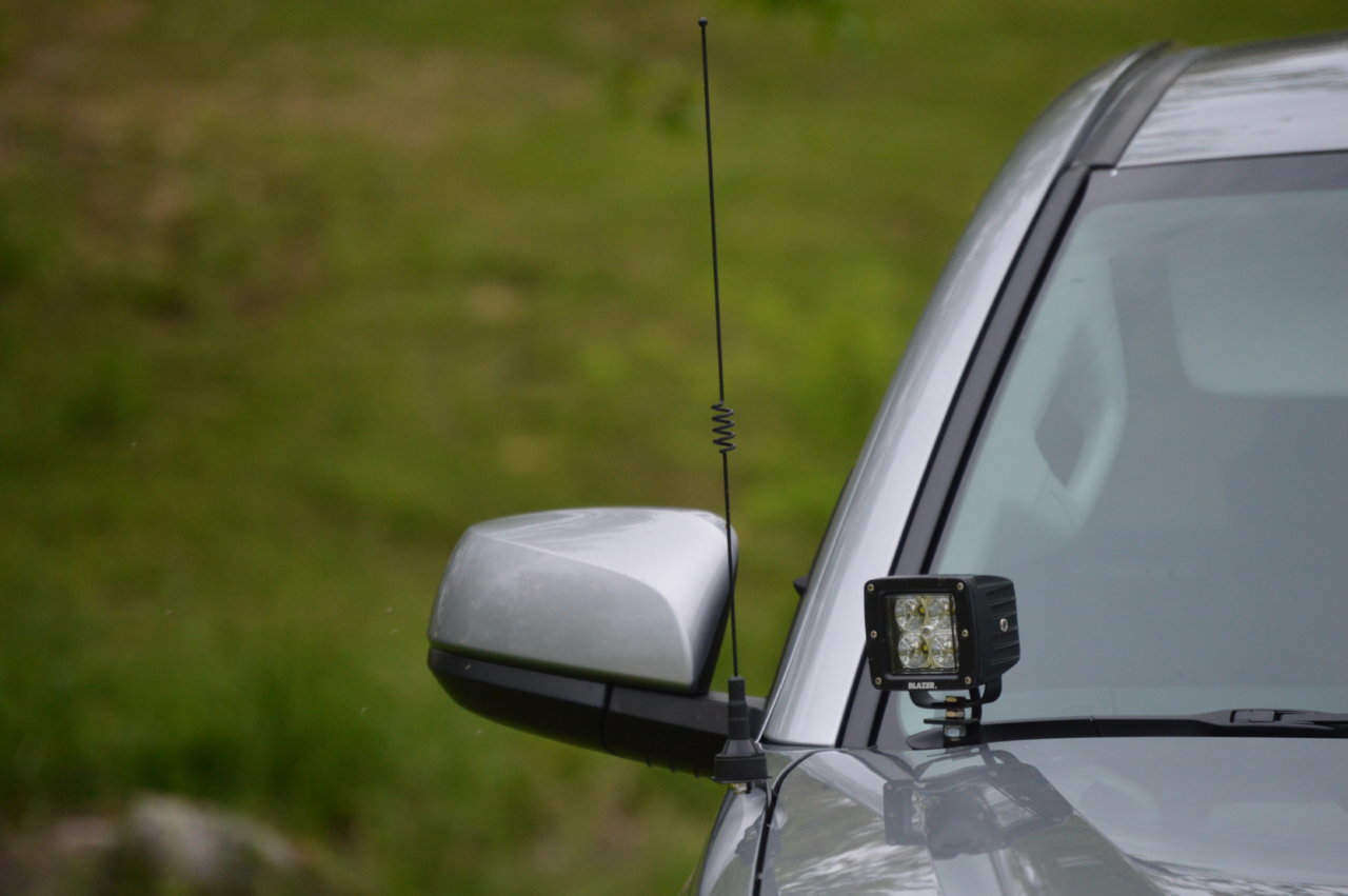

    I fabricated the antenna mount and went for the fender mount. Looks good, keeps the thing low. We will see how it works out.
    Got to have the flag, after all, this is America!

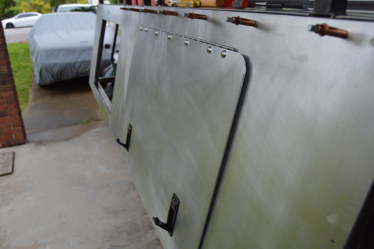

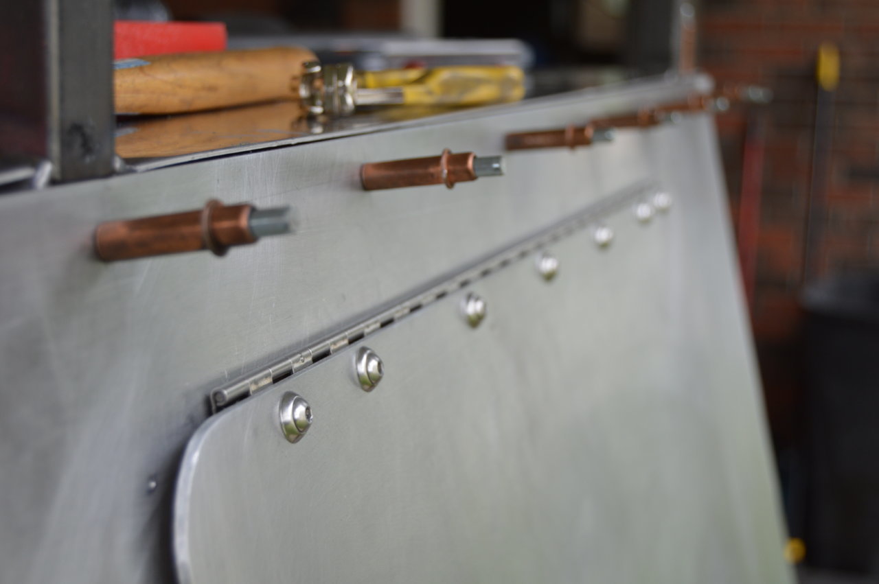

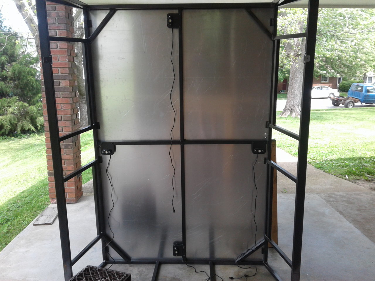

    Finished the 3rd door today. Each door is about 3 hours of labor. Aluminum sucks...lol

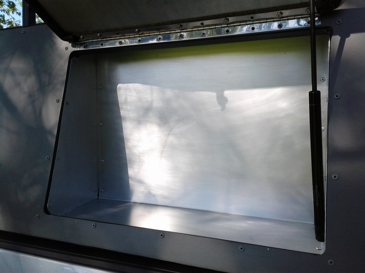

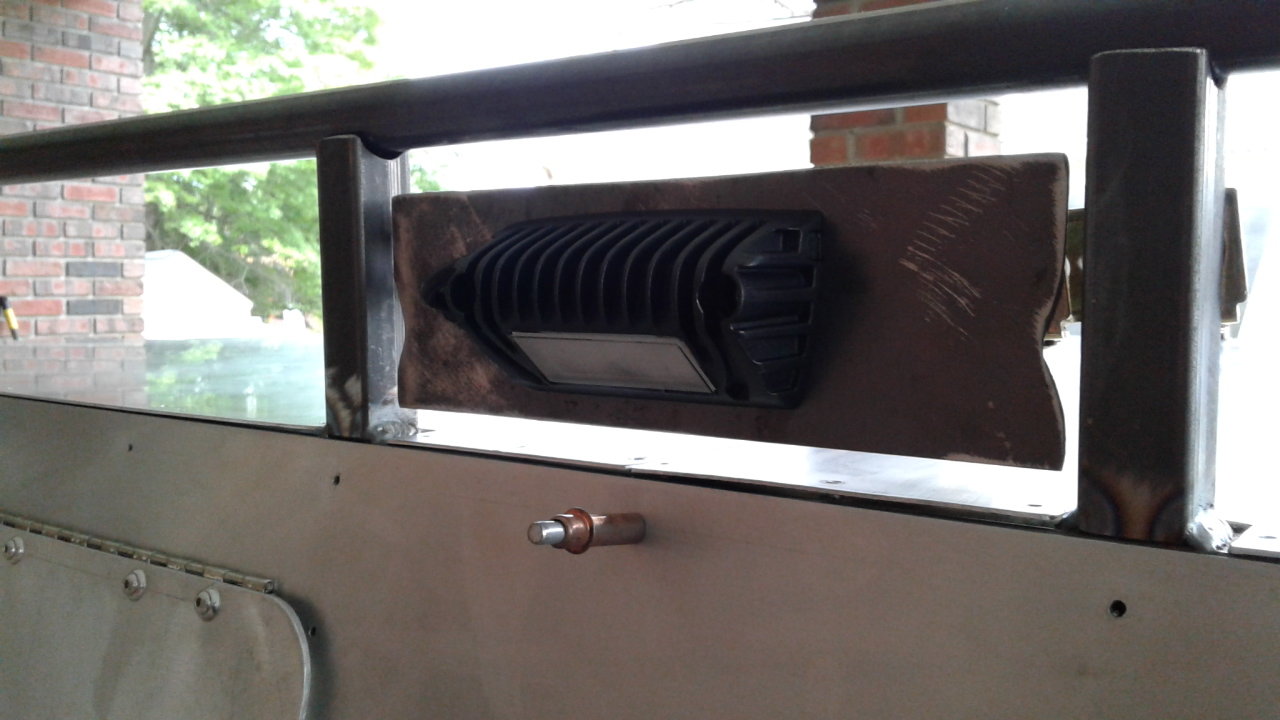

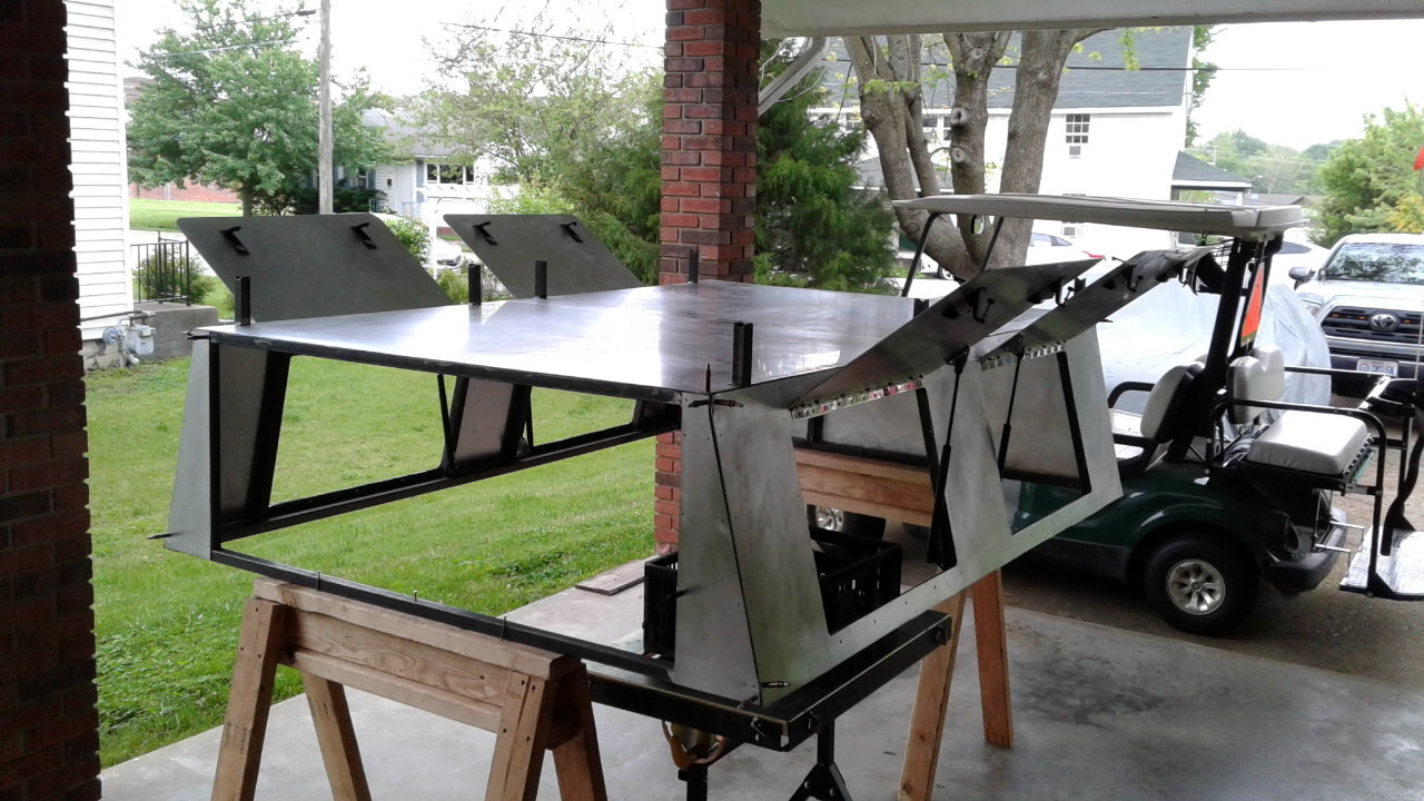

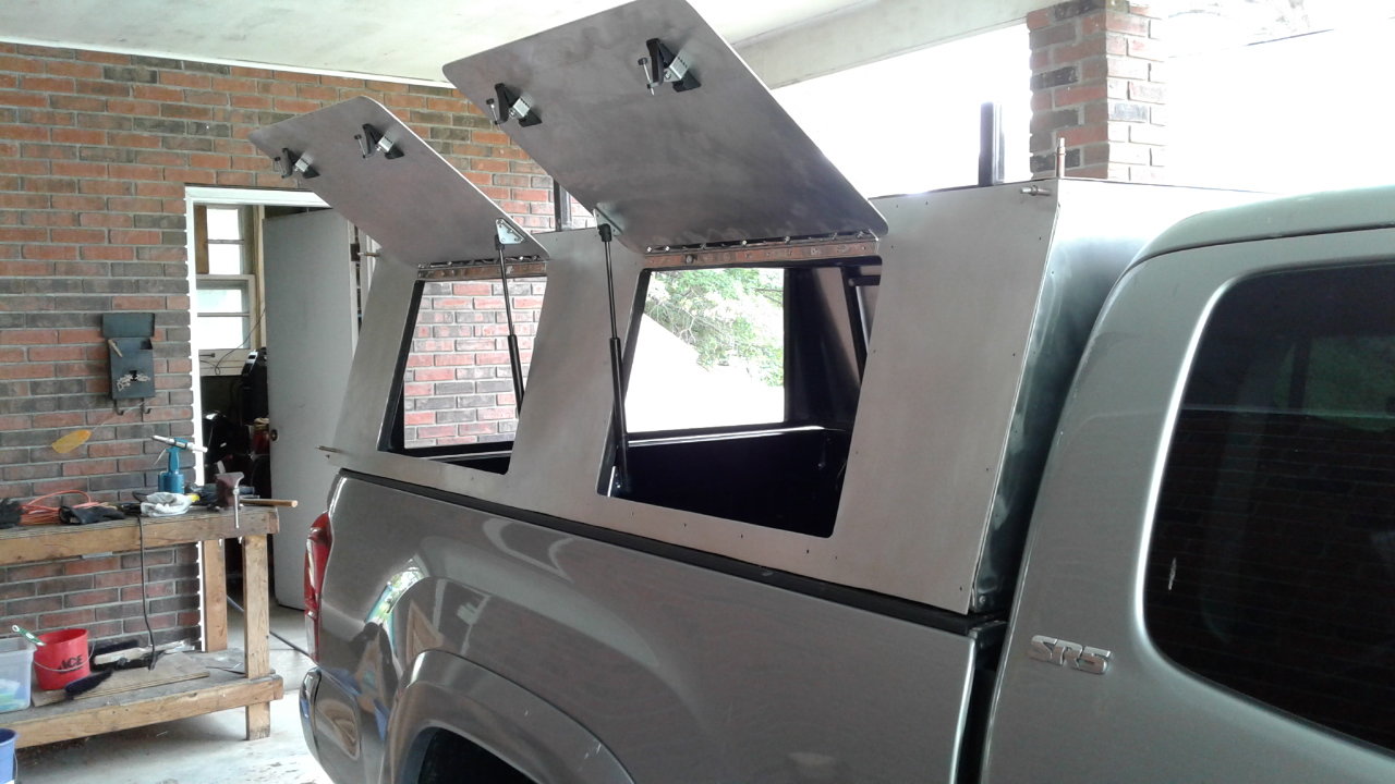

    This is the winged camper..lol. Looks like it's going to take off.

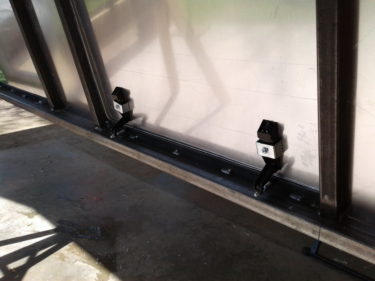

    All doors have shocks, one each for now. I'll add another shock to each door later if I decide to keep this design, or sell the whole thing and build another..

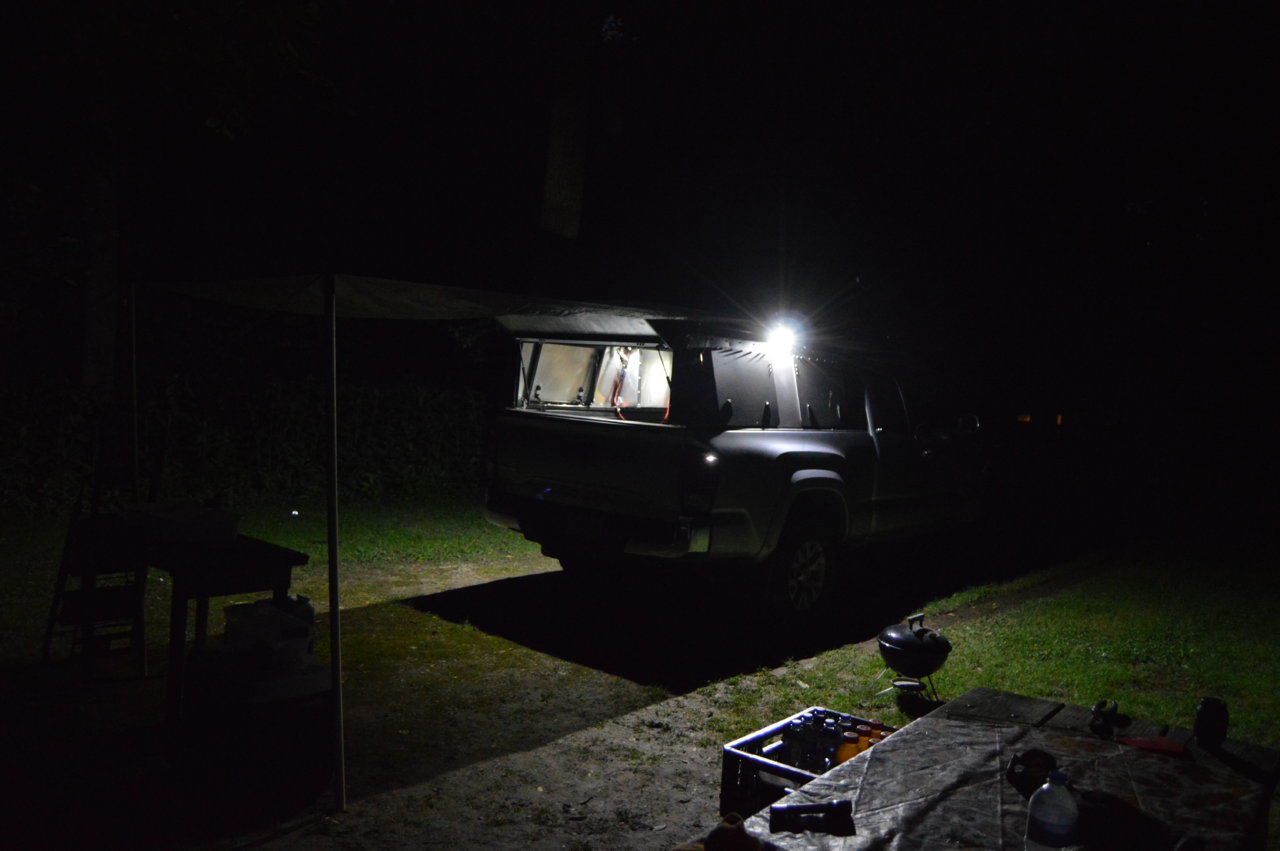

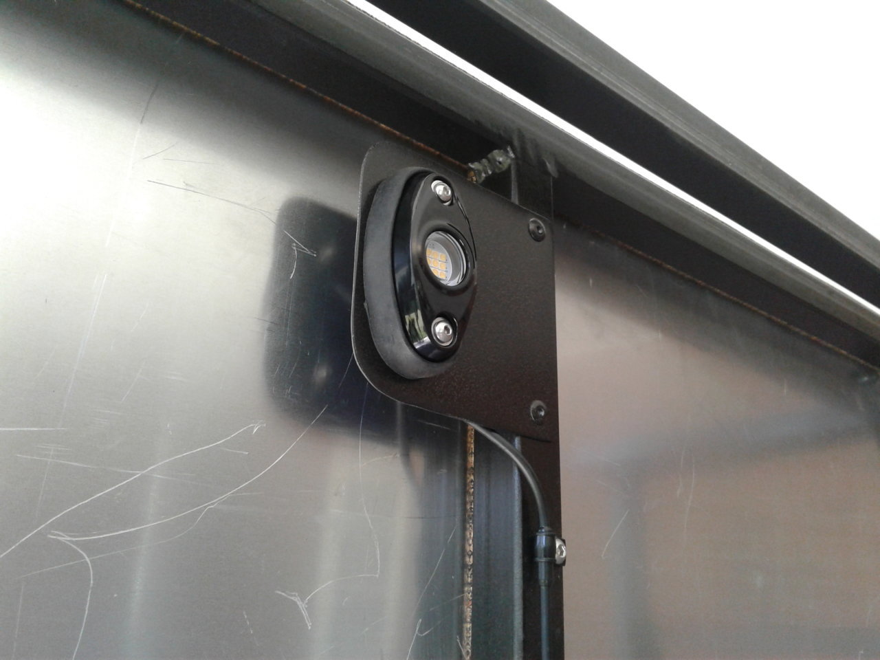

    So this was fun. I found these porch lights and decided I needed something to turn on if I get to camp late. This will light up each side of the camper area so we can unload our gear.

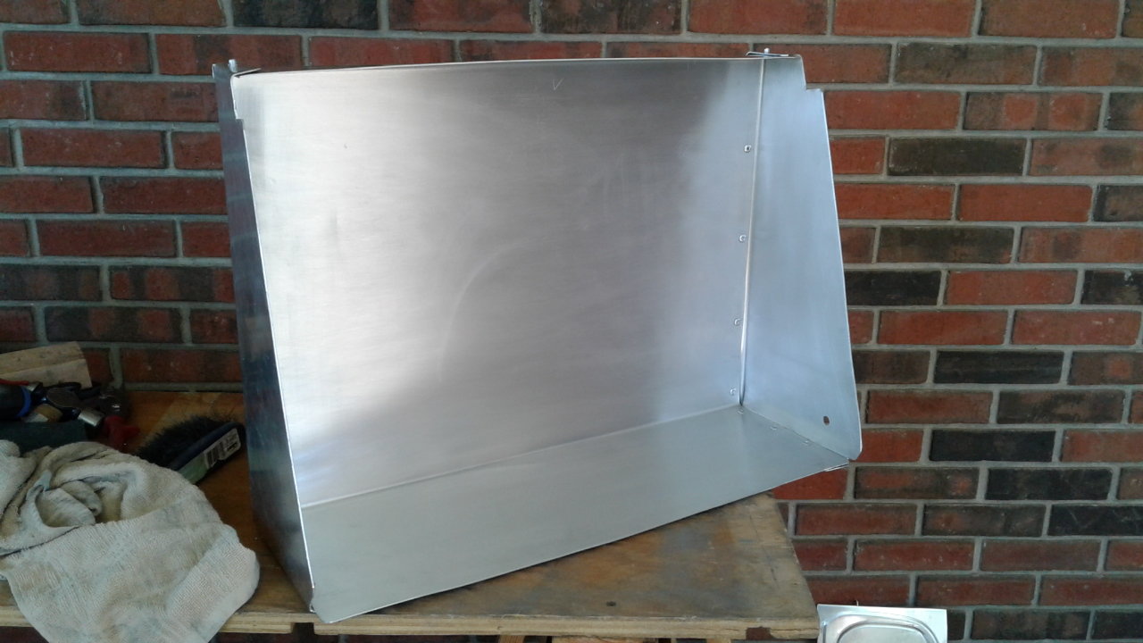

    Getting ready to build some aluminum panels for the driver side forward door. I'm going to have a electrical panel there with light switches and charging stations, etc. I had to make a sheetmetal brake first.

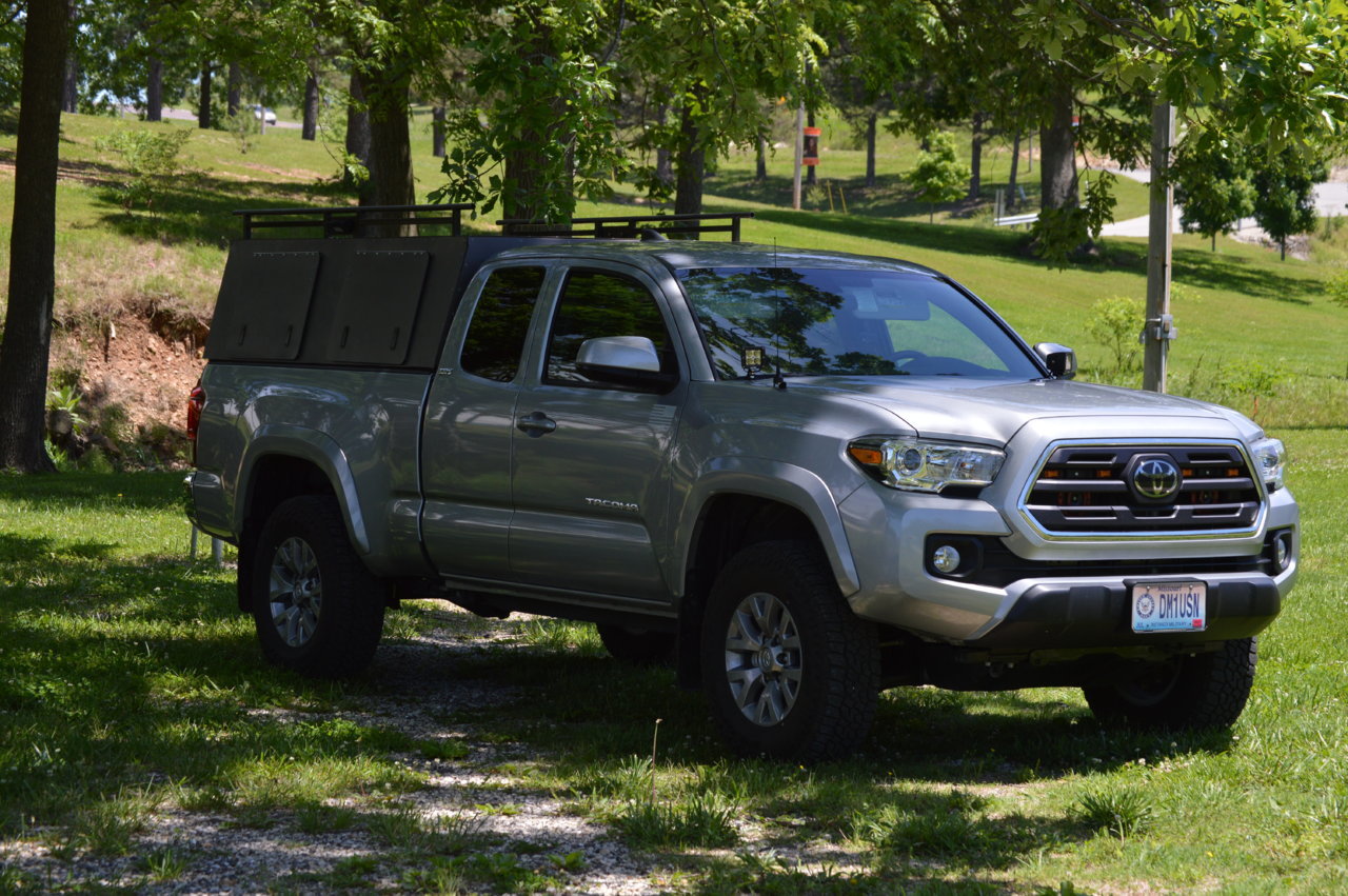

    Well almost finished. Paint done....have some small things to clean up, and make the rear door. It's been a ass dragger..Lol
    Zim

    Did a little sheet metal work to make a electrical panel in the first door, passenger side. Used the home made brake.

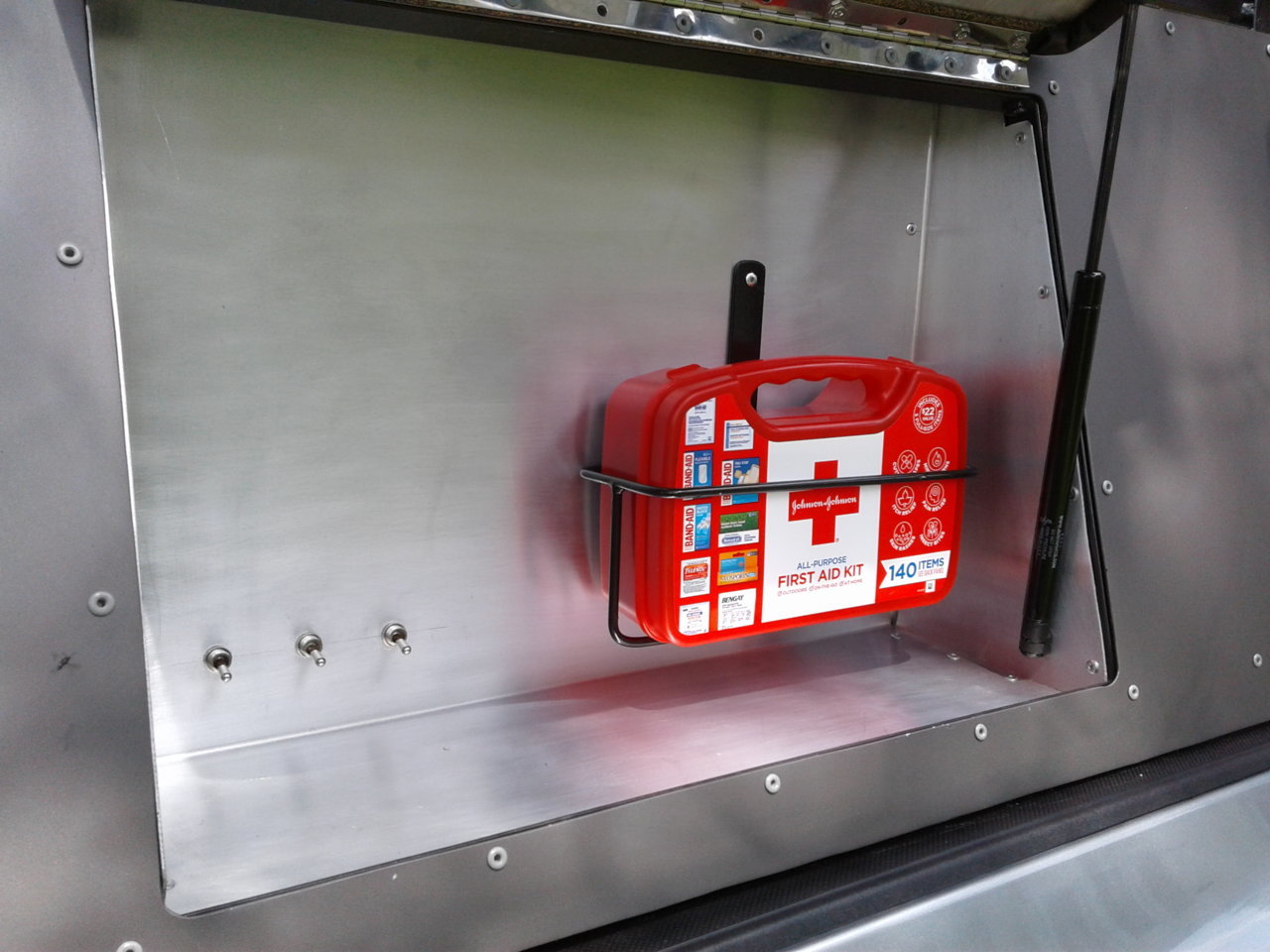

    No lie. I had this first aid kit out of the truck 5 times in 2 days on the first camp out...lmao. I built all this crap, and bleed more using it than building it. LOL.
    There will eventually be some charging stations here, and some other electronic crap as I get it.

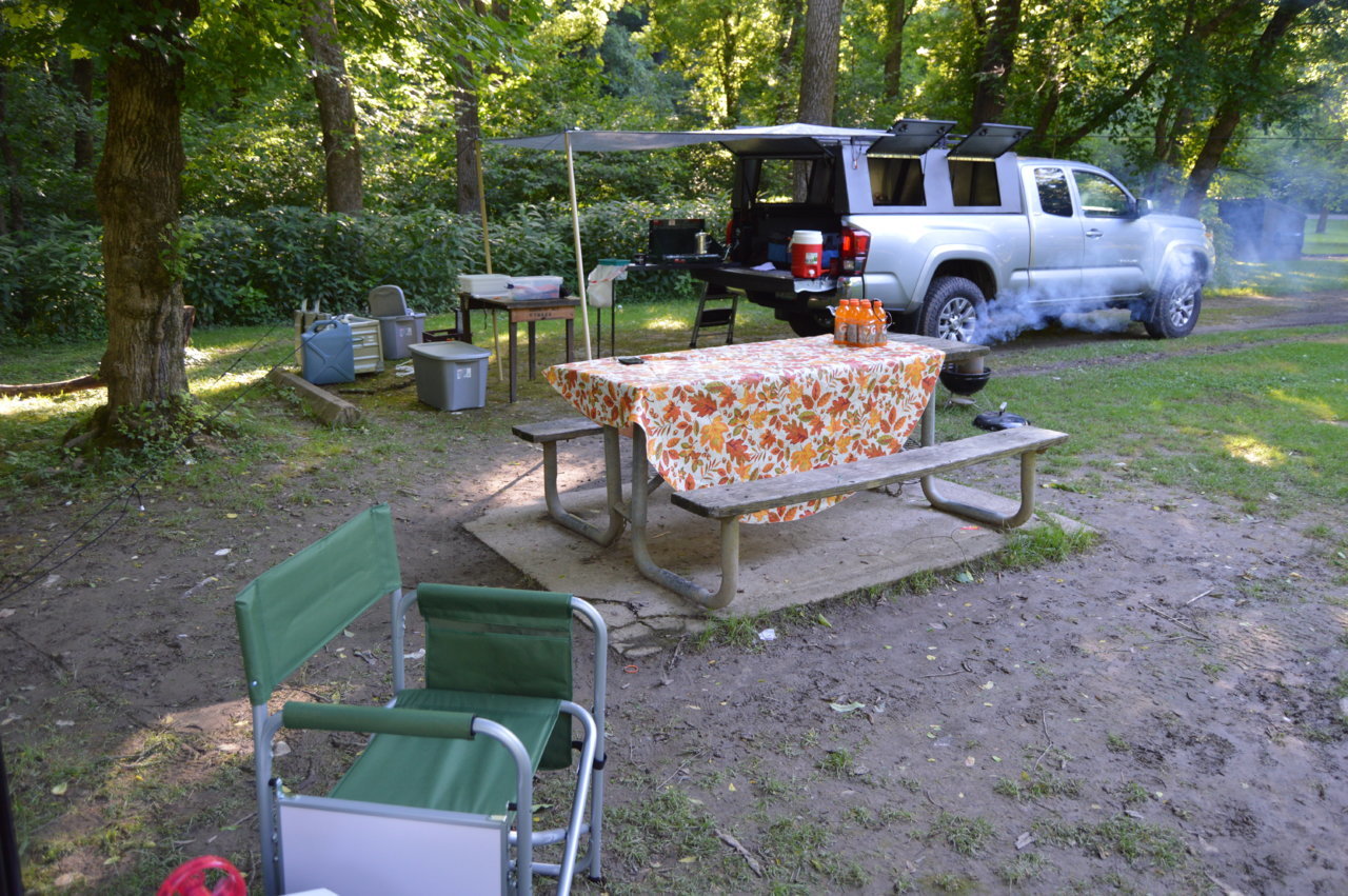

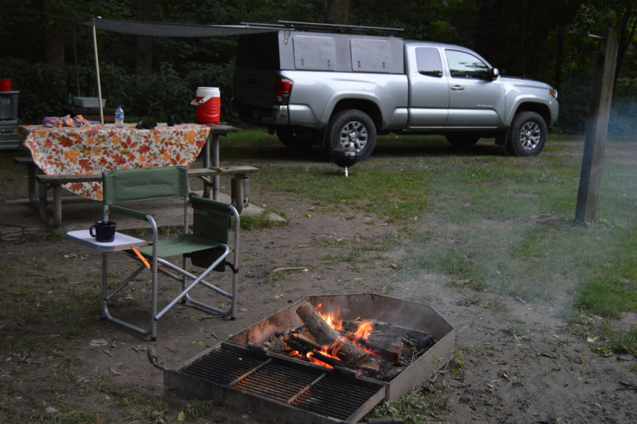

    First camp with this setup went great. Will make some changes, and head out maybe when it cools off.
    Zim
    This guy wanted something to eat.....he had some balls getting this close. Lol
    The lights are awesome. Had almost too much light.

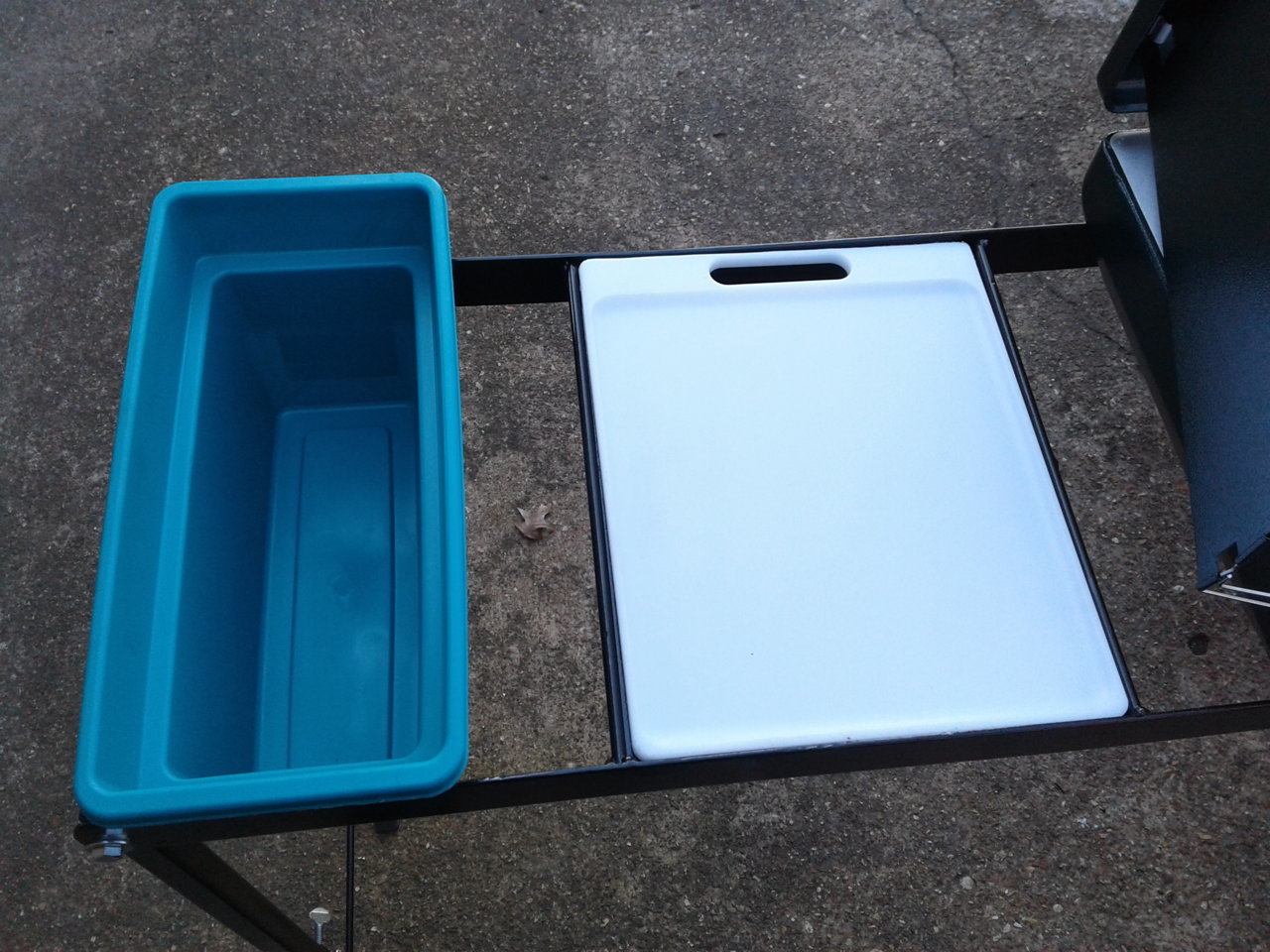

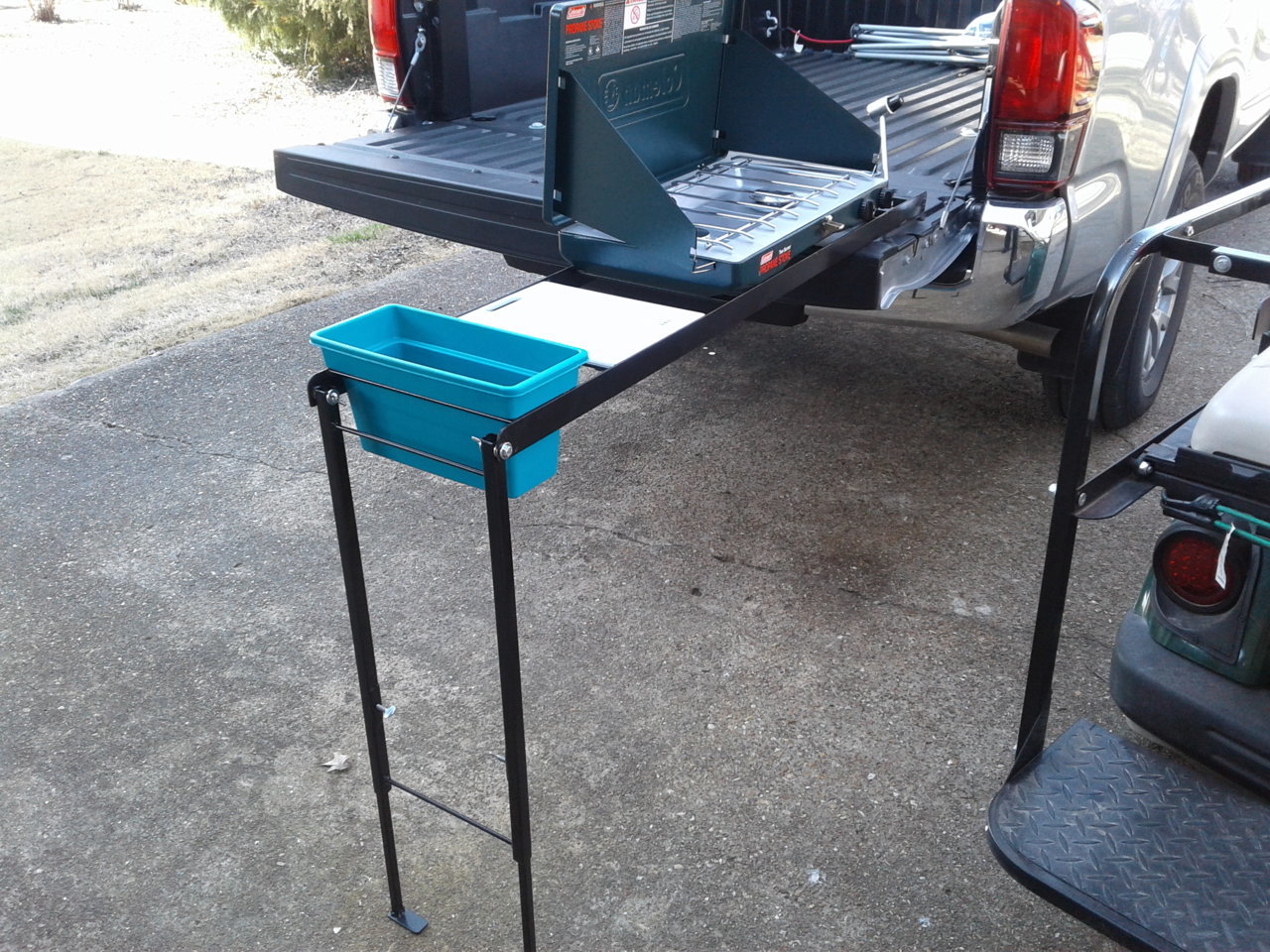

    Here is the kitchen I made. It can go on either side, I have 2 bolts coming up to mount to. Legs are adjustable, and it all folds up and into the truck.
    Zim
