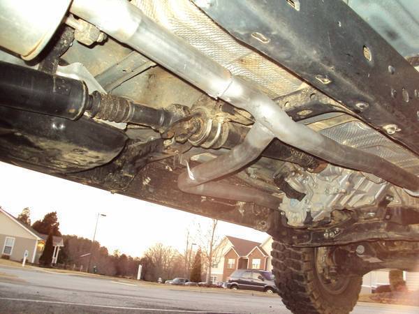

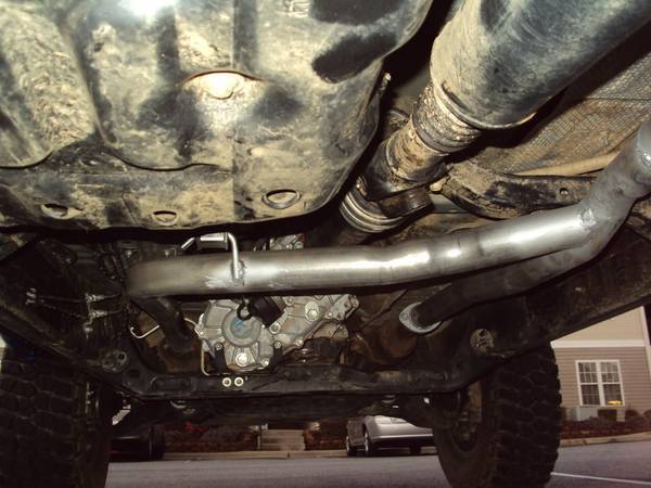

    It is very much above the frame. Here's an angle that shows it better:
    Probably a good 14 inches of clearance off the back of the transfer case.

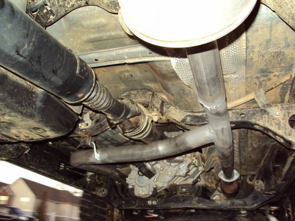

    A few bolts are different.
    Hows the flow? is that connection more of a "Y" than a "T", Hope its more "Y", just cant tell from the pics.

    It's Y, and the flow is fine. Stock pipe is 1.75, was replaced with 2.25. Exhaust note is almost identical. Also dumped it over the axle while we were at it.

    It's tucked up about 2" above the bottom of the frame rail at the lowest point. I ain't worried.

    Yeah, if you look at this pic, you can see that the crosspipe is hung off the front of the carrier bearing crossmember on driver side, and connects to the Y junction behind the same crossmember, which is a good 3 or 4 inch backward slant.
    It's very Y, the angles just don't show it. It's hard as fuck to take a good picture of exhaust, especially after rain :p
    Could've gone a little more Y, but that would've left less clearance behind the t-case and put a sharper bend (and possibly more restriction) before the crosspipe, so it's like where do you want your disadvantage to be?
