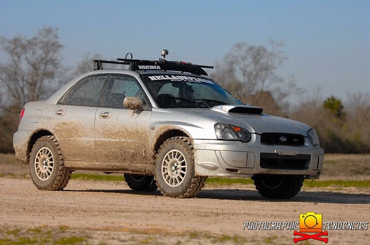

    I can't wait to get the Subaru and take it on Fort Fisher in the sand. i saw one the other day that had BFG All Terrains on it,lol

    Ahh tis true! Haha hey bet you won't put MTs on it like a real man :D

    It would defeat my mission of getting something with mpg above 30 but it sure does look badass

    Just sayin... Bet you won't do it
