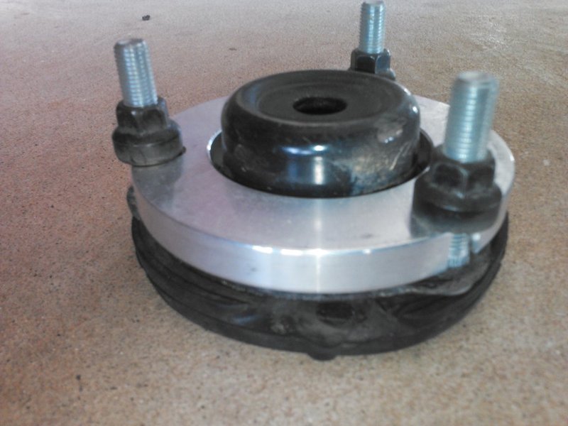

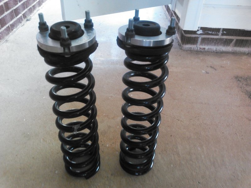

    I cranked my billies to 2.5 and hated the ride . Like a pogo stick . I switched to 885x and a 10 mm spacer and ride was much better.. but yielded too much lift so two weeks later took it out to have a rake back than level.. long story short I have 885x and top plate spacer including longer top plate bolts for sale uploadfromtaptalk1439935687219.jpguploadfromtaptalk1439935712005.jpg

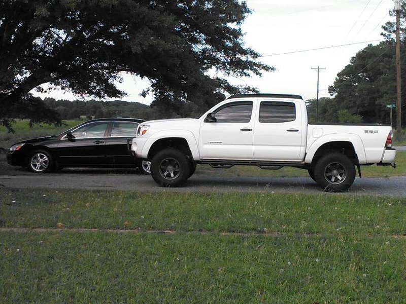

    uploadfromtaptalk1439936420591.jpg what my truck looked like with that set up

    How much lift did you get out of them? @Sctacoma4x4

    Amazingly 4.5inches but I'm 2wd .. and found out I'm lighter than 4wd..which is why so much lift.. my measurements were.. 25" from hub to fender on all four corners.. I didn't measure before but using stock measurements I used were 20.5 front hub to fender

    Wow really? Is it supposed to settle any? I'm also 2wd.

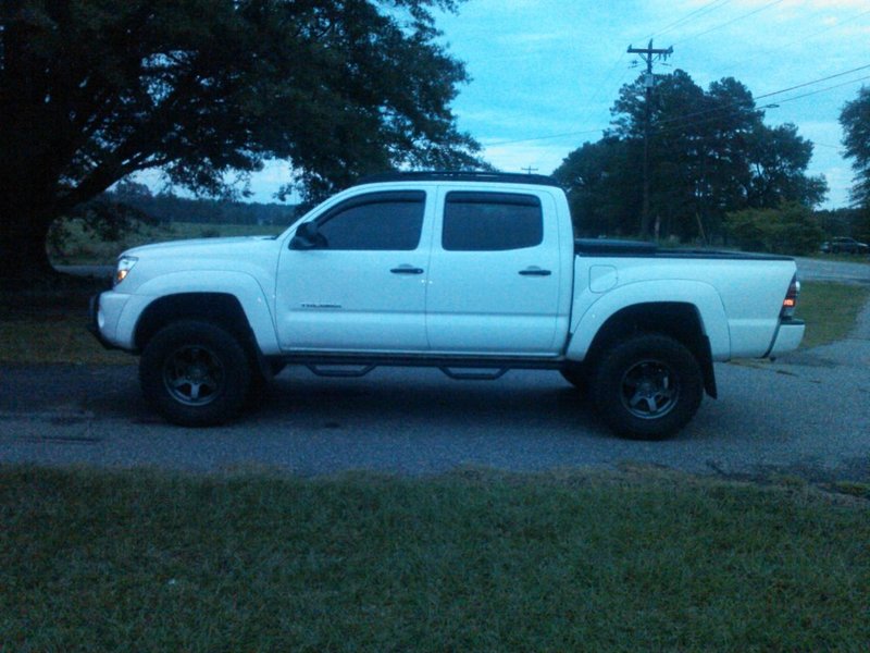

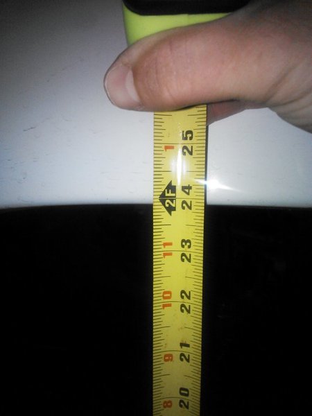

    With 885x I have 24"hub to fender this is how she sitsuploadfromtaptalk1439943839752.jpguploadfromtaptalk1439943854571.jpg

    You have 885x's with billies at 0? What's in the rear?

    Looks good! I'll let you know about the 887s. Don't really want to run that much in the front. Wanted to keep it around 6-7"

    Thats 885x with nitro shocks.. and full Dakars pack in rear
