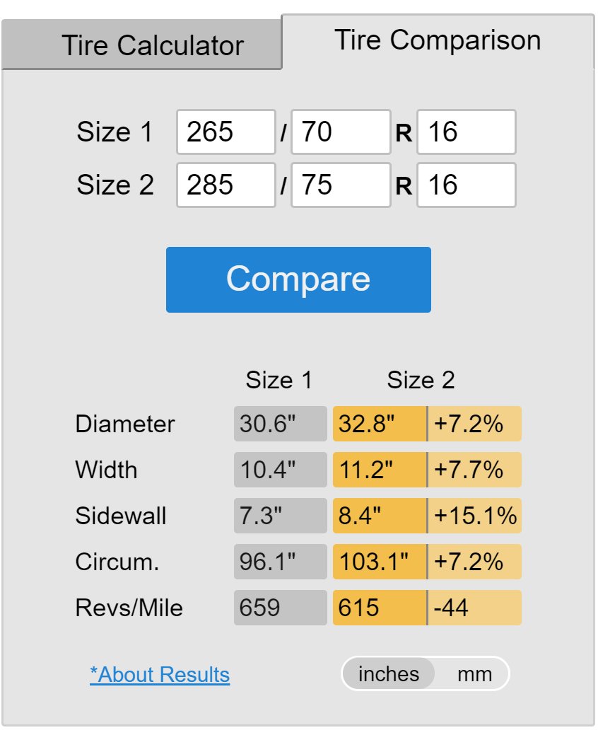

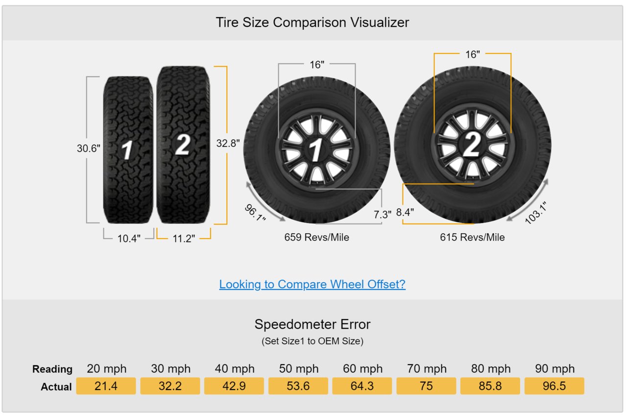

    I would think the bottom back area of that flare would have to come off like the mud flap.
    From what I read, on here, on the 3rd gen, you have to heat and reform the fender liner and remove the front mud flaps.
    The 255/85 is 2.2" taller or basically 1.1" closer to the flap/flare. Width is +1" as well.

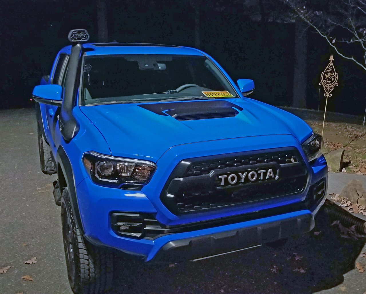

    Hey, did you see my new truck?

    Love seeing you post pics for your truck

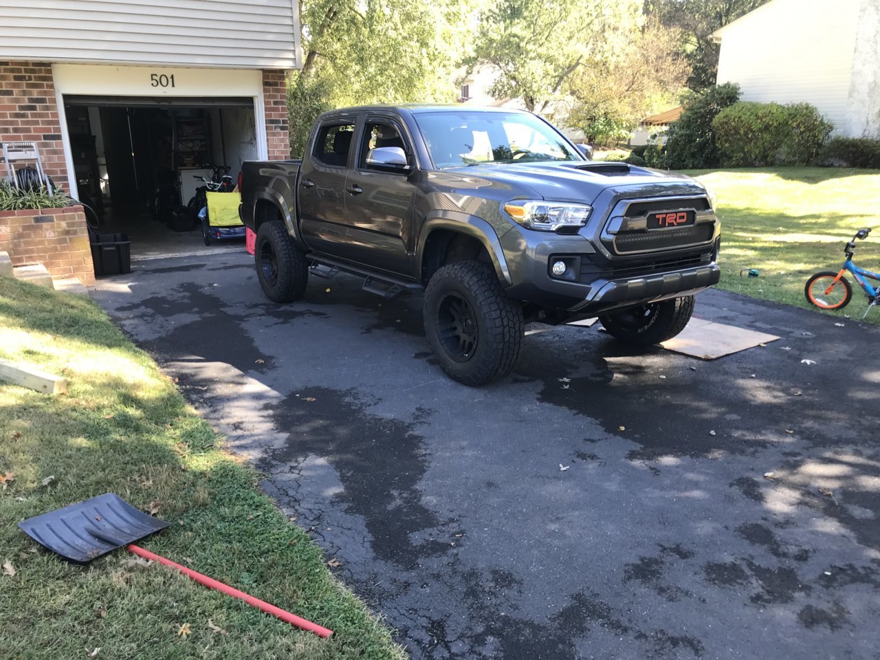

    I just installed 285s with OME 886s and I didn’t cut anything. D9D0CA21-2CF9-4792-B332-356F6F59D7BF.jpg

    Also, new truck :drool:...but too nice for me. Nice and shiny isn't a part of my lifestyle at this point.

    Hey you deserve that truck! And it has that awesome blue.

    your front tire looks a little camber in the photo
