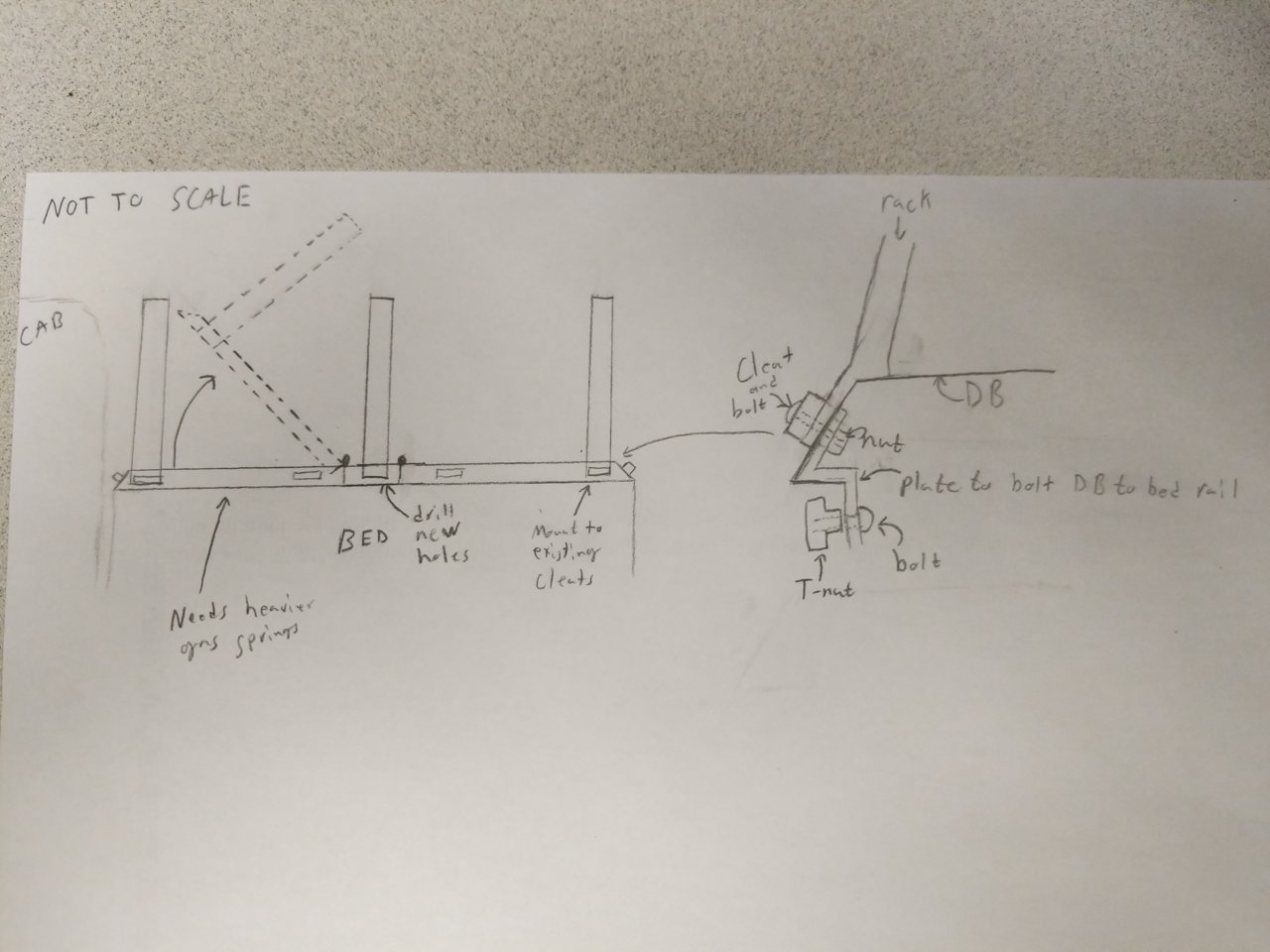

    Ok, if y'all are willing to give it a thought first, here is my idea.
    I want to have a bed rack that mounts on top of a diamondback cover, but at the same time allow it to still open from either end. Also, to possibly allow for the UpTop Overland Alpha eX to mount on top.
    I know this would probably require a lot of moving parts, so maybe a no go, or I'll just have to remove the UpTop rack every time I plan on opening it. If anyone has thoughts on that, let me know.
  12. Jan 13, 2020 at 7:54 AM
    jpereira2
    jpereira2 Well-Known Member
    Dec 20, 2013
    #118928
    6,376
    Jason
    Massachusetts
    2013 double cab trd off road
    Bilstein 6112 4th notch Bilstein 5160 rear Camburg ball joint UCAs Old man emu dakar leafs 265/75R16 Cooper ST Maxx Crux stereo a/v interface UltraGauge ARE fiberglass cap Wet okole seat covers Retro fit source Led fog lights Superbrightled pods in rear bumper Superbrightled light bar in grill Rock blokz mud flaps SOS Rock Sliders RCI Skid Plates (to be painted and mounted)
    How is your diamond back split? Maybe two smaller racks or baskets. To use an uptop cut where the splits are and create custom hinges
  13. Jan 13, 2020 at 7:58 AM
    CttAznRanger
    CttAznRanger Crazy NE Asian with the Cali Lean (temporary)
    Dec 3, 2018
    #274702
    4,757
    Brandon
    Boston, MA
    2018 Tacoma TRD Sport
    I have the HD, so its split front/back. about 35" per panel and 6" for the center? I was thinking something along the lines of having one truss on the front most cleats, one in the center panel and one on the rear most cleats. Might be best to not even have a rack up top, as that would make things super complicated. Who knows.
  14. Jan 13, 2020 at 8:05 AM
    Nimble9
    Nimble9 visit squareonecreations.com Vendor
    Oct 20, 2015
    #167184
    11,173
    Lebanon, PA
    2006 4x4 DCSB
    enough to have fun
    I'd assume you'd want to remove the fixed points from the bottom, so that the front and back of the DB cover can be moved? I'd litterally design it with a few hinge points ot bolts to be removed in order to make that work. The fixed point would be in the center between the front and the back of the cover.

  15. Jan 13, 2020 at 8:10 AM
    CttAznRanger
    Dec 3, 2018
    #274702
    4,757
    Brandon
    Boston, MA
    I was thinking that the only fixed point would be in the center between the two panels, exactly as you said, and that the rack would only be attached to the DB on the ends. If that would cause too much strain on the DB cover latches, then making some sort of plate to bolt on to T-nuts on the inside isn't such a bad idea.

  16. Jan 13, 2020 at 8:18 AM
    Nimble9
    Oct 20, 2015
    #167184
    11,173
    Lebanon, PA
    2006 4x4 DCSB
    enough to have fun
    this is all possible. Matter of time and measurements.

  18. Jan 13, 2020 at 9:48 AM
    CttAznRanger
    Dec 3, 2018
    #274702
    4,757
    Brandon
    Boston, MA
    Something like this make sense?

  19. Jan 13, 2020 at 10:12 AM
    RobP62
    RobP62 NVR20LD
    Jun 4, 2017
    #220718
    41,519
    Rob
    Street, Md.
    TTC Member #0125
    Great sketch Brandon!

  20. Jan 13, 2020 at 10:14 AM
    CttAznRanger
    Dec 3, 2018
    #274702
    4,757
    Brandon
    Boston, MA
    Thank you, I try. I know I have doctor's handwriting so I tried to write a little slower. Hopefully its legible.
    @Nimble9 If you need more details, or have suggestions, let me know. I'll try to sketch it up.
