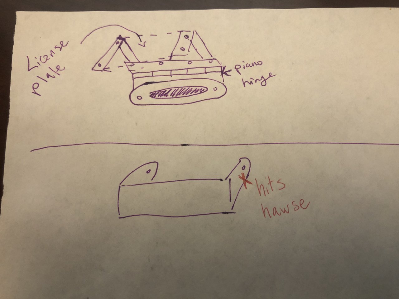

    I think he also needs the plate to be in front of the winch hawse, so it would need an extension or an L bracket

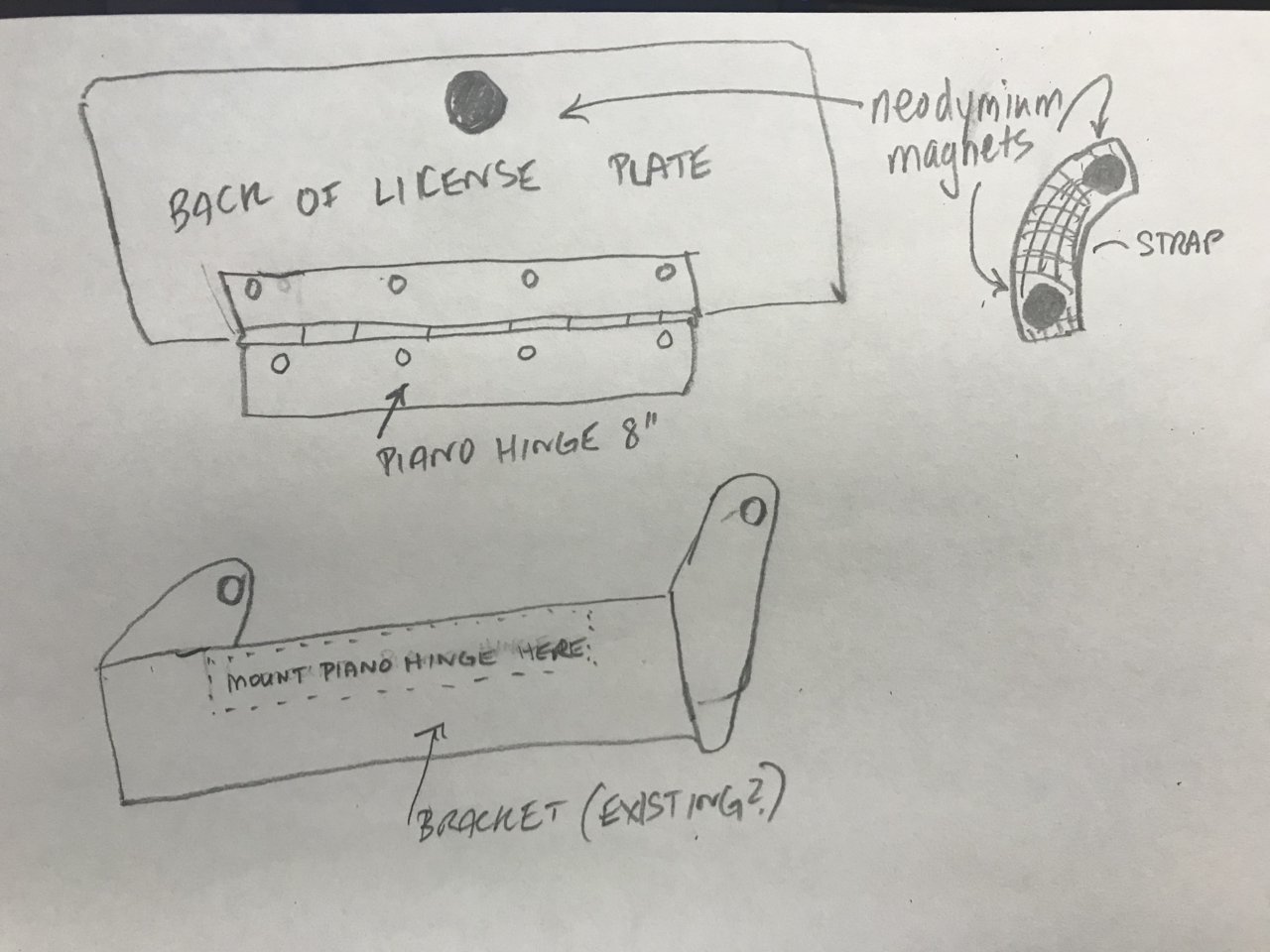

    I made a quick, rudimentary illustration of how I would make a bracket. I would use the existing bracket or make a new one if the existing one did not work well. A couple 90 degree bends in some 1/8" thick aluminum flat bar (1.5 inches wide) would probably do the trick. Then mount about an 8" stainless steel piano hinge to the bracket and add the license plate to the outside of the hinge. Mount a neodymium magnet to the back of the plate(3M double sided tape would do it), and then make a small strap that can run from the magnet on the plate to the metal(?) bumper and that would hold the plate up in times you were using it. You could also use velcro and loop it around an opening in the bumper above the plate. Either would work. A little time and materials and you should be able to get out for less than $30, depending on what you have lying around the house. 7138CC3B-020C-4A2A-B9D3-8BA8E77CF26A.jpg

    ohhh a double hinge. I think the one on the bottom was already hitting his hawse. Let me see if I can sketch up something similar to yours.

    Thanks for looking into it, and the blueprints!! :cheers:
    Although, I was thinking of easier simpler way just adding extensions made of some "L" channel and moving the pivot point about 1" - 1 1/2" forward. But that's only in case guy in my shop could weld it for me.

    Purple and Red are all I have at work..
    @Bastek

    You bet. I could fabricate one if I had your truck sitting in front of me but it will start to approach that $90 price tag if you are paying someone else for the labor. If you are handy then you can fabricate one pretty easy. Since I am not familiar with your skill level I will neither encourage or discourage your efforts. But you mentioned modifying the bracket already with welding so I am thinking you are quite capable of running with this with no problem.

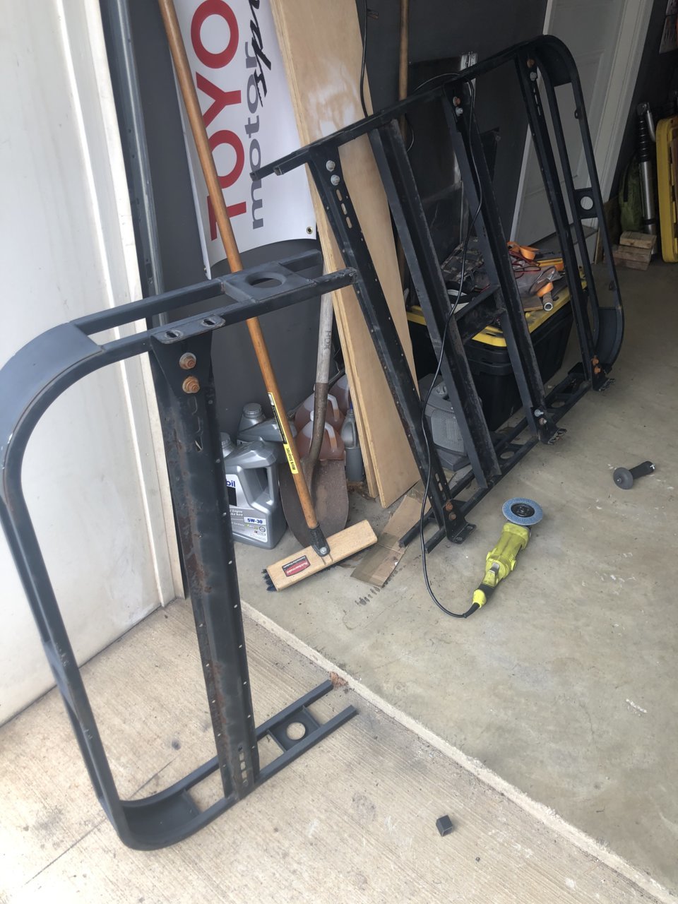

    man, Im modifying my friends rack. Extending it from 69" to 100" and moving a cross bar. I need to charge him more, even though its not that much welding.. we haven't discussed price.
    $90 for a little bracket?

    That would work also. Depending on how much clearance you needed you could run with half inch thick aluminum bar to mount on either side of the piano hinge. That would get you a very sturdy 1 inch of clearance between the hawse and the license plate as well as giving you a sturdy chunk of aluminum to drill and tap holes that would allow for securely mounting everything up. How much clearance do you need between the hawse and the plate to allow it to pivot out of the way?
    And I could be wrong, since it is hard to tell via picture only, but the original illustration I did took into account the original bracket only opening up enough to raise the plate away so that when the piano hinge was operated it allowed enough clearance for operation of the winch. The benefit being you would not need to start new and you would save a step or two in the fabrication process, assuming that would work.

    Also need to consider if he has a winch hook or something else in front of the hawse
