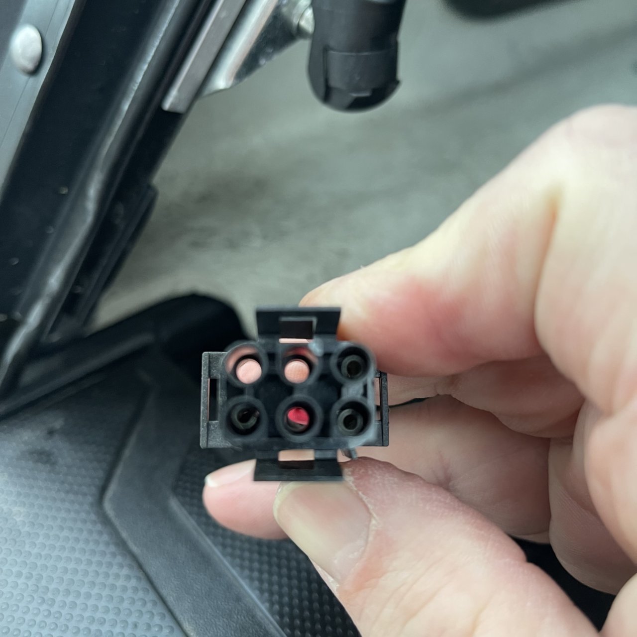

    Do you have a pic of it? Does the harness run into a box on the inside of the cap? This is a typical leer set up. A98D96A0-43B3-4014-84FA-CCD3821180AC.jpg

    that one is probably cap specific (century, leer, are, etc…)
    I ended up using just a generic flat four trailer connector from the auto parts store as my disconnect
    if you do some digging in the tonneau,caps,shells section there is a bunch of info. Don’t have any direct links at the moment

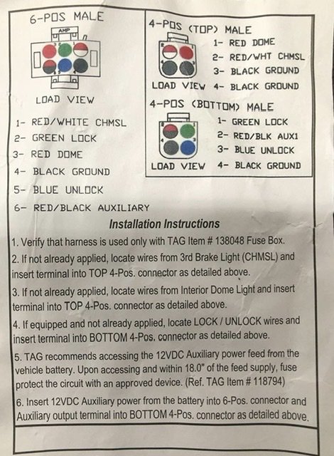

    Does the four pin look like the diagram in the right? If so, that’s likely the connector that goes into the fuse box for the cap. 277DAD87-474E-4BF0-8030-3AD5D3E0C8EE.jpg

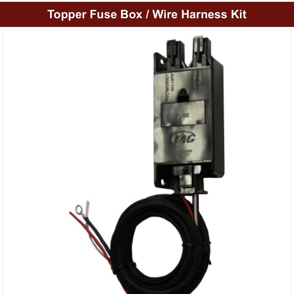

    This is the fuse box I referenced before - do you have something g similar? Typically they are mounted on the driver’s side vertically by the back window. 743319FA-41B5-4D13-AD82-010CB0455CB7.jpg

    i don’t see any fuse boxes. I’ll have to look some more.

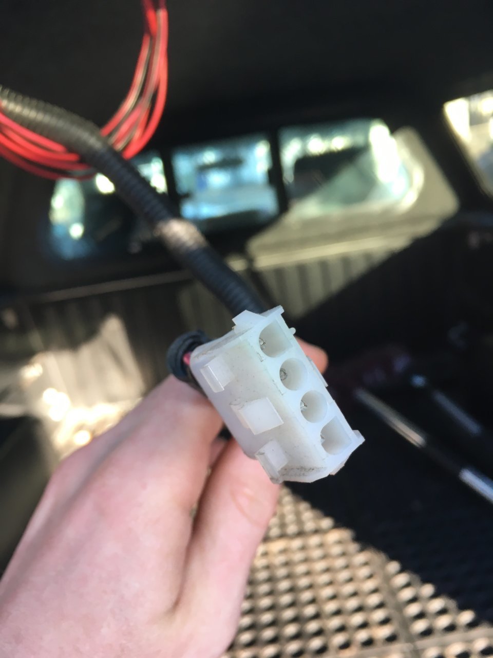

    here is the harness that attached to the cap.
    Really don’t want to cut into brake lights if I don’t have to.

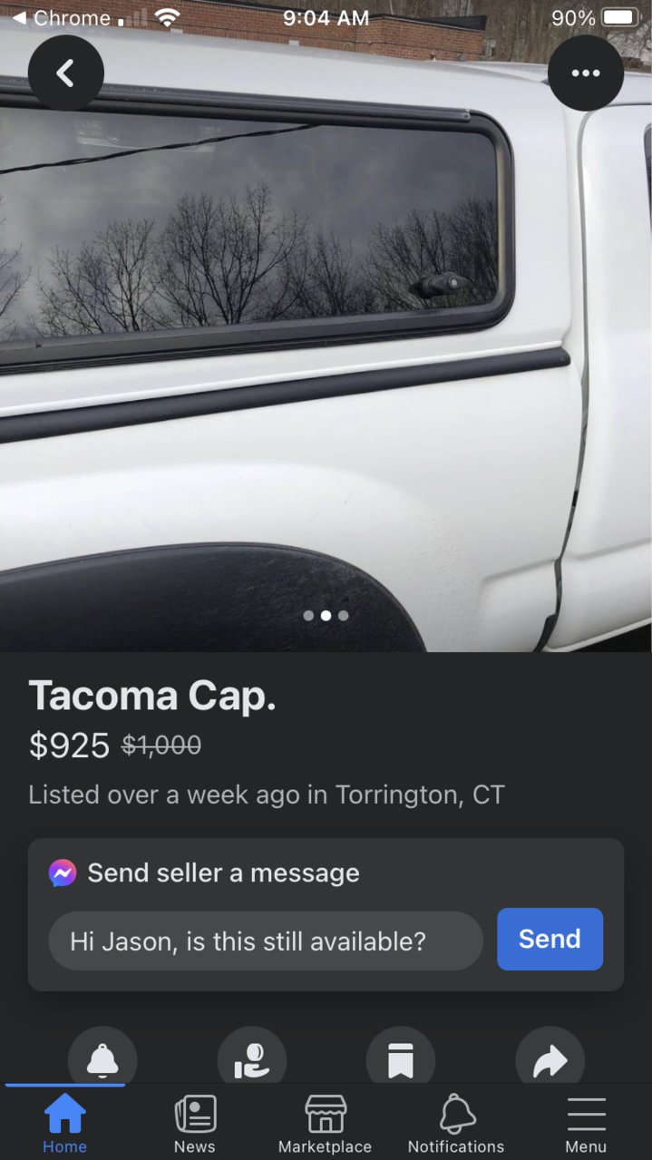

    Might be further then you want to drive -
    6ft White ARE Cap - Windoors - $925

    I was gonna say I didn't think such a thing ever existed and maybe check out Subaru for that but, damn. Nice.

    Oh dannnngggggg. Can you tell if that's for a DC? Looks like the same contour as mine at the front so this might be a winner

    I'm 99.999% sure the lines are the same for AC & DCs

    They are

    Looks like it’s on Access cab, But as others have mentioned the AC And DClb caps are the same.

    Access and DCLB are the same. The old Reg cabs used to be different.
